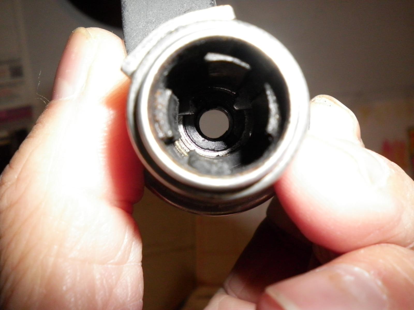

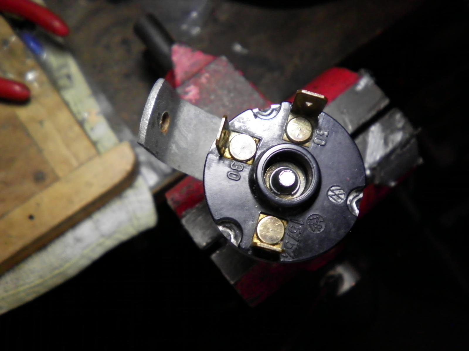

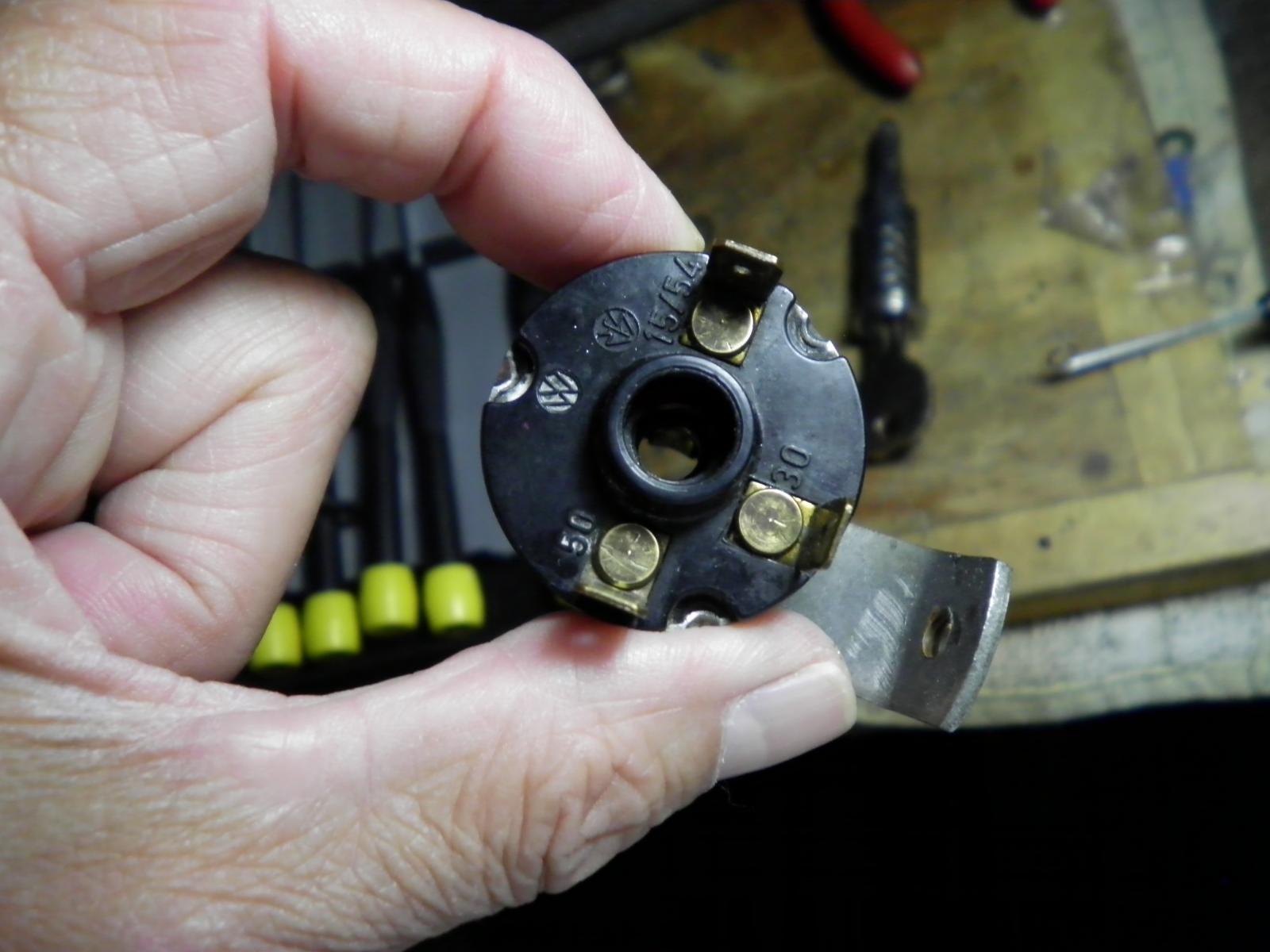

When I purchased my bug it had an aftermarket ignition in it so I bought a cheap vw ignition to have the key basically. After putting the vw ign. in , it crapped out and started smoking after about a month. So I took both the vw ign. key and the ign. that was in my car when I bought and switched around . I don't have photos of how I did it but the swap is fairly simple to do. I ended up buying some new ignitions from rock auto.(link below) At the time they were only 12 dollars each so I bought a couple just to have. If I remember correctly there is a little ring that comes off the end where the wires hook up in the middle.(this was probably 5 years ago) There may have been a snap ring too. I found a photo in my gallery here
In the photo I used that triangle file to make a new key after tracing with a sharpie.
I still have the original vw ign. somewhere that started smoking. I put the aftermarket key set in it and thru it in a box somewhere. If I can find it I'll take back apart and include some photos.

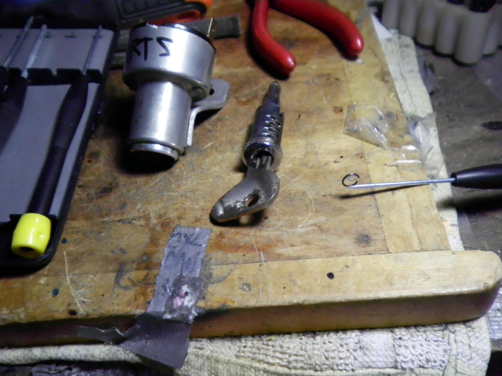

Edit... So I found the old switch & it took about 5 minutes to take apart. Turns out the only thing holding is the little ring clamp . You'll need a small screwdriver to disassemble. Once the ring is out the key and the guts fell right out. The rest is self explainable.

One more edit... There is also a washer under the ring clip that holds the key set in. You don't want to lose that. The ring is difficult to get started back in so I used an old piece of clear hose that was hardened. Then used a dremel to make it a little bigger. Photos of what a new one looks like , same as the old...
