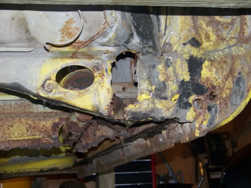

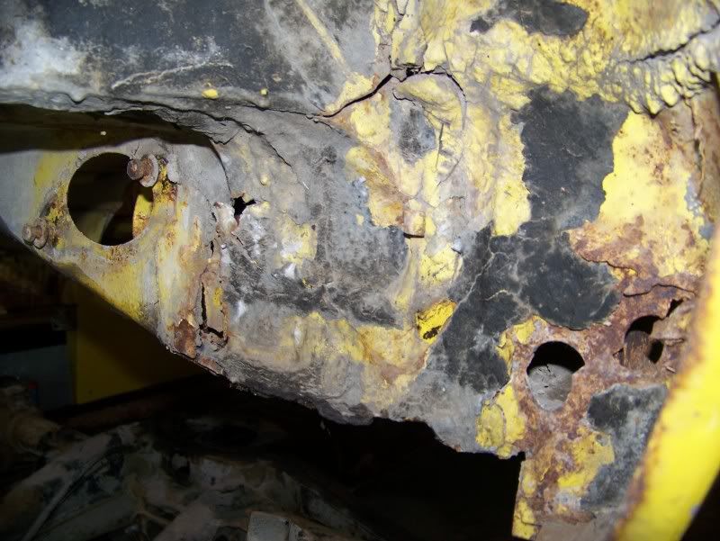

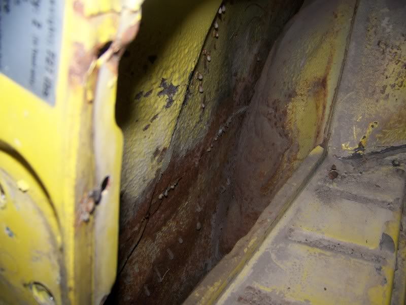

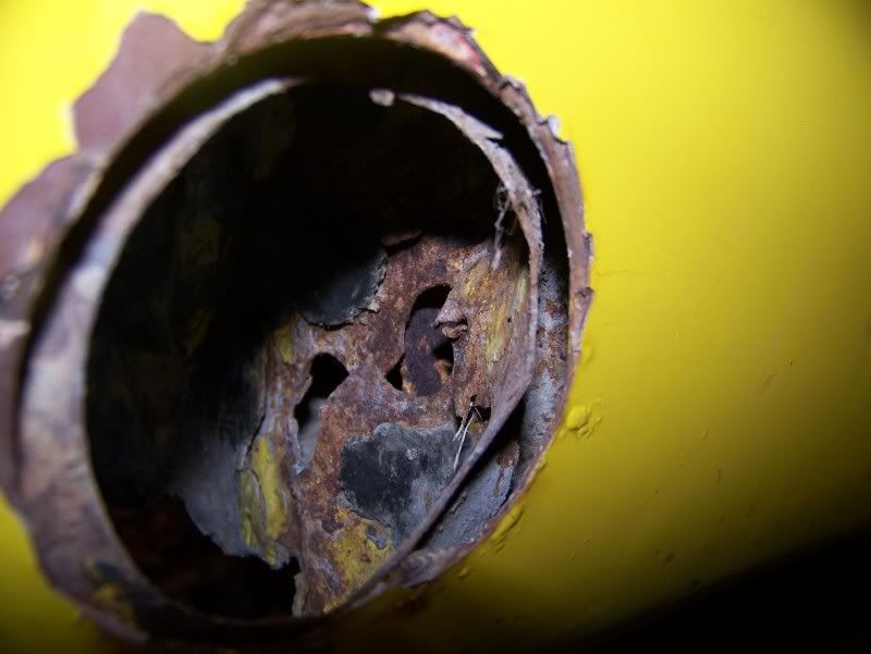

Ok, im getting more and more depressed with all the new suprises that the ghia is putting forward. First glance the body is good. Now I am seeing more and more damage. My dad evidently hit a post and that did alot of damage that was not seen at the time. Here are some pics and the aftermath that it has caused over the last 38 years.
please tell me i can fix this. I am replacing the quarter but that will not cover all the damage. The side seems a little twisted based on the pics. I cant see any twist but the pics dont lie.

I'd love to see more pics, more of an overall shot. Then I could recommend a course of action.

Ok, and I hate to suggest it, but that fender, and the inner fender on that side need to be replaced.
That image there says it all.
http://www.type-14.com/body/BMGHIA.pdf
Download that, and in one of the last chapters it actually details quite well how to do it. The hardest part if finding good replacements. I've seen a few in the classifieds.
You'll never get that back to the right shape, and all those holes have compromised it's strength.

I figured I would have to replace the whole quarter. I wasnt planning on the inner but I see what you mean. Time to start looking for a doner. Anyone have one to put up?

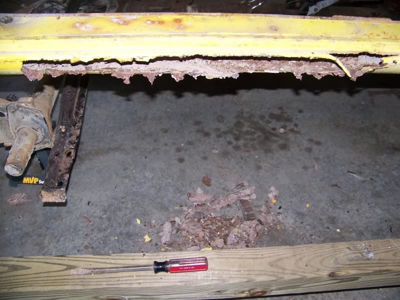

been a little sick, but Im going to try and start to sand blast the body this weekend and finish cutting the other floor pan out. I have been looking for a donor but its a little hard to find a good one with quarters intact. I should see decent progress this weekend as long as the weather holds up.

I wouldn't blast that thing I'd put it out of it's misery. You will always have rust in that car. Keep the good parts on it and put them on a better car. You will be throwing away money.

I wouldn't part it out. It's gonna cost more than It's worth to fix it yes. But, this car has emotional value to you and your family. I also have a 71 that was my dad's and has a 30 year history to my family. Fix it, and you'll be glad you did. If done properly, it won't rust anymore than it would have when it was new.

There has been much worse in this forum. I think its fixable.
I don't see why that inner fender needs replacement. It looks like surface rust to me in that photo.

The inner fender is pretty badly bent. Easier to replace then fix.

I'm not aware that new metal is available for either of those areas. The inner fender is sorta available, they sell 3/4s of it. The outer fender I think might have gone NLA a long time ago. However, find one on the west coast someone is parting, and see if they'll cut it for you. Ship it through greyhound and it won't cost a fortune. Get one that is as big and as complete as you can afford to have shipped. Better to have them cut too much then not enough. May be a little tough to find, and take a while, that fender is a 70 and 71 only part. Same as the rear bumper. But take your time. There's no hurry.
