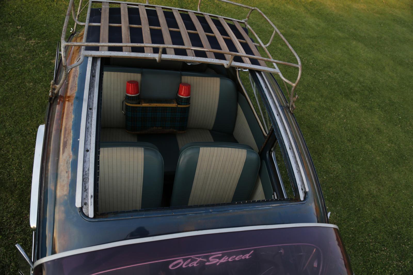

A few months ago I also bought a rack from the same place and called about this identical issue. They told me the same thing "never had this problem before".
After talking to a few others who have purchased this rack, it seems that this is a known problem with the AA manufactured knock down racks. The center bow is not make correctly and will not sit in the gutter like an original rack. No matter what you do its a poor fit and not worth the $159. What is sad is a guy down the street bought an EMPI rack and it fit better!
Its just another case of getting what you paid for and a shop selling crap

VeeDubDoug wrote:
I have never heard of a ragtop specific roof rack .
(borrowed from the gallery)
there is defiantly a difference in hard top and ragtop roof racks.
The ragtop's legs are longer
