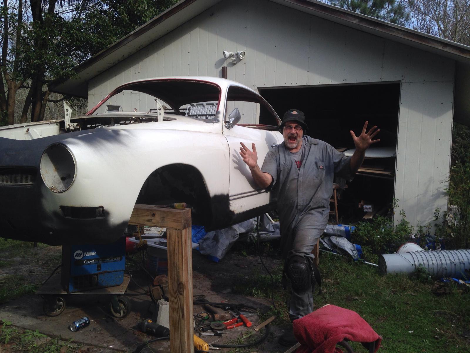

Thanks for your thoughts Jason. This is my first Vw renovation and I'm getting a crash course on the good the bad and money. I'm not trying to win any trophies or awards. I just want a cool Vw that is safe and a fun second car for us to have.
I have made a video that is a video diary of the car ( video needs to be shortened once finished) I only get to work on the car once every few weeks as it at a friends house who live 45 min away. So I just have to be patient.

Wink I will I hope to work on her again monday, I'm almost done with the welding body panels yeah ( i will miss the smell of the mig welder thoe ) Laughing
