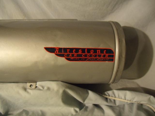

If it looks like this one, yea you can go into it and
change out the string, the cooling "pad", check out
the "squirrel cage" for rust, etc. You have to be
careful taking the back cover off so the screws
will tighten back so it doesn't leak. I used to fill
this one up about 1/2 way with crushed ice and
a lil water, and it would be COLD inside when
going down the road. Had to be careful turning
right because water if not drained down enough
would come out the vent into the cab.. Laughing
I used a strip of Dura Cool blue fibrous padding
for the cooling padding. Almost froze me out.

The one in the picture you posted looks to be a Firestone unit.
The Classic Aire looks like the old Thermador units as seen below.

I thought at first that mine was like the "square boxed"
style like a Firestone, but it isn't. It doesn't have the
beaded "lip" at the front of it. It has a large opening
in front with a screen and a lid that allows one to close
it via a small rod from inside the cab so one can adjust
the incoming air. The drum is spring loaded like the
others so one can draw the string to soak the padding
360 degrees. I too used the same blue fibrous padding.
Here's a little different pic of it. Not very good one
though.

By the way it hangs low like it does it might be an original KoolAir unit made by Thermador. These first version units hung low and blocked vision out of the passenger window.
1966 Euro
1600DP
Dual 34mm ICT's
99% Resto-Custom Daily Driver
bgs
Joined: May 08, 2005
Posts: 417
Location: SoCal
bgs is offline
PostPosted: Mon Mar 24, 2014 4:06 pm    Post subject: Reply with quote
You're probably right. It does sit low with the
vent/window ledge-mount siiting at the top.
It most closely resembles the Firestone cooler
of the early 50's made by Thermador as you
have pointed out. It' not exactly the same, but
pretty close.
