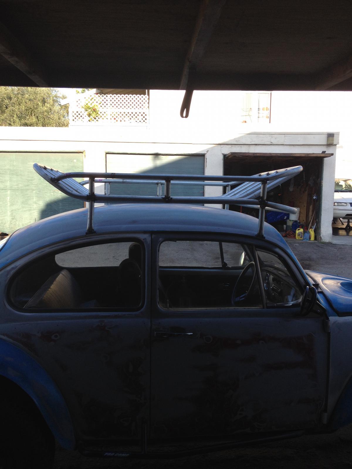

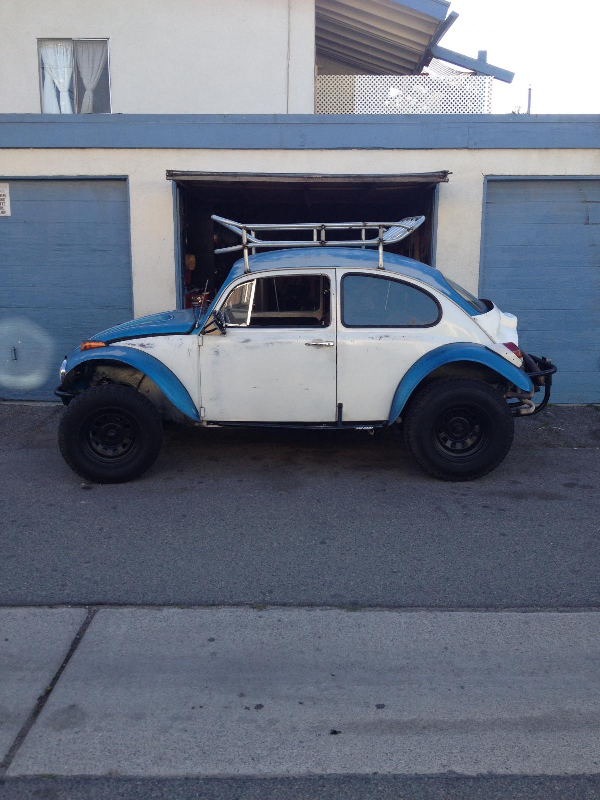

Just finished a roof rack for my son's Baja Bug.
I also built the front bumper and rear engine cage. I'll be posting in the classified section soon.

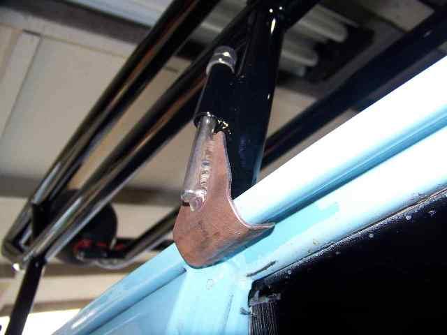

Nice! I've been thinking about making one with the same style of mounts! Do you have any pictures closer up to where it's mounted on the body? Did you make the actual clamps or buy them?

Hi. I copy this claps from This forums

Those pictures of the clamps are from my rack. There's more in My Gallery.

Sorry it took so long to reply. I was away for the weekend. I made my own clamps. They're like the ones jorge8amz posted.

Nice rack. Why did you decide to go with the upward slant at the front and rear?

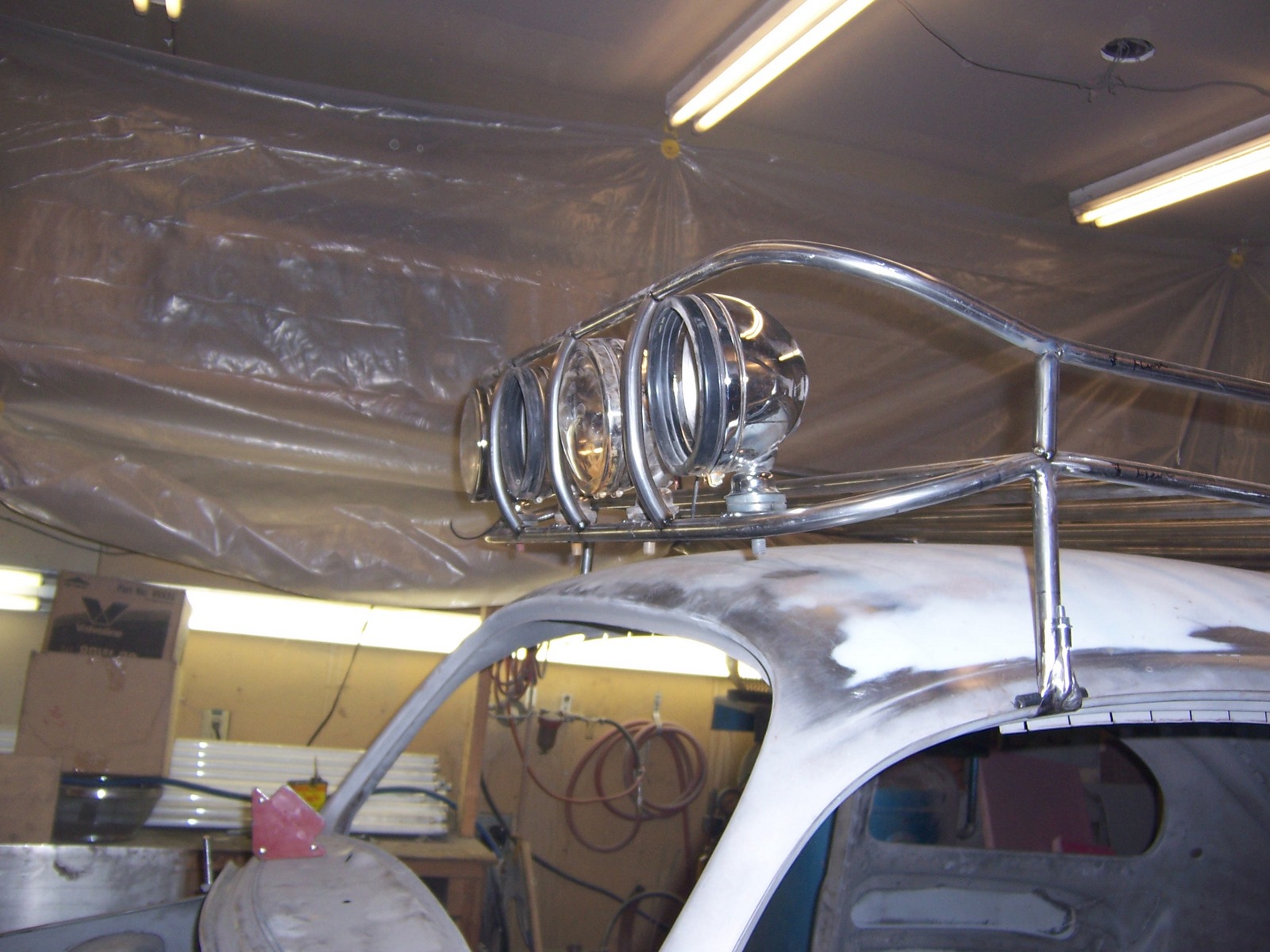

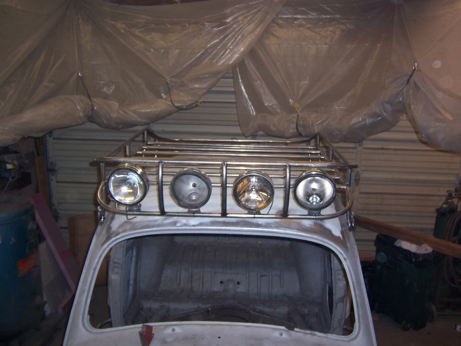

How are you guys running the wires to your headlights? Can someone post pictures on how those are ran?

here's the one i made, did the same idea on the mounting clips. I had to drill and tap a screw through my gutter rail though. i didn't put them at enough of an angle and they kept popping off.

Hey for the clamps that go into the rain gutters will that build up water and rust?
