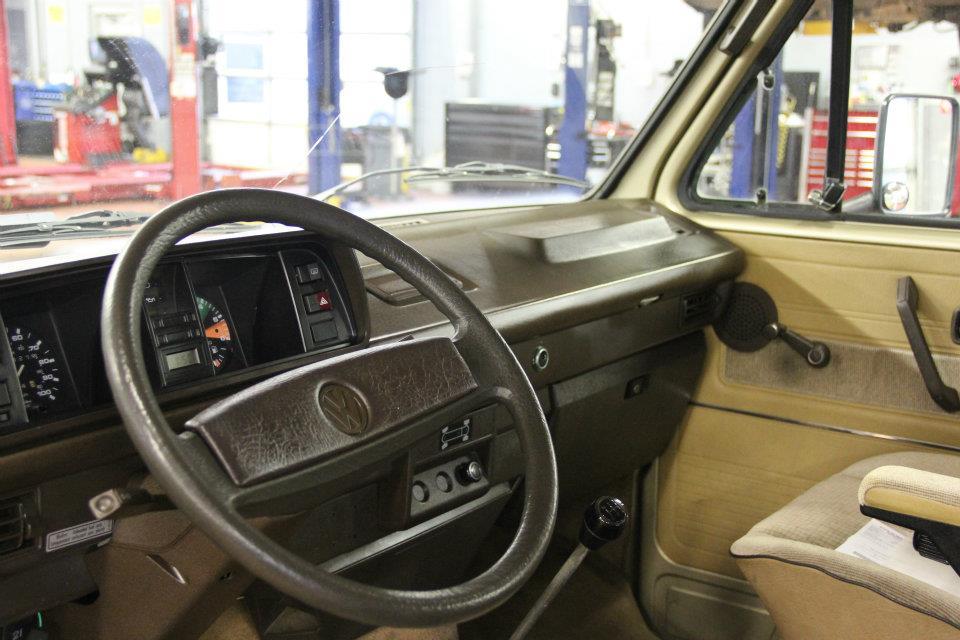

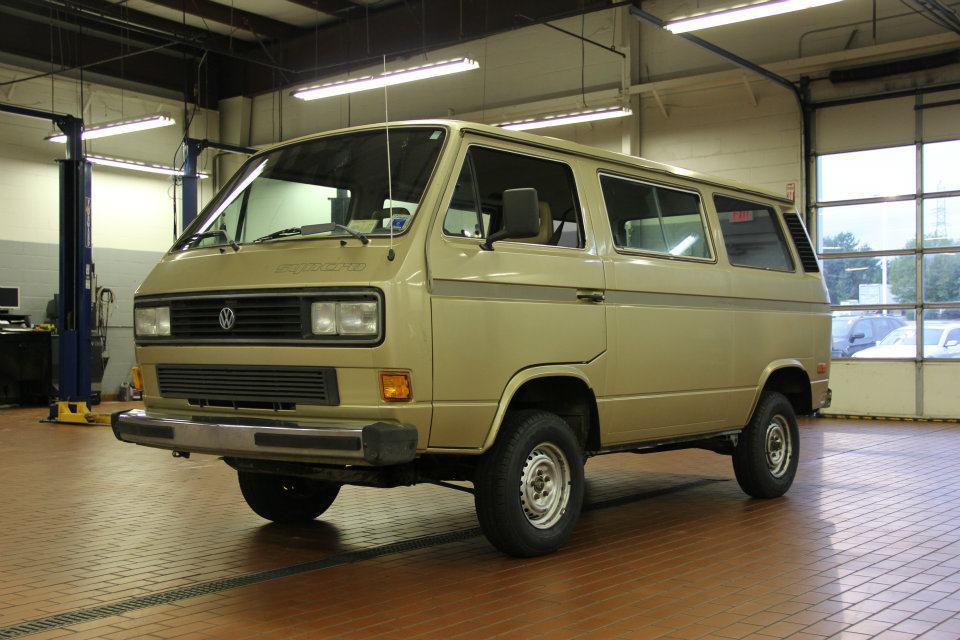

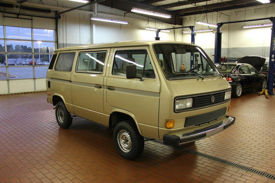

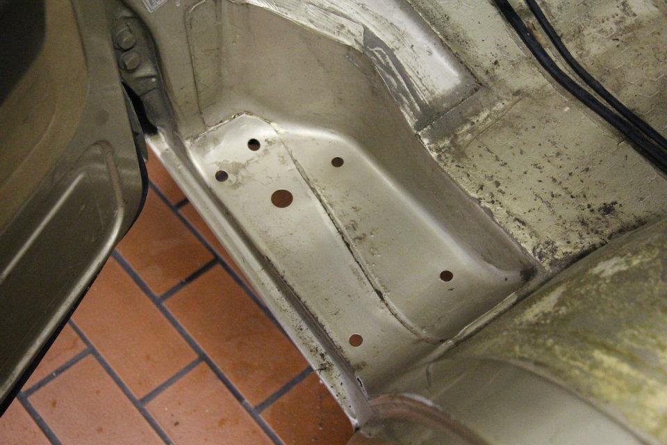

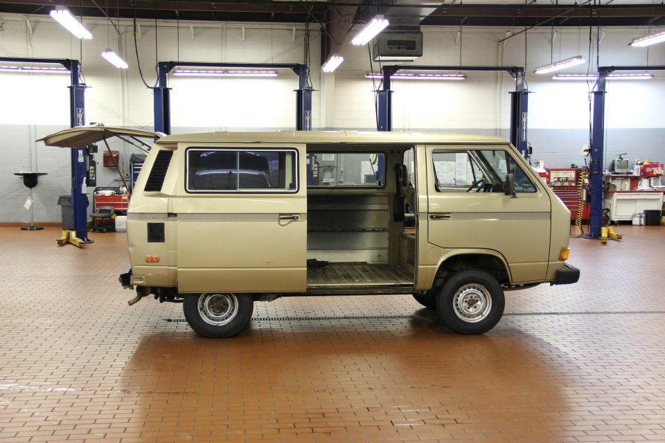

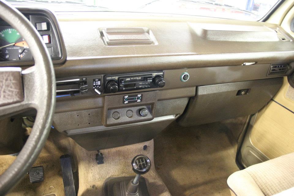

I am a long time lurker and infrequent poster. I wanted to share my ongoing build/resto for my ’87 Syncro tin top. I told myself, that if I was ever going to do another restoration, it would be the last one, and just for moi. I was originally going to do a split window, until I ran across the Syncro. Not knowing they even existed piqued my interest and satiated my desire for getting away from things. The idea is to build a clean and reliable (as can be) overlander with an eye for simplicity and detail. I started the hunt for a van and being on the east coast was limiting. I really lucked out though, in finding one around the corner. I have been in the auto industry for over 15 years and local import repair shop owner was ready to part with his. We negotiated a fair deal and I drove it away without any fuss. The van was a solid driver with minimal rust and a bare pallet, just what I was looking for. There are a few dings and the passenger side had been painted at some point, but the damage doesn’t seem to be too bad. The PO ran into a garage with roof racks installed and tweaked the drip rails in four spots, that seems to be the worst of it. The first phase will see a complete drive line, steering, fuel, brakes chassis detail and suspension overhaul. Essentially, I am redoing all of the vans naughty bits. I am a good bit into this build and will try to keep the updates flowing.

Looks like a great foundation. Nice shop too.Smile

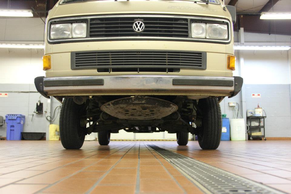

Looks good Hans, I will add that to the reading list. The floor is oddly enough tiles to mimic bricks.

PostPosted: Sat Apr 26, 2014 2:23 pm    Post subject: Reply with quote
The floor is Clinker Tile. BMW has in it's CORA requirement that the shop floor be Clinker Tile. The tile is not a faux Brick. It is the German answer to a tough shop floor that can be easily cleaned, not easily destroyed, and have some traction when wet, preventing workshop injuries. My guess is you work at a Dealer? Or that was a BMW Dealer shop? Oh and by the way, nice project. The van is sweet!

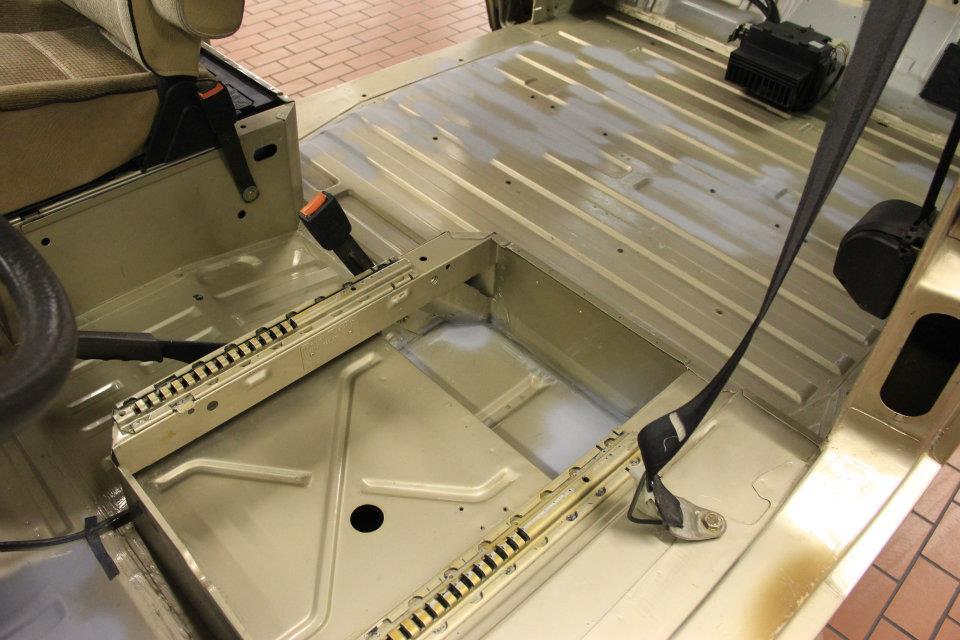

PostPosted: Mon Apr 28, 2014 10:27 am    Post subject: Reply with quote

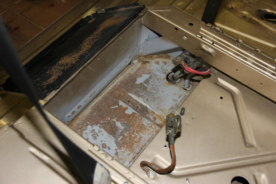

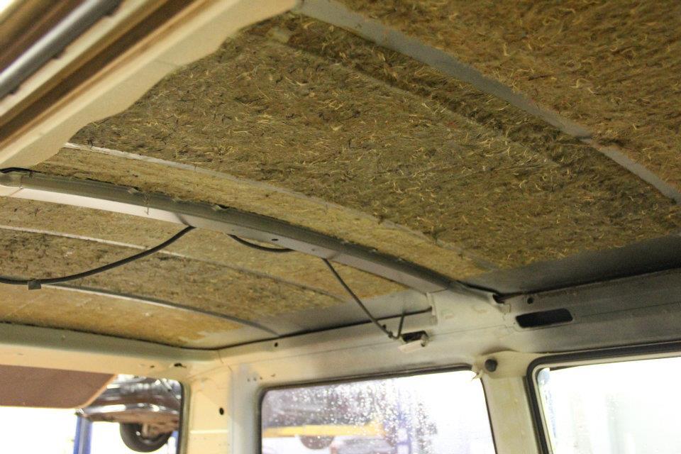

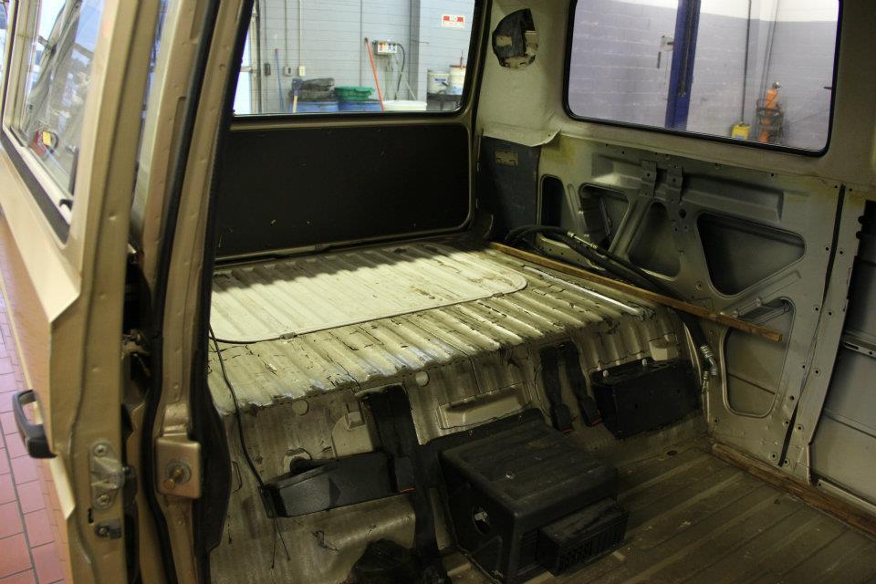

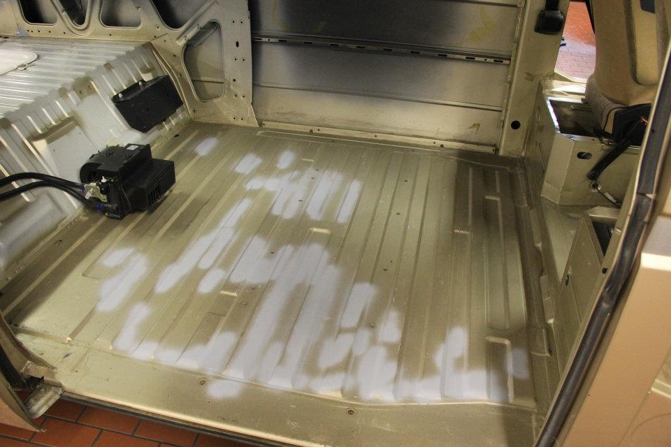

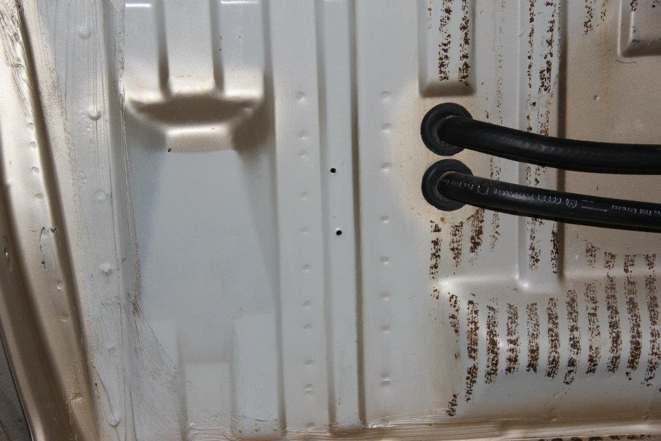

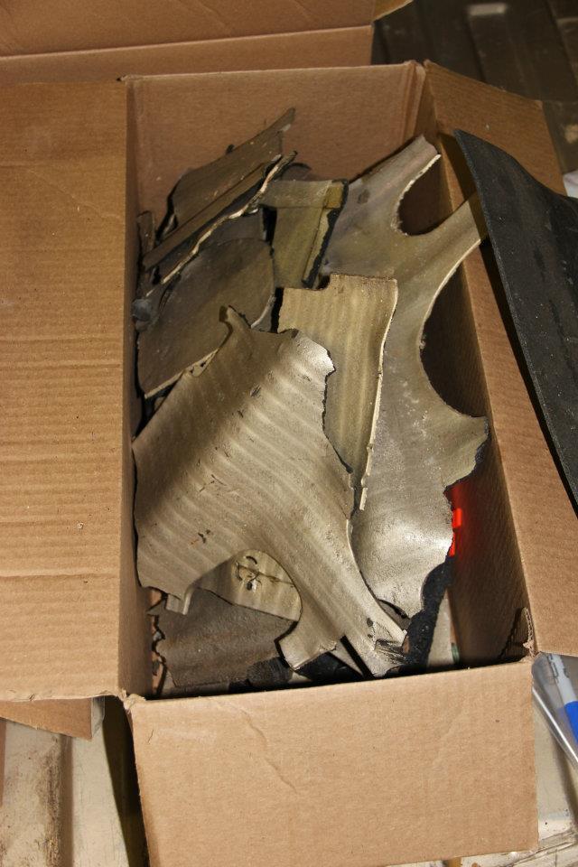

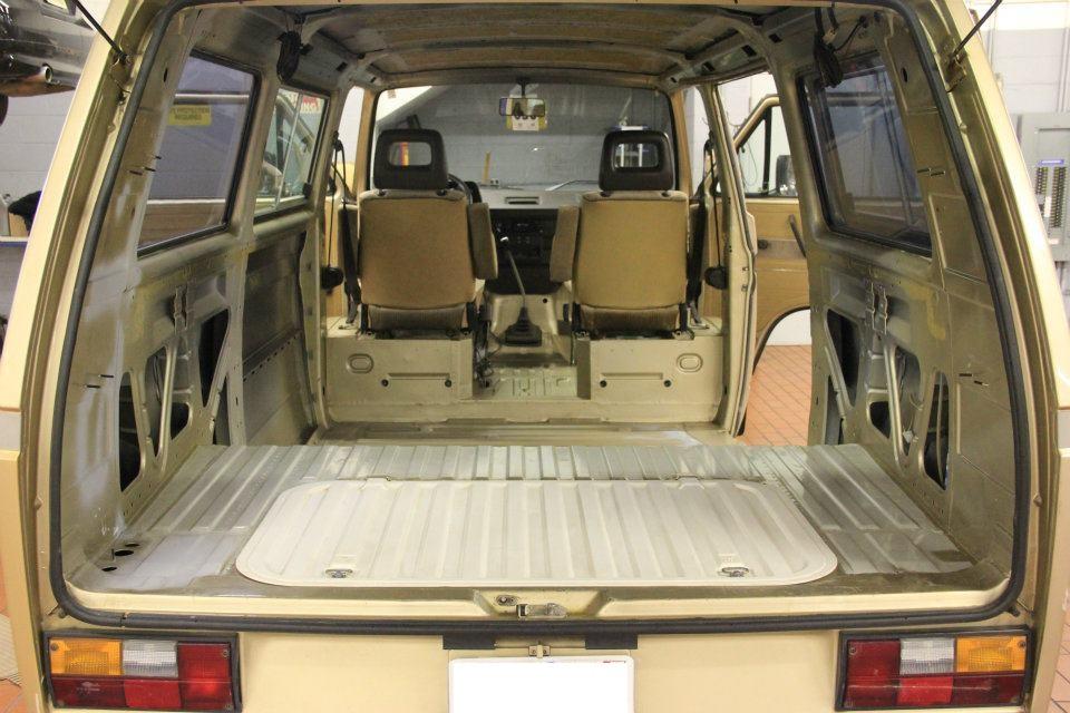

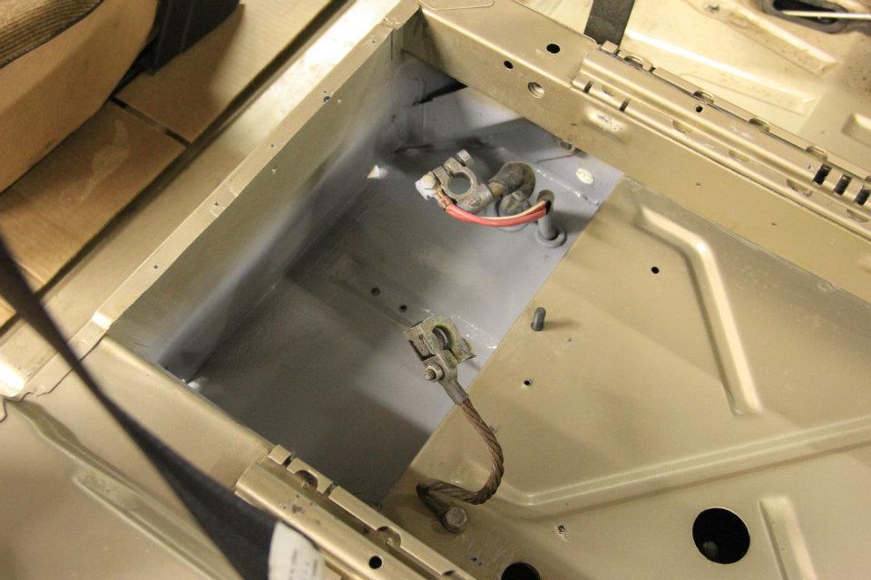

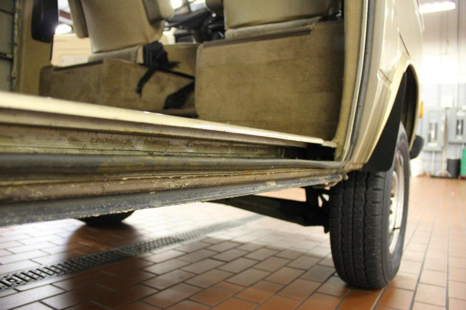

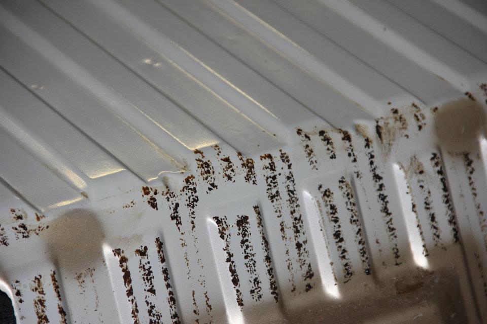

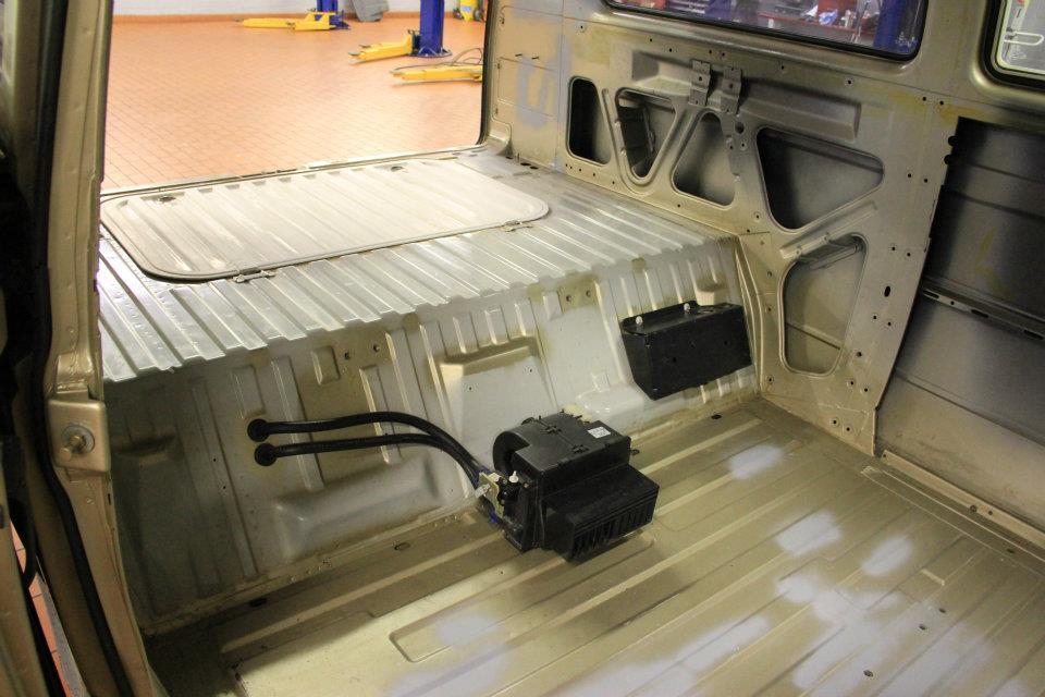

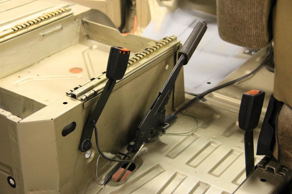

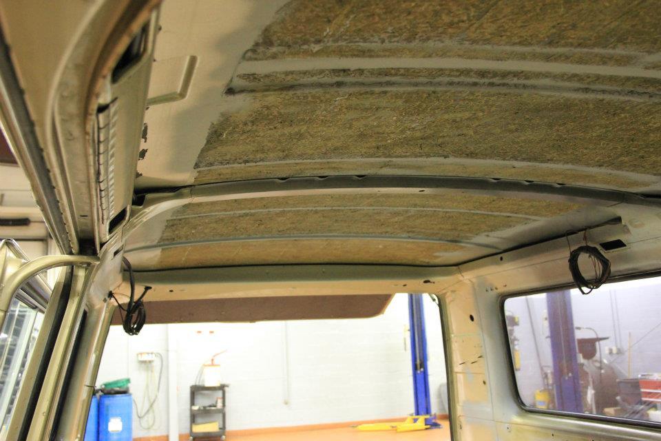

So before moving down to the underside of the van, I wanted to give the inside a good cleaning out. I removed the dingy carpet, headliner and the few remaining trim pieces. I also pulled out the glued down insulation on the rear deck lid and pillars. I used some Acrysol to clean up the left over adhesive and a flap disk on the degrading roof insulation. The remaining glue on the roof would have to be ground down to metal to completely remove; no amount of adhesive remover is going to touch that. The battery compartment had a bit of surface rust, so I cleaned it up and hit it with a bit of etching primer for the time being.

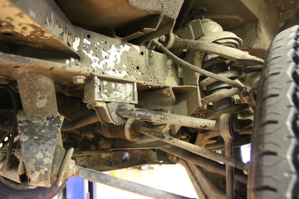

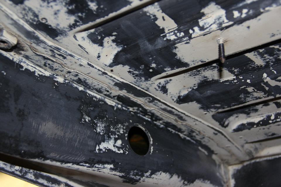

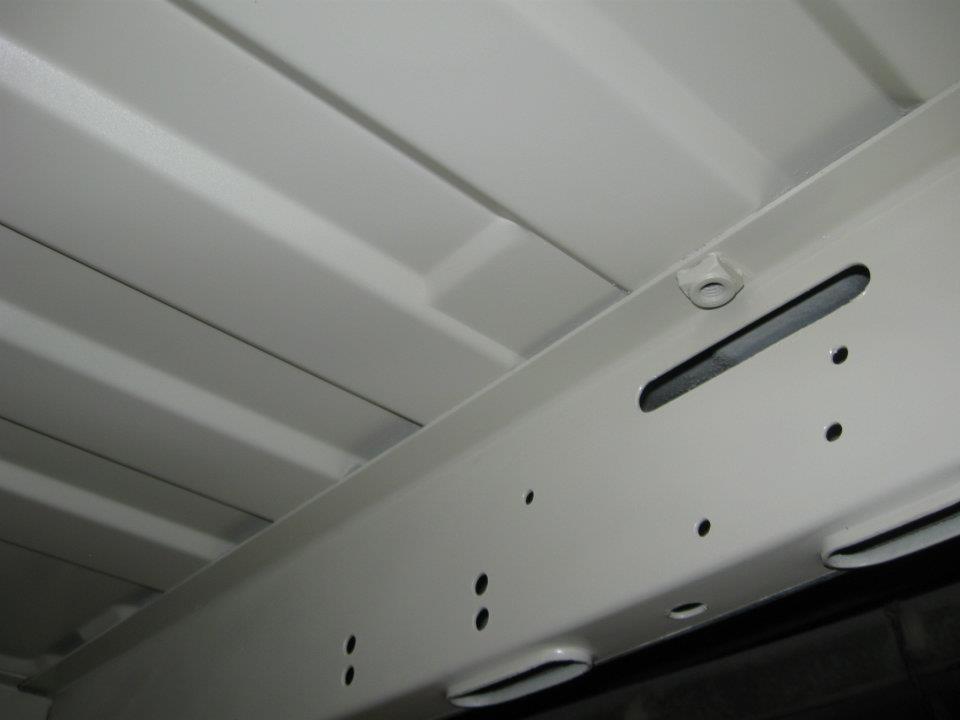

PostPosted: Wed Apr 30, 2014 8:58 am    Post subject: Reply with quote

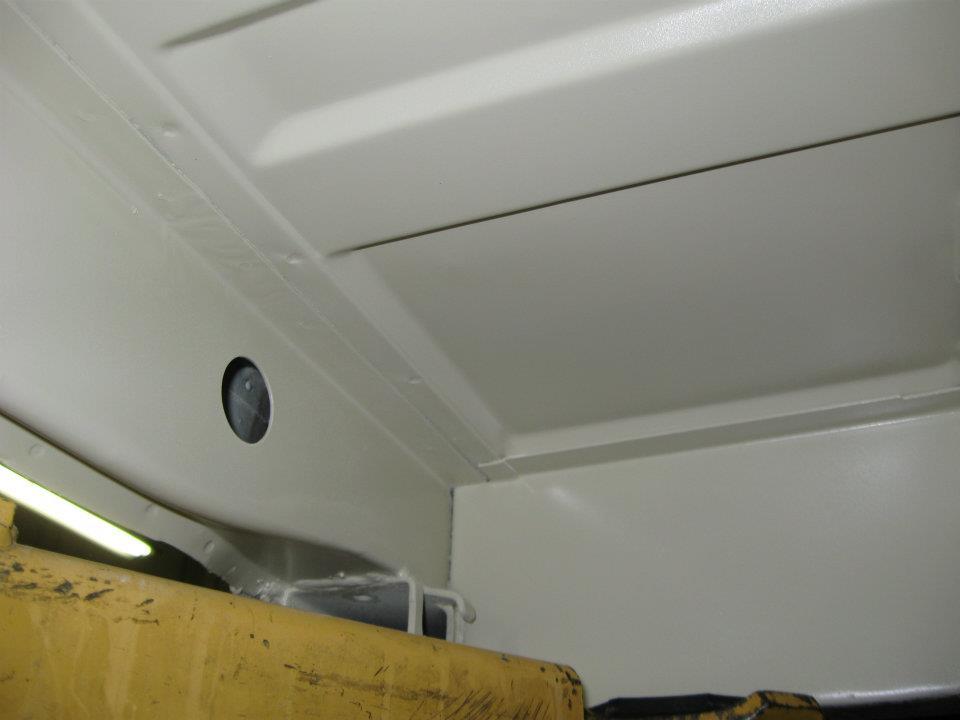

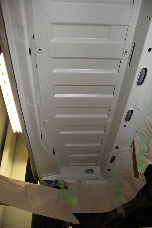

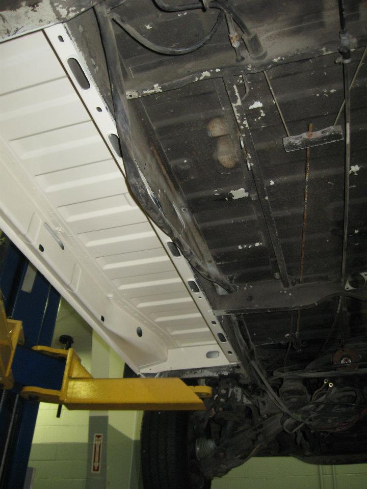

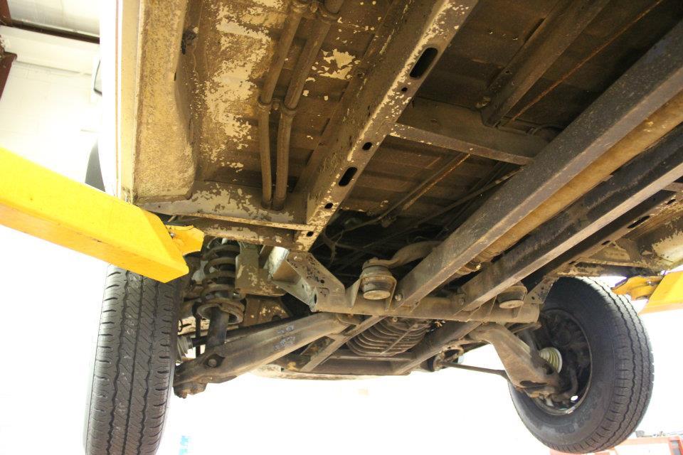

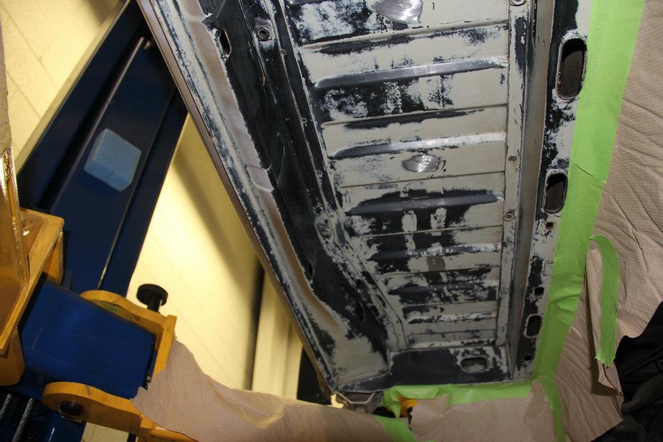

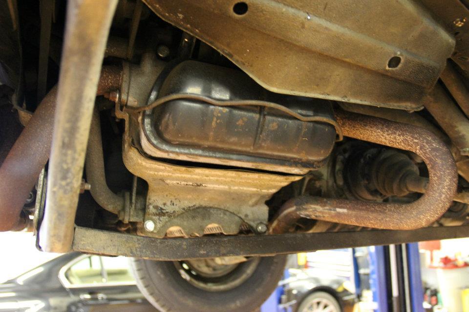

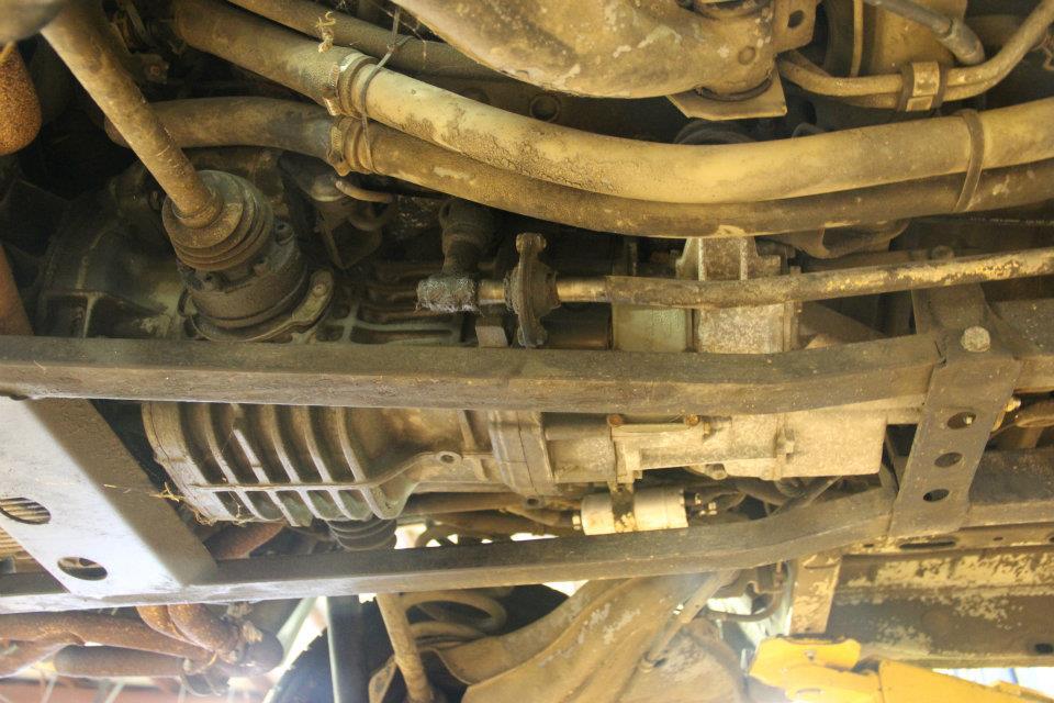

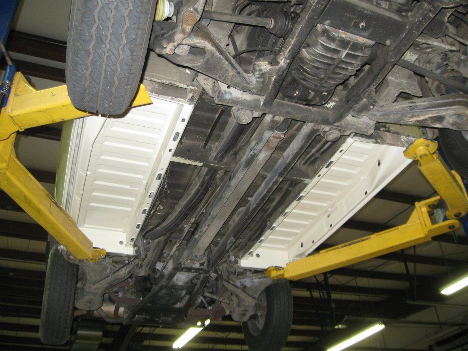

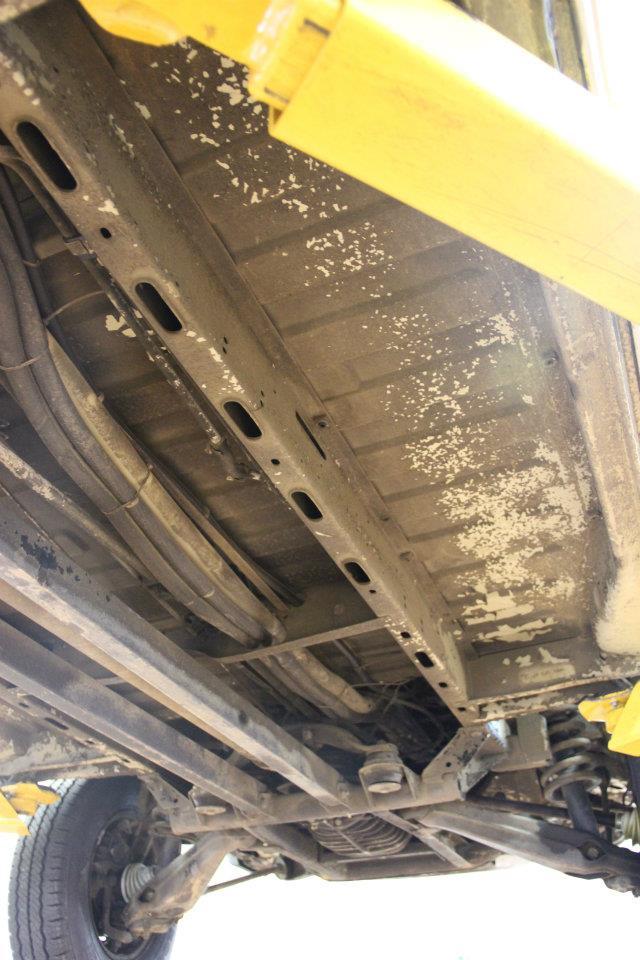

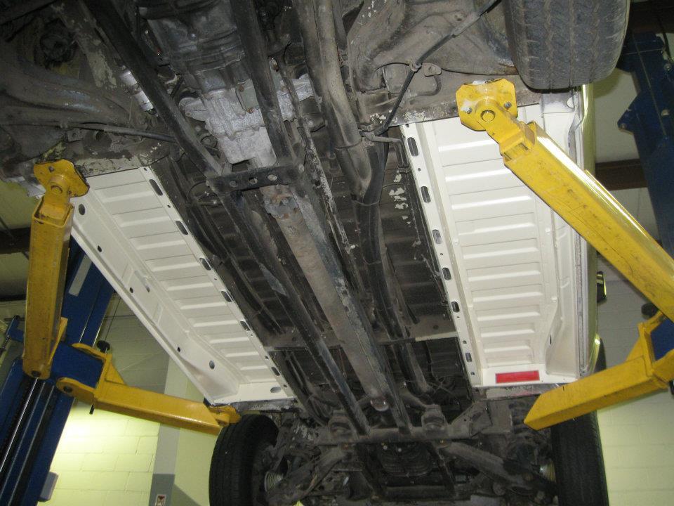

So moving down underneath the van, I wanted to come up with a basic color scheme. The almond color will be for the underside; black will be the suspension components and frame pieces as well as the fender wells. The aluminum will be for the drive line with red accents. The almond is close to what the factory color is behind the undercoating, just a little less pukey looking. The almond color is actually a two part epoxy primer with a matching enamel top coat. I like to section my work, without removing too much from the vehicle and ordering parts as I go. I do my best to keep a balance of work being done and parts coming in, that way when it comes time for assembly, everything is ready to install. Certainly a rotisserie would be best, but that is not an option as I need to keep the van mobile for as long as possible. Removing the undercoating comes down to elbow grease more than anything else. I used a number of different things, but a simple scraper and scotch brite pad handled most of it. I stayed away from anything mechanical, as I did not want to get all the way down to bare metal. It is certainly a lesson in patience and determination. The black is the factory primer with remnants of the base color. The VIN detail was just for fun.
