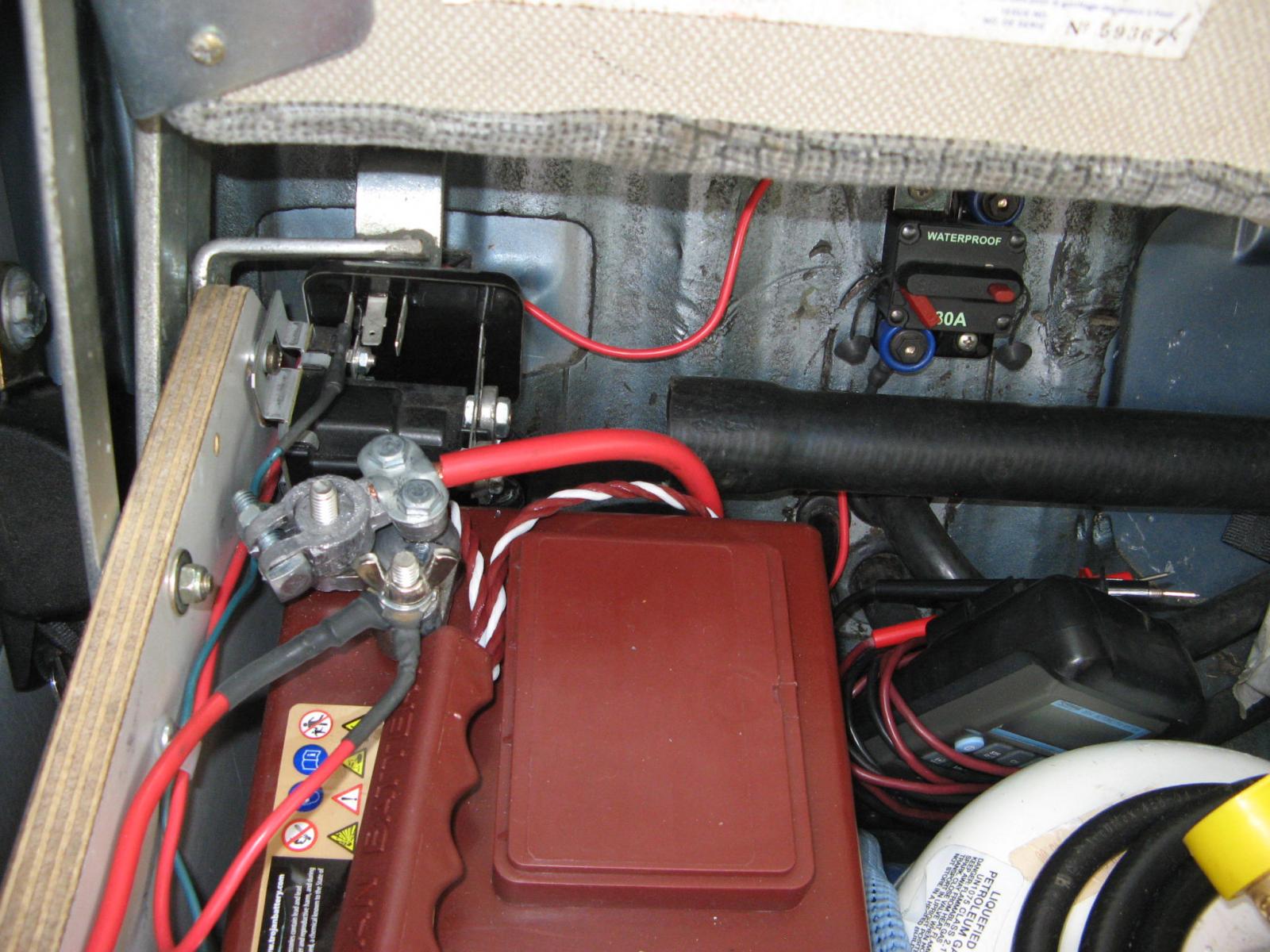

Here are a few pics of my solar set up. Very happy so far.
The Renogy 100W panel, with "briefcase" fits in the luggage rack. Despite my modified pop-top, my luggage rack is stock sized.
I hard-mounted the solar charger inside where I could easily see the panel and have the charge controller at the same temperature as the Trojan battery.
I re-purposed the city water connection into a solar connector with MC4 connectors.

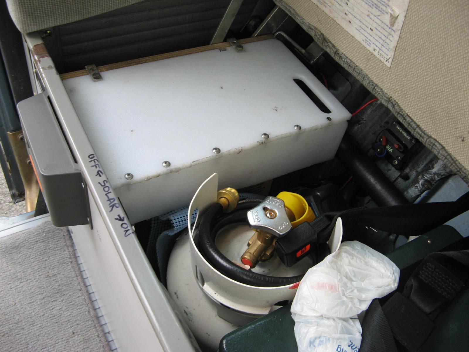

Trojan battery, Surepower battery separator, 80 amp main circuit breaker:
Ghetto Battery cover prevents short circuits from my under-seat items:

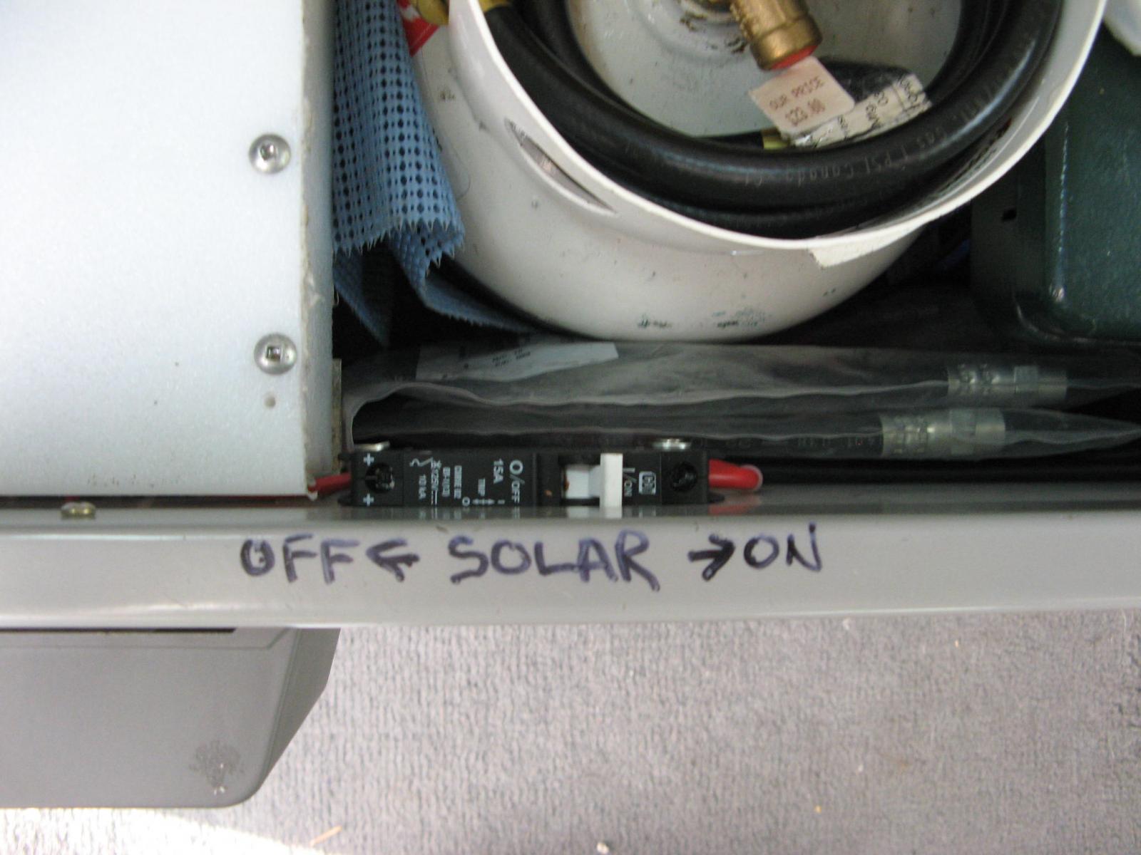

15 amp, 12V circuit breaker is my fool-proof "solar off" switch for those times I fail to set the charge controller setting properly for solar panel disconnect. For the Where's Waldo crowd, find the spare rad hose and spare brake hoses:
And here's why I like to be able to move my solar panel. The Howesights at Lillooet Lake where the first part of the day required constantly moving the panel. That's the price you pay for the waterfront campsite, I suppose:
