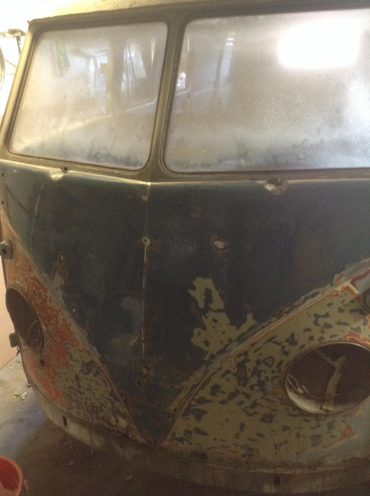

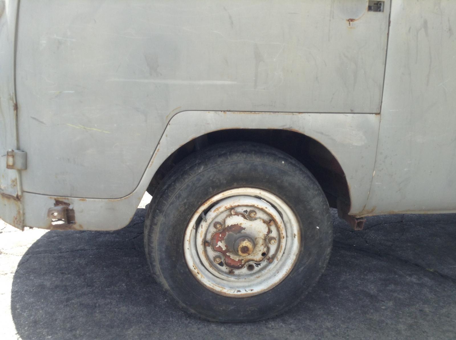

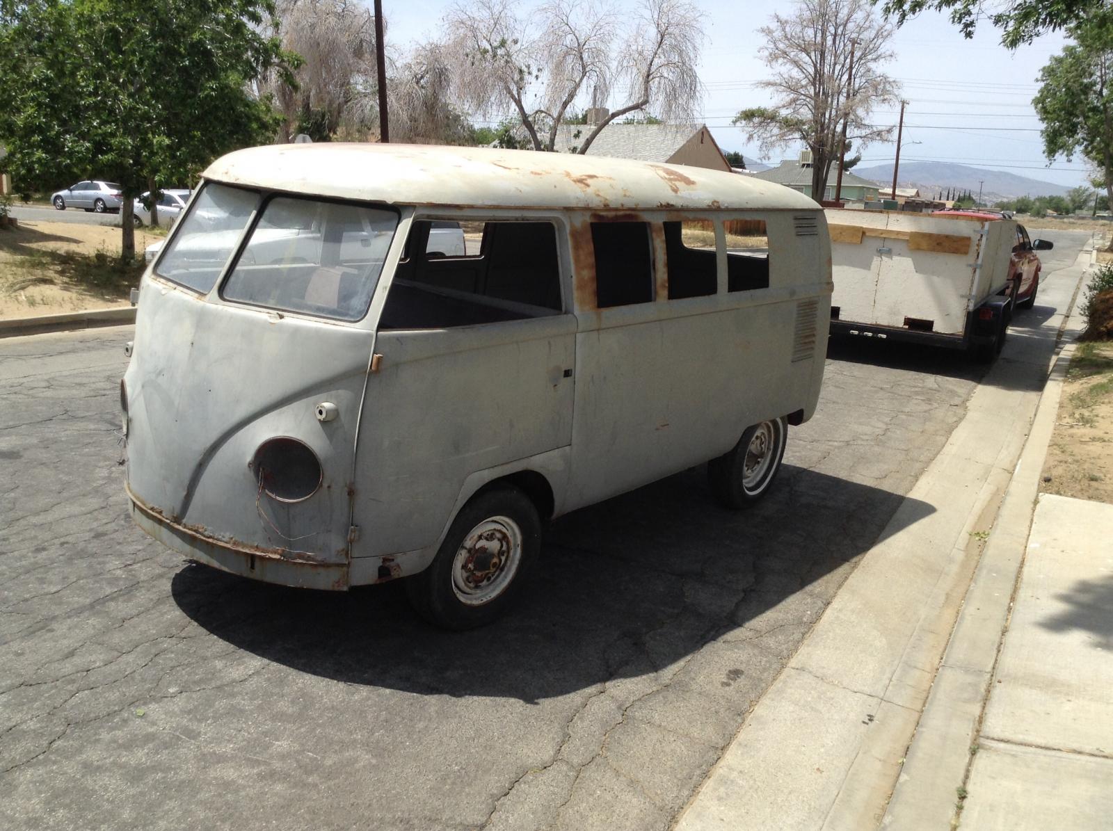

Hey guys, I've been a samba user for some time, but this is my first time really posting. I have owned many bugs and recently a a 1960 single cab. I recently traded my dove blue single cab for this 1959 dove blue bus. I don't know much about it, hoping you guys could help me out! I don't know what camper windows I need, or what interior it might have had. Also wondering if this was a camper that was converted by the owner or by a company? I am also taking it down to original paint, through the six or so layers of paint. Real pain in the butt, but I'm liking how it looks. I appreciate all feedback and any help anyone can offer. Looking forward to this build and my first topic.

pretty nice, looks like a pretty straight panel.
check your vin numbers, maybe it will tell us a little more.
good news is that you can put any camper interior in it you want.

Thanks! It is very straight with very little rust. M code is not on the bus but the vin is there, if I get a birth certificate, will they be able to give me the m code and info on the possible camper conversion company?

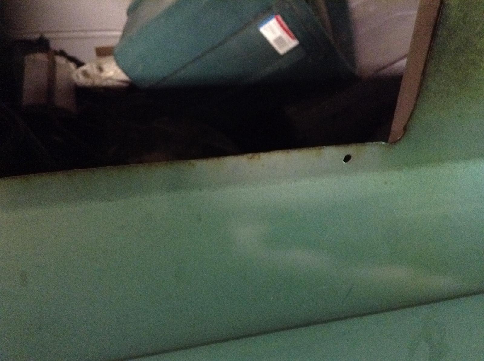

Really hoping someone will be able to identify the window mounting holes and know something about it.

zackcowie wrote:
what's up with the bulkhead? it should not be flat like that

PostPosted: Sun Apr 27, 2014 9:19 pm    Post subject: Reply with quote
Good eye! The PO cut out the recess for the Spare tire and covered it with a bus long section door panel.. Not sure why, there's no rust anywhere near there. But it was done, so I will be welding in a new spare recess. Hope I spelt that right.

rebapuck wrote:
Not much there. Why do you think it is a camper?
I think it is because it has camper windows cut into the sides and cargo doors... and I suppose I just really want a camper. I would love to find out that it is a Easy camper, sundial, etc. But if is just panel that someone cut holes into and threw camper windows in, I would embrace that as well Very Happy

Thought the vin wasn't enough, but wasn't sure. Thanks for the clarification! Hopefully one of the samba camper experts can determine from small things like the window mounting holes drilled. It looks like it could be maybe hehr or jalousie windows with a little chrome visor over it?

It looks like it would take HEHR camper windows like these.
I believe so as well! I believe hehr windows with the small chrome sun visor on the top of each window. Does anyone repop those windows or the visors? Or does any one know what kind of camper they came on?

http://www.vintagetrailersupply.com/Drip_Cap_p/vts-515.htm

HEHR windows were used by many camper and trailer makers including Airstream I believe. A complete set could be hard to find and they seem to be getting pricey.
