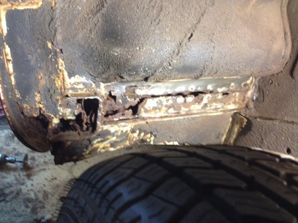

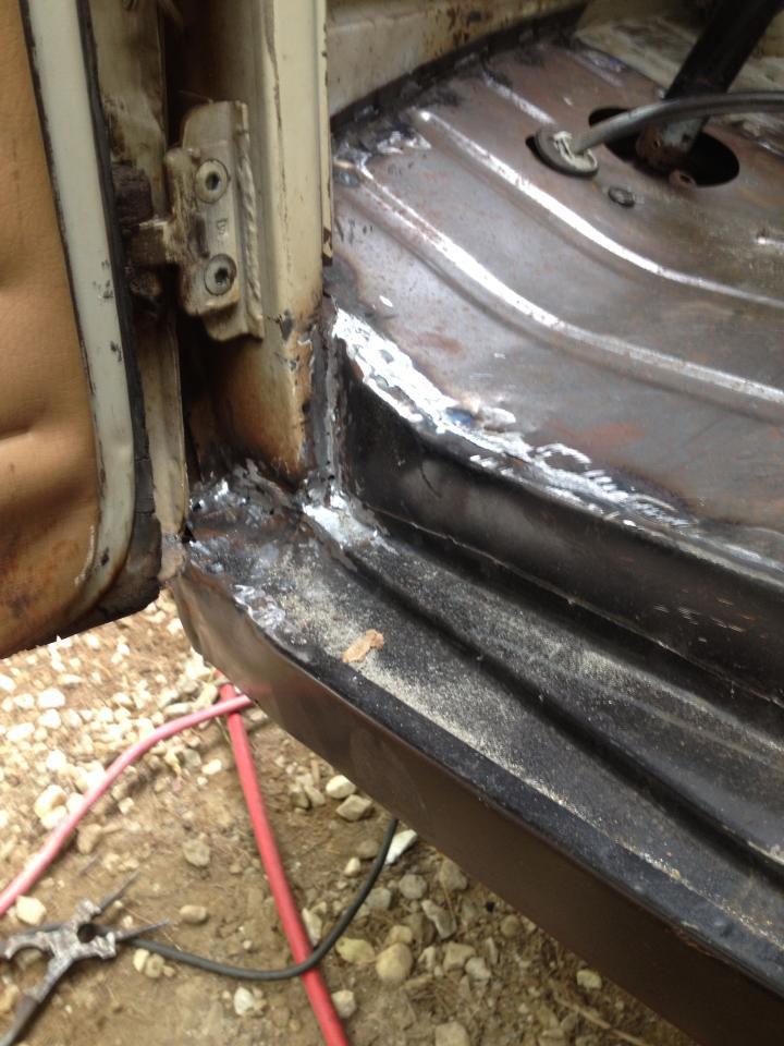

I've wanted a Westy since 3 secs after I sold my last one, 15ish years ago. Stella was found in the wilds of Hartford. She runs and stops, but hosted a shit ton of rust.
The floors had to go.
Inner and outer rockers too, and a nose panel.
The seats were ugly, we'll probably put in a couple of Vanagon seats, if we can find them cheap, and leave restoring the originals for a wealthier time. I came up with, seriously, $450 bucks just for materials to rehab them.
And that's progress so far.

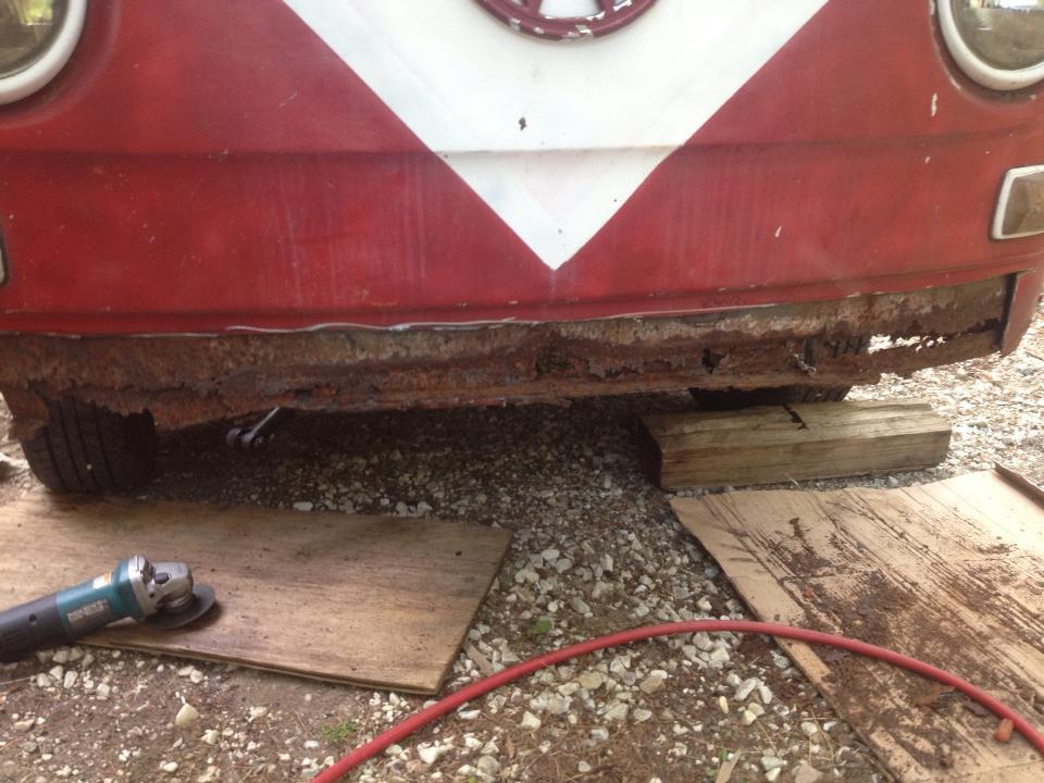

Nose job.

Looking for hints and tips on getting the nose straight.
1967250s
Joined: May 02, 2007
Posts: 2137
1967250s is offline
PostPosted: Fri May 30, 2014 12:30 am    Post subject: Reply with quote
Instead of trying to pull the nose downwards which will distort roof and whole front nose with rotten rockers and A and B pillars, first fix pillars, doglegs and rockers. Then pull the nose forwards if you have to, then weld it in proper position lower nose. REmember that it is all sheetmetal and pulling on one section pulls on all the stuff attached. You really need to read more of the body work threads. More pics of the nose and under the chassis would help. The Bus design all depends on interlocking welded parts supporting each other. Find the thread that has the new Haynes body work book.

Thanks for this heads up, 67. On Busdaddys's prompting, we tried jacking up under the front frame. It worked a treat, and if my untrained eye is correct, no damage ensued. Smile
