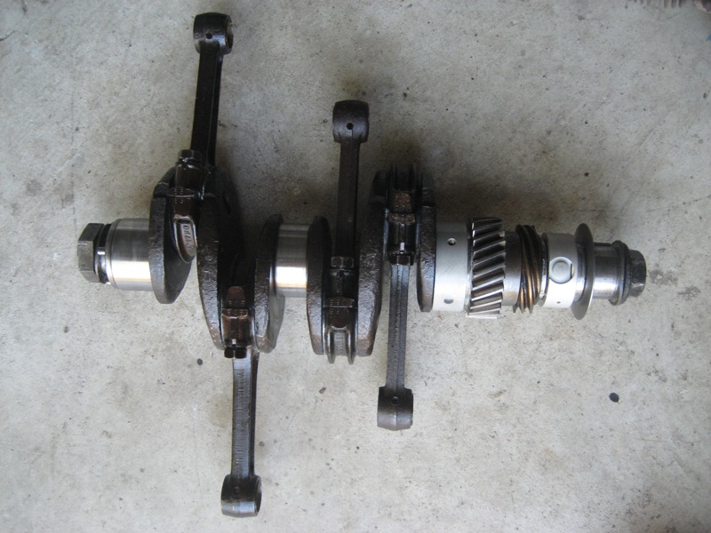

Real quick, I am putting my 36hp together and the directions are unclear on orientation of the main bearing right behind the pulley, does the groove in the bearing go on the inside or the outside?

Here is a photo from the gallery. Hope it helps.

your dowel pin holes go toward the flywheel look at your case they are off set toward the back hope that help not sure what you are saying

outside

Reviving an old thread here. I have a similar question but with the #3 bearing behind the crank gears. The dowel pin is centered in the saddle and the bearing will work either way but is one direction preferred over the other? The only difference is the location of the oil holes in the bearing move a few degrees.

According to the late 356 guru Harry Pellow, the oil hole that is furthest from the dowel pin should be positioned toward the camshaft, or the bottom of the cases. I agree with him.
