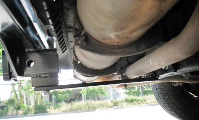

So I just impulisvely bought this hitch
on craigslist for $50. The previous owner replaced it with a fiamma. Does anyone use this as well? I plan on putting a bike rack to it and putting one road bike and one mountain bike. I just am not sure how comfortable I am mounting the T bracket to the engine mount. Would it have enough structural integrity? When I attach the hitch do I need to put something under the engine to support the weight when I unscrew the bolts from the mount. Thanks.

it's a Vano Hitch, the T-bracket is bolted to the mustache bar, not the engine itself, it means to help the support for downward weight a bit... otherwise the tow loop will bend.
you will be OK for 2 bicycles or a luggage rack weighting no more than 300 lbs
no you don't need anything to support the engine when you bolt the hitch on.. it's very easy to install... a drop of Loctite would be nice because vibrations may loose the bold after a while

I would think that if all your are carrying is two bicycles the hitch unsupported would work fine just attached to the toe eyes on the bumper brackets.
To me the down side of tying into the engine support bar is it would be possible even in a small fender bender to transfer load/damage into the engine mounting. Not good.
Mount it up with just the bumper eyes, load your bikes on and see for yourself if it is supported enough.

Just a heads up, I had the same question after doing my engine swap. I have very light bikes and a very light bike rack (thule T2).
Mike Wiehl <[email protected]>
Feb 3
to me
Hi Alex,
Without the connection to the motor mount bracket the hitch will want to twist downward from the tongue weight of the bike rack. You will most likely bend the tow hooks and damage the bumper bracket. In order to use the hitch properly the connection to the motor mount bracket must be made. Thanks.

A minor quibble.. The tow hooks are not going to bend from the leveraging of the bike rack.. What happens is that the bolts that fit in the tow loop slot work their way down in the slot and the hitch tilts down ward some, as a result.. Use of the support bar holds the hitch up and in so the bolts do not work their way back down the tow loop.
Personally I'd not use the GW hitch with out the support bar. (if being used to hold a hitch/rack accessory)
I towed ridiculous weight with the GW hitch.. and used it to hold a 4 bike rack. It is bomb proof for what it is..
But the real solution is a proper frame mount hitch as built by the likes of RMW and Burley Motorsports.
They cost a few bucks more, but its a "real" tow hitch that will hold properly..
The GW set up is a compromise design. But it will get he job done.
