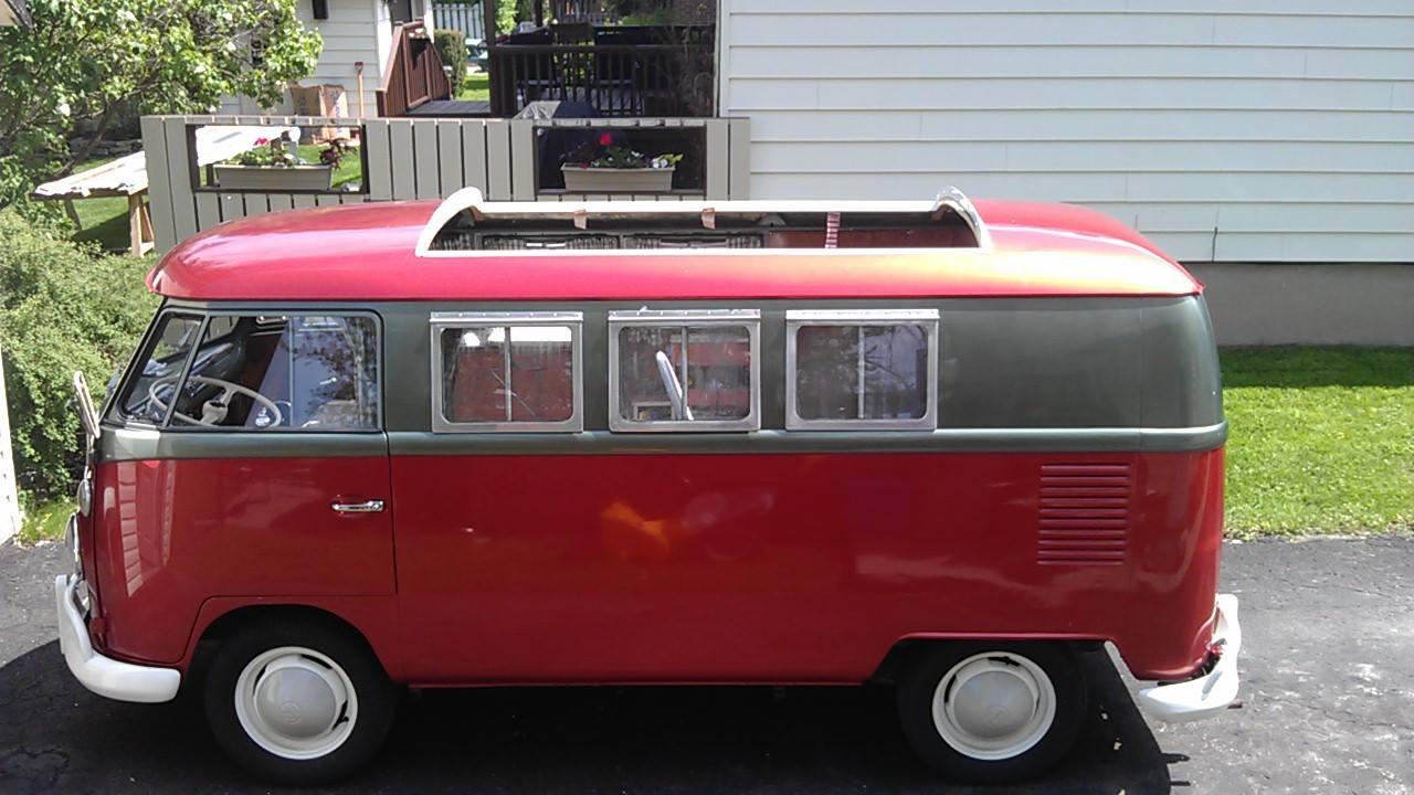

Before Shot
Wheels and bumpers on
Top buffed and new window seals in

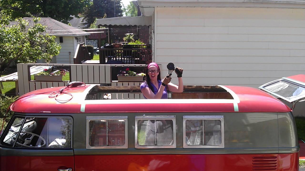

Marker hole drilled 1 3/4 inch from grill, (nice pic eh Xavi!)
Used string to get the lines straight, and measrured and marked it out on the tape, measured again. Slept on it went out with fresh eyes and mind and measured everything again.
Once marked, I drilled a few pilot holes, and I used a jigsaw with metal blades to do the cut, the angle grinder was just for the roof support arch, and my trusty wife giving me a hand!
It is a big hole!!
Got the frame up and it fit like a glove, no trimming or adjusting needed.

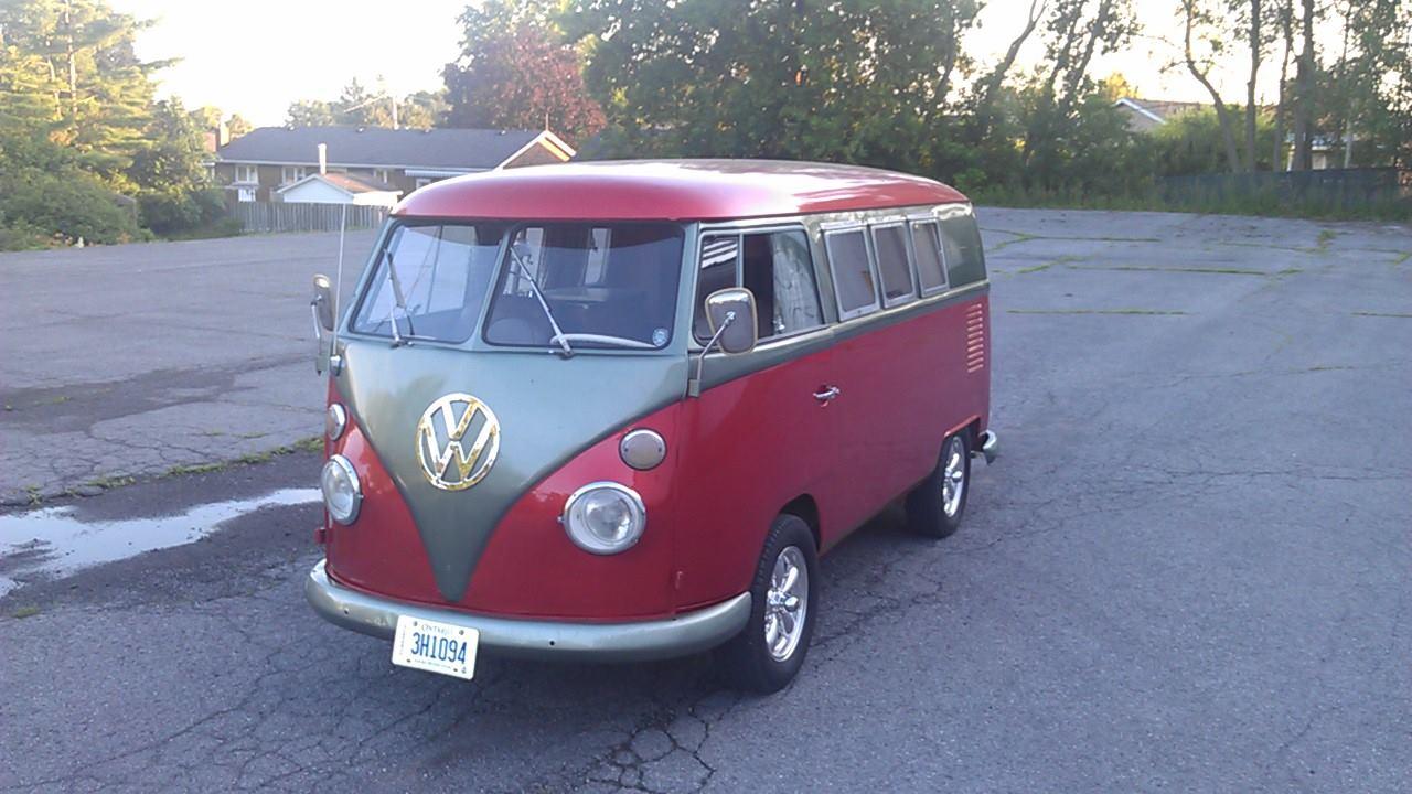

66 Bus
71 Bug
