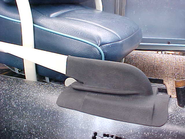

PostPosted: Sun Mar 25, 2007 8:36 am    Post subject: Reply with quote
splitjunkie wrote:
My guess is that is a late version of that boot. It is probably very rare as well. The next version that was on ovals and all other versions after it had the pebble grain finish.[/quote]
Here's what a 1953-55 boot looks like

PostPosted: Sun Mar 25, 2007 1:44 pm    Post subject: Reply with quote
That is what I am talking about. I always assumed that the pebble grain was introduced on that cover but apparently it was introduced on the split cover towards the end of it's production.
Mine does not have the pebble grain but is smooth like in John's picture.

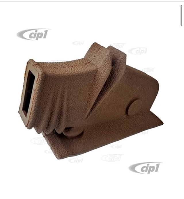

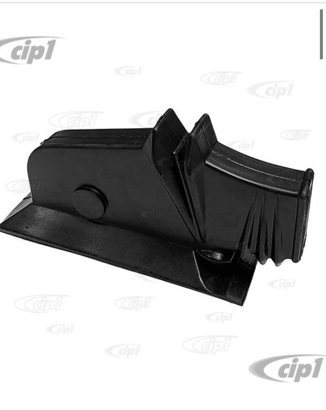

PostPosted: Sun Jan 30, 2022 4:01 pm    Post subject: Re: Split Handbrake Cover Reply with quote
I’m interested peoples latest opinion of what years theses parking brake boots were offered and also interested in opinions of theses reproduction boots compared to original
I myself was surprised with the textured appearance of the brown boot , is original like this ?
