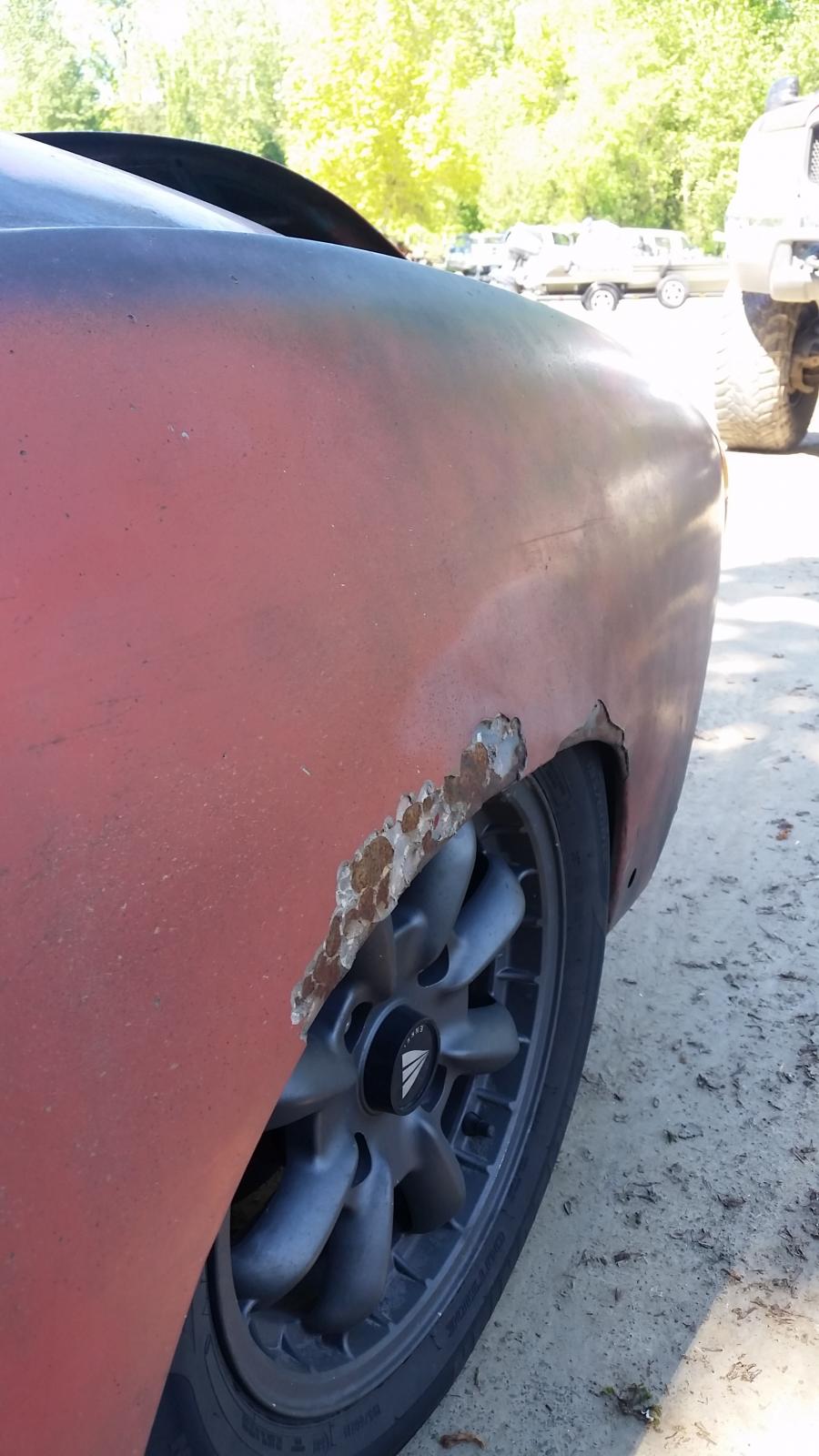

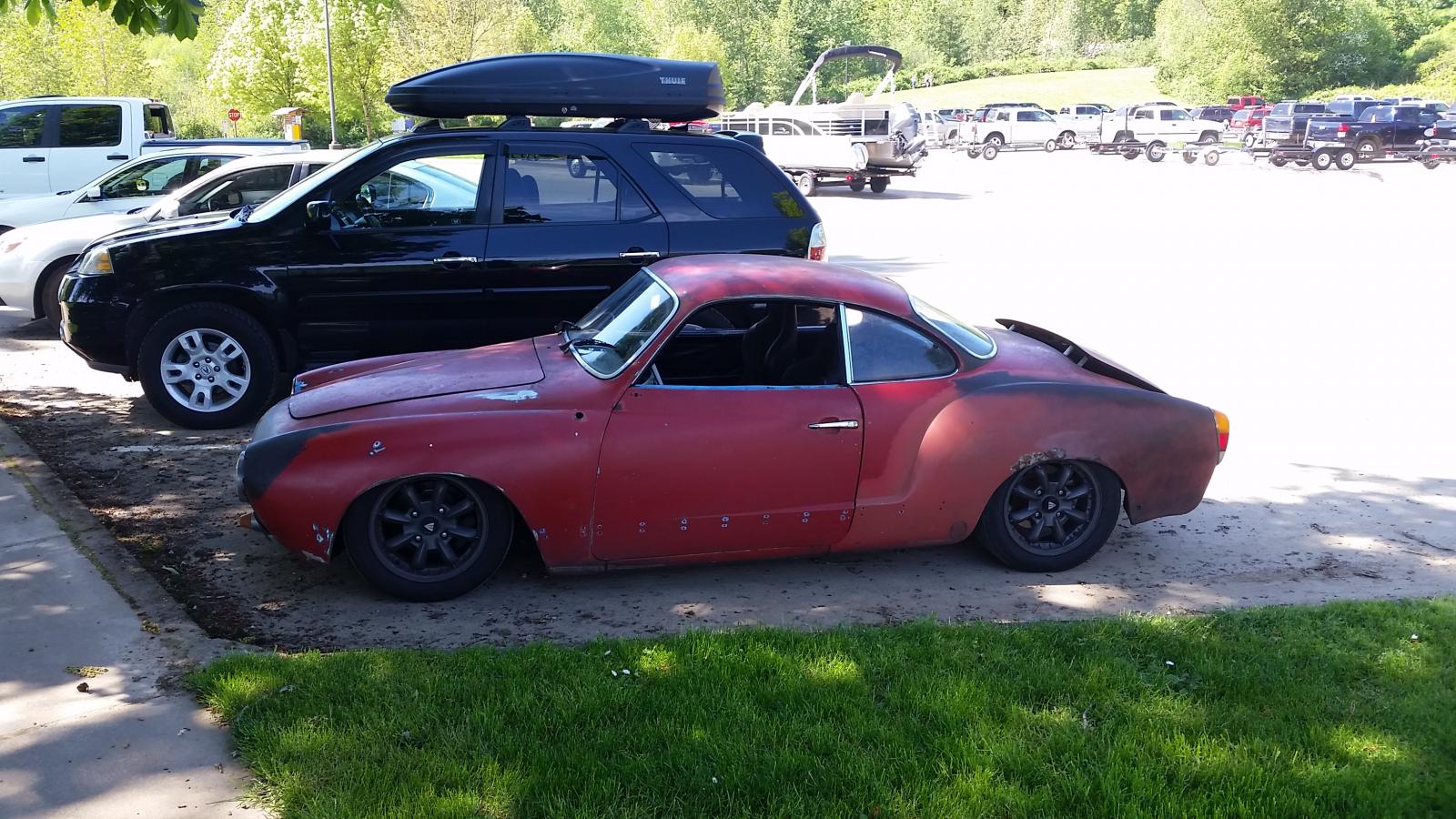

Here are some pics of my car with Enkie Compe's. Apologies for the rough car.... It was my daily in high school and I haven't gotten to finish the project. I always end up spending more time and money making it faster than I do making it nicer Embarassed
Oh! To is on a 3.5" ball joint beam and is narrowed 1" each side in the rear. With empi disc brake kit (I think it adds maybe 1/8" offset) I had to "tap" Laughing the inner fender to stop the rub. It has literally 1/32" of clearance with a 195/50/15 in the rear.
