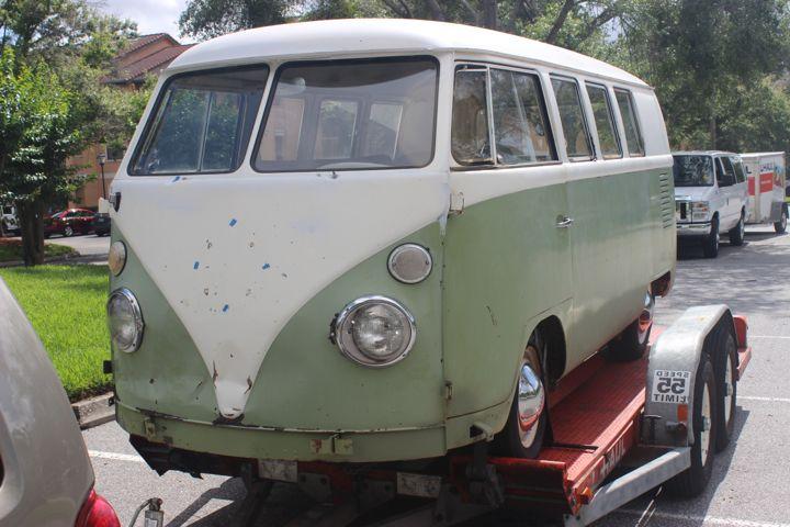

Hello Samba, I am starting this thread to document the restoration and camper conversion on my 1967 11 window standard. My wife and I bought this bus last year in Florida - I didn't have any prior VW or auto experience (didn't even know how to drive stick!) I spent most of the year trying to learn my way around the engine and getting the thing driving down the road. I've got a blog going at www.iboughtabus.com
The second part of the story is that I'm quitting my stable, corporate job to fix up the bus and hit the road! My wife does graphic design work remotely, and we're planning on driving the bus around the country for the next year or so - I'm hoping to make some pretty quick progress on this bus, and get out there! I welcome any and all comments, criticisms, and advice.

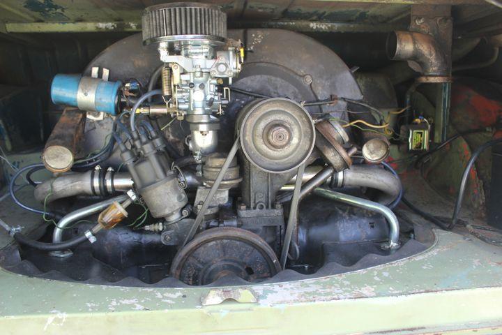

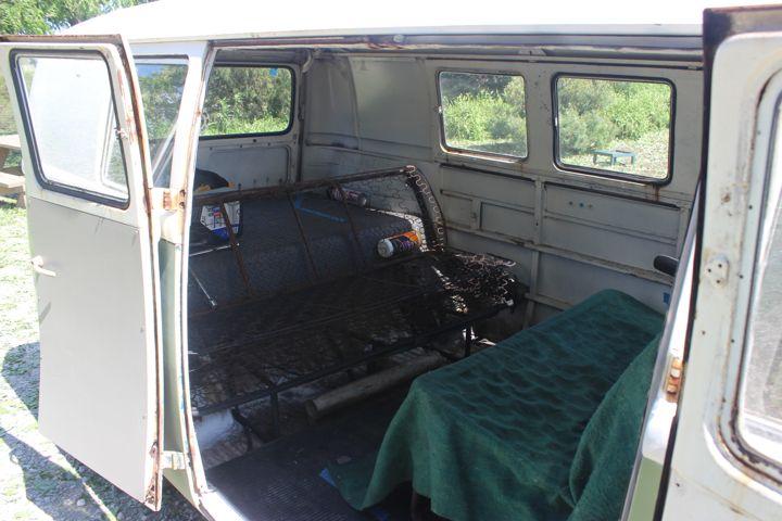

looks nice, what are your plans for the camper conversion?
are planning on scoring a westy interior? pop-top?
looks like you will need to invest in some heaterboxes, and a stock air cleaner setup.
without pre-heating it will be a bitch to run it in the winter.

Thanks Splitty and Uli - the plan is to keep the bus looking pretty stock on the outside, with a custom interior camper build on the inside. I'm definitely familiar w/ the dangerz blog, as well as bumfuzzle, and several others. I've also read through tons of Samba forums, and have seen the good and some bad! Honestly, this bus has been a crazy patchwork of random parts and pieces from all over. Not much of it is original to the bus, so I don't feel bad making it my own - most of the interior work will be completely reversible anyways.

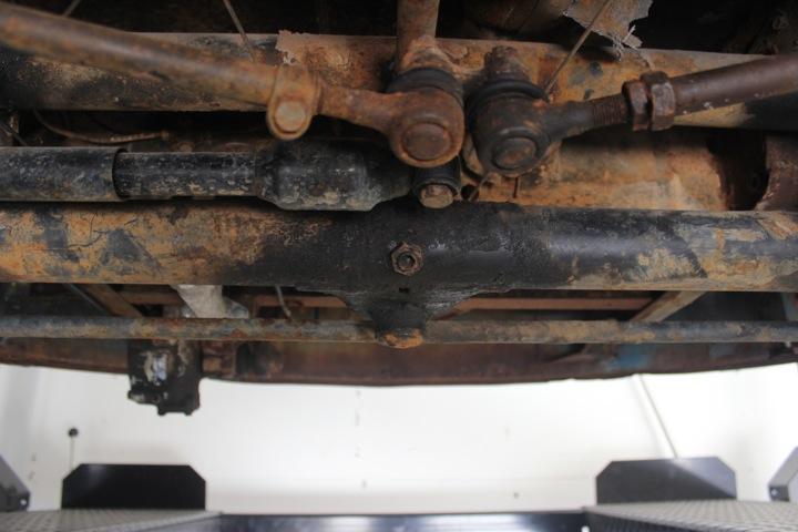

I'll probably keep it a tin-top, but do want to get the OG air intake setup, along w/ heater boxes. Probably won't add a gas heater though because I want room for a second battery. It has a beetle straight axle transmission now, and is a few inches lowered. I'm planning on buying a RGB tranny from Rancho, and potentially getting a new beam or at least stock spindles with a disk brake kit up front.
Here are a few pics of the underside, and some of the deconstruction progress we made today.

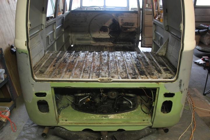

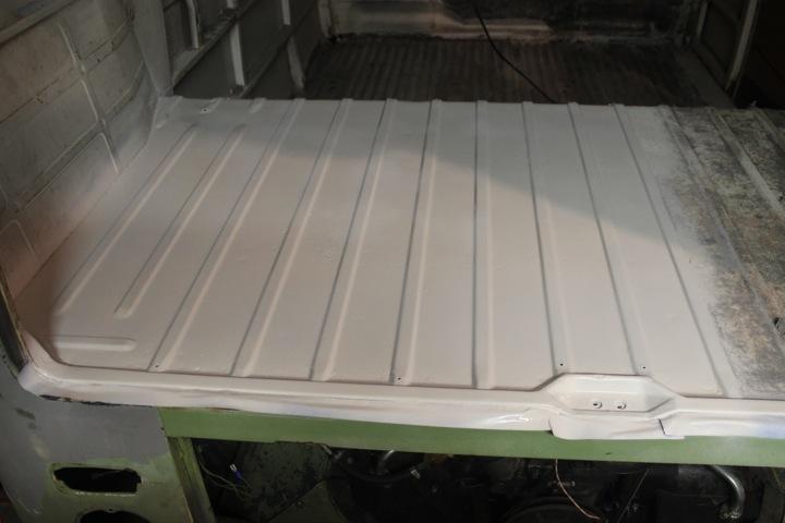

After spending a couple days taking the bus apart, I was feeling a little bit overwhelmed by it all... so I decided to make just a tiny bit of forward progress!
Thats a few hours of wire wheeling w/ the angle grinder, and some Rustoleum Clean Metal primer. I know I'm just going to cover this luggage area up w/ sound deadener, insulation, and carpeting of some kind, but I wanted to paint something!

Good call on the luggage area, very easy to get overwhelmed when working on a bus. Smile

Looks good, but get a case of Naval Jelly. You want all of the rust out of the metal!
