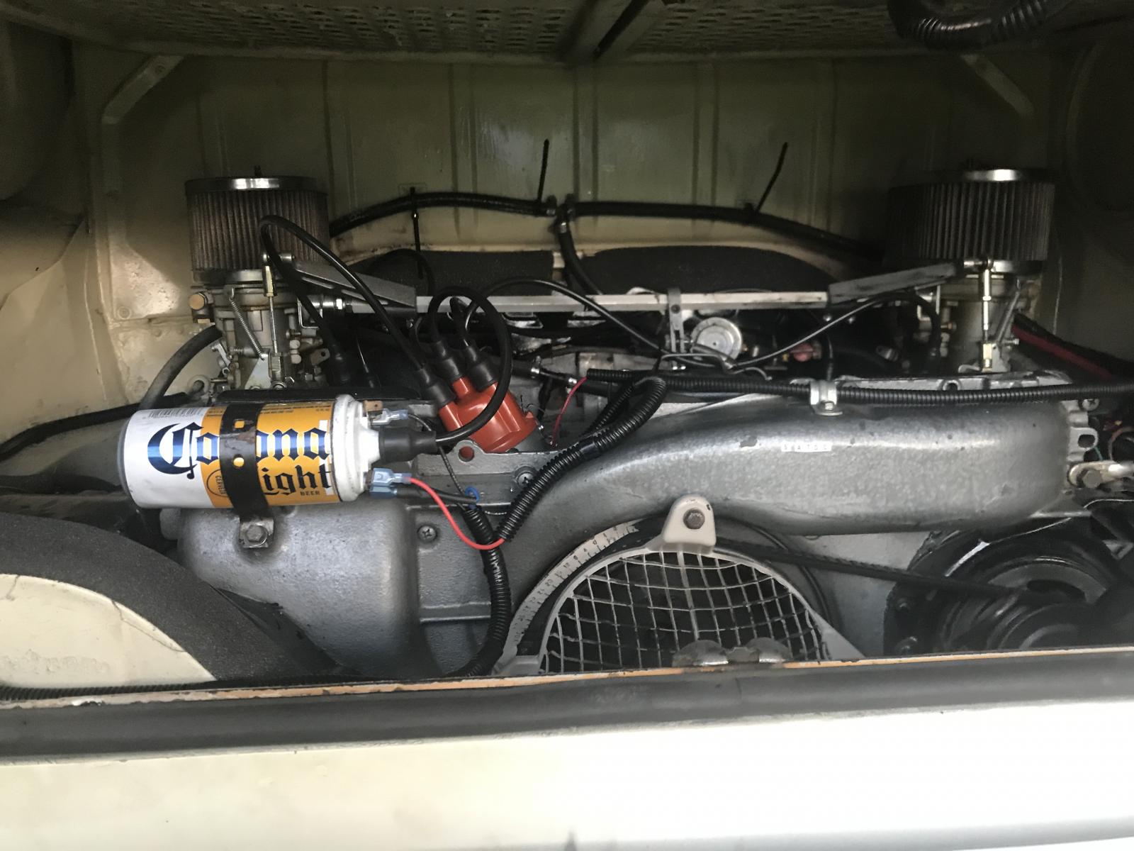

I have a 2L with dual 40's. Switching from 009 to vac dust. There are no vac ports on the carbs. Any idea where I can drill and tap access? Thanks

Unscrew that slot headed brass plug from that nipple sticking out just above the idle mixture screw Wink

PostPosted: Wed Jul 04, 2018 2:18 am    Post subject: Re: Dual 40 Dist vacuum port Reply with quote
Thanks Busdaddy, Thanks Glen
