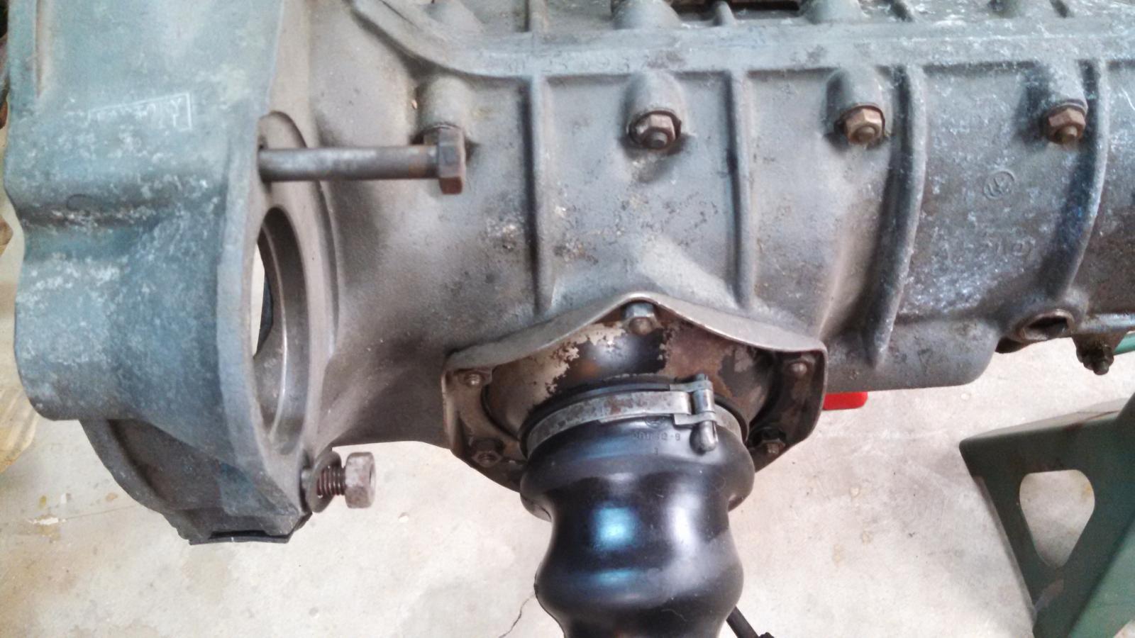

Hi,
When I purchased my BD, it came with a gearbox, the part number 113.301 101 B Does 113 mean it was a beetle gearbox?
It has the number 2A.... I can get the rest later.
As I understand that there are two gearbox types, the early vertically split case boxes used on the 'crash' and early 1200 vans to the early 50s.
There seems to be NO web-based resource for identifying stock split gearboxes. I find this hard to believe, but I can't find anything, just the beetle box lists.
Thanks for any help.

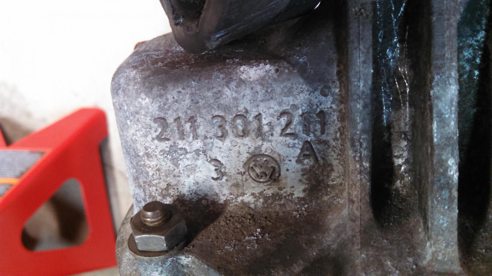

The number is 2A2062018, code on the top is 323977 and the nose cone number is 211.301.211.
Thanks
Rob
Posts: 71515
PostPosted: Tue Jun 10, 2014 5:16 pm    Post subject: Reply with quote
2A2062018 looks like early '59.
I'm not sure what 323977 is - where is that at? Photo?
The nose cone # is the parts # for the nose - that is a normal split-case Bus nosecone

59, that's what I thought.
The number is located on the top of the gearbox.
Posts: 71515
PostPosted: Wed Jun 11, 2014 8:28 am    Post subject: Reply with quote
It looks like the symbol to the left of that number is the VW recycle symbol so maybe that is a VW-rebuilt unit and the number relates to that.

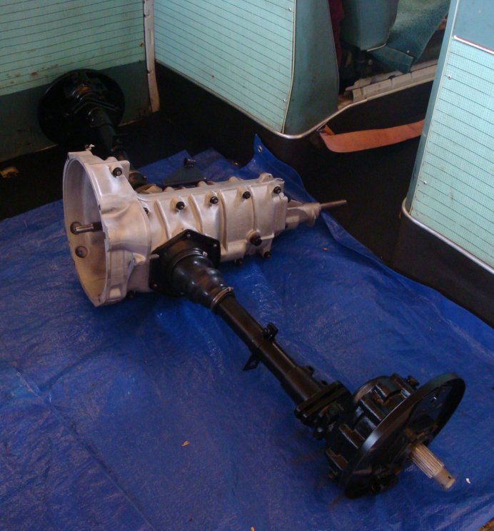

I have a trasmission that was in my 57 euro deluxe with the number 2A-149400 So this appears to be from a 53?
I'd very much like to get one closer to December 1956 when my bus was made.
Anyone want to trade ?
Please PM me if you do.
Posts: 71515
PostPosted: Fri Nov 21, 2014 10:29 pm    Post subject: Reply with quote
I don't have one to trade but out of curiosity:
It is a "smooth case" transmission like this:
nlorntson
Crazy VW Lady
Joined: March 13, 2004
Posts: 3856
Location: Twin Cities, MN
nlorntson is offline
PostPosted: Sat Nov 22, 2014 9:59 am    Post subject: Reply with quote
This is what I have. I'm not sure what you mean by smooth case.
Posts: 71515
PostPosted: Sat Nov 22, 2014 10:17 am    Post subject: Reply with quote
I agree that is a '53 transmission.
I guess they used what they had on hand since the reduction boxes and nose cone are later pieces.
The earlier transmission casings have less cross-ribbing.
Here's my later NOS case:
A side by side comparison would be better but I no longer have the early '54 transmission pictured above.
