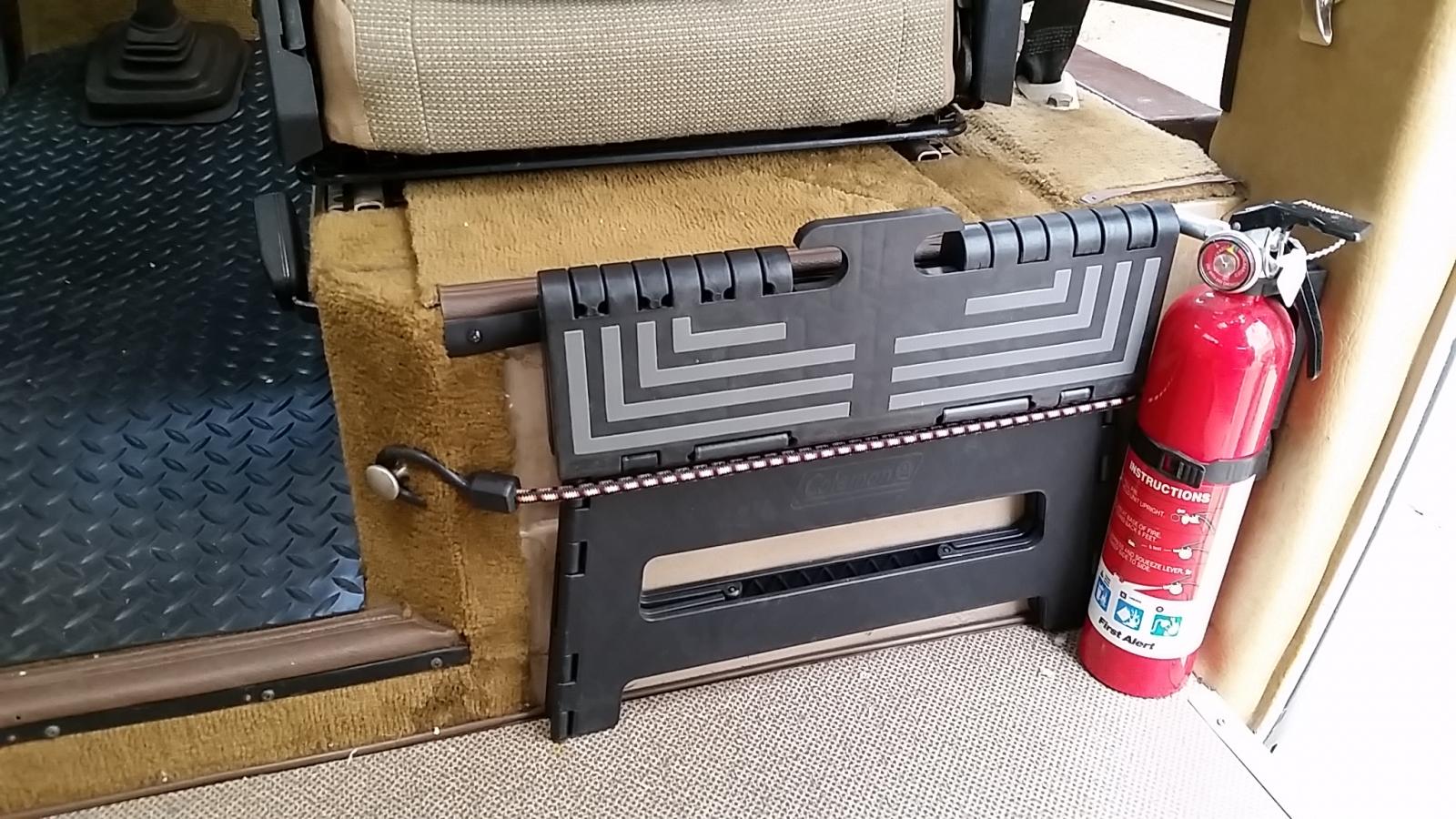

Here's what I ended up with- not ideal, but it'll do for now. Went with a Bosch group 41. Still have no idea what the PO was thinking- it's one thing to beat the hell out of the battery box, but he completely diced up the carpet, and big chunks were missing. Glued what I could to cover the corner, made a hinged flap for over the cover. Drawer pull from Home Depot threaded into a riv-nut, bungee, and Coleman step stool. Already proved handy!

When life throws you lemons...
(nice recovery)
