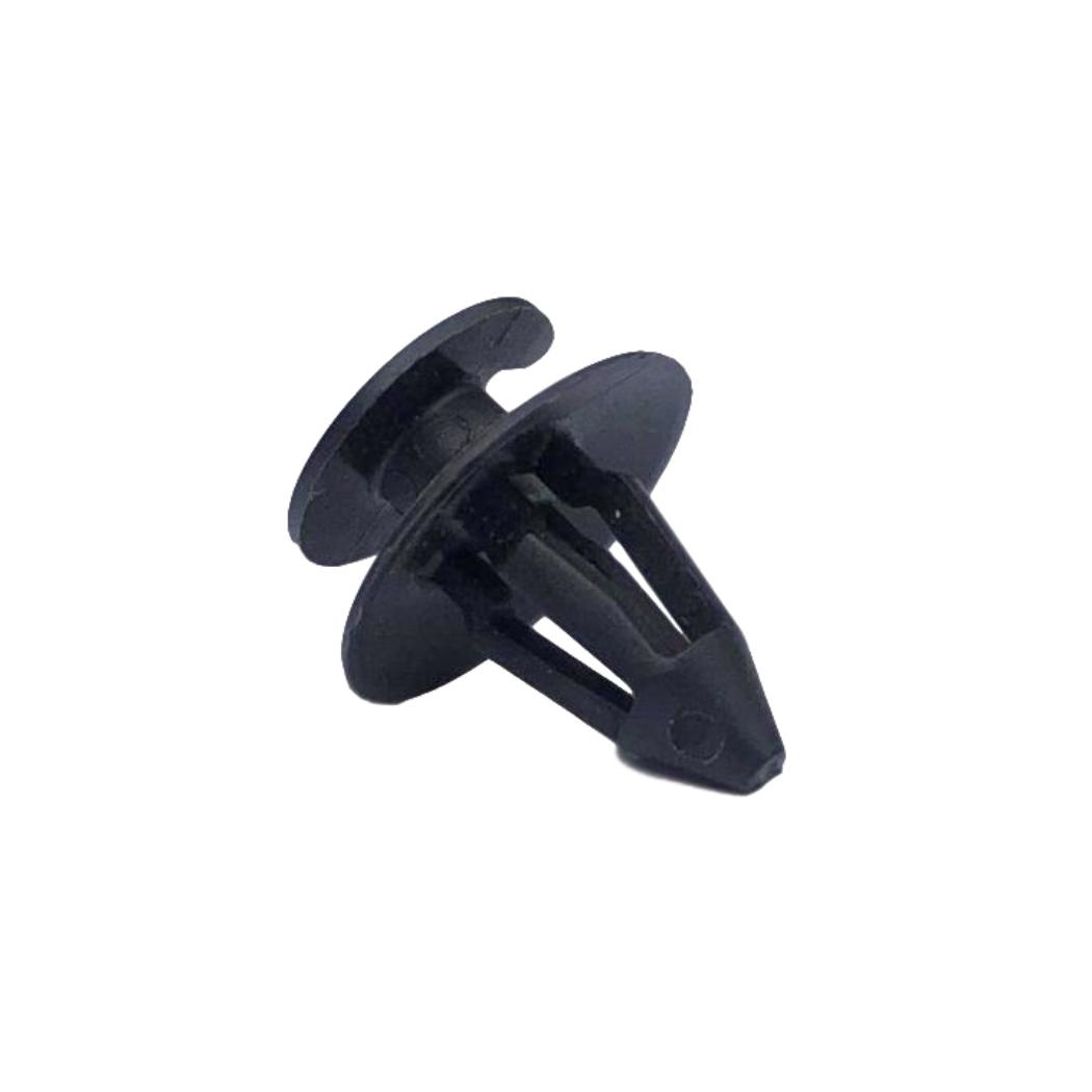

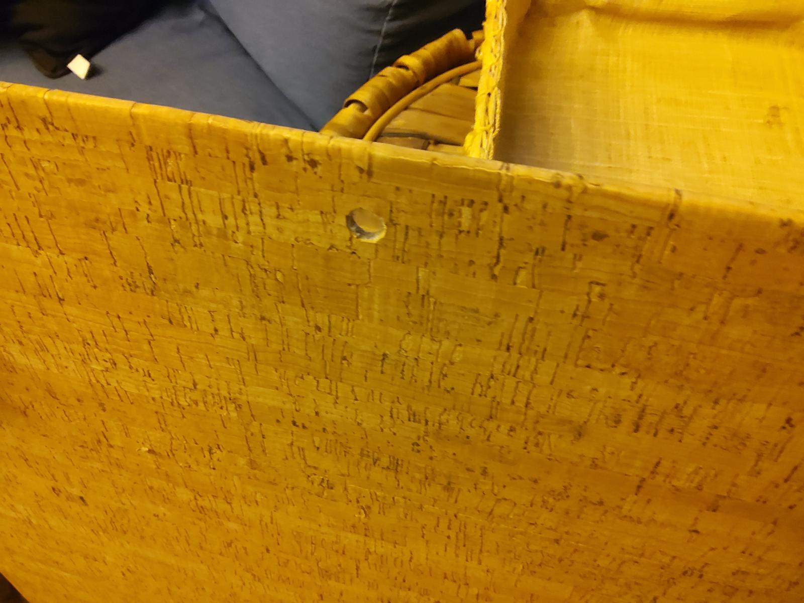

Update to the door project. We bought a nice bamboo fabric from Joanne's along with the 3M spray glue. We got the fabric on and went to install using theses clips:
https://www.gowesty.com/product/upholstery-tools-hardware/2323/door-panel-clip-exposed-head-black-
And they are not deep enough. Any ideas where to get longer clips/plugs? Right now the plugs go through the holes but the length ends at the depth of the fabric (x2) plus the panel. I need it to go about another 3/16ths.
The hole in my life I am trying to fill:
Cheers, Mi3ke
DuncanS
Joined: October 17, 2013
Posts: 4583
Location: New Hampshire
DuncanS is offline
PostPosted: Mon Sep 27, 2021 7:52 pm    Post subject: Re: Door panel Reply with quote
The panels use holes which the fabric covers. This is what was used. You screw it in from behind. The head is designed to be covered. Maybe something else will work.
Mi3ke
Joined: January 04, 2021
Posts: 4
Location: NM
Mi3ke is offline
PostPosted: Mon Sep 27, 2021 8:21 pm    Post subject: Re: Door panel Reply with quote
Bueno.
danfromsyr
Joined: March 01, 2004
Posts: 15351
Location: Syracuse, NY
danfromsyr is offline
PostPosted: Mon Sep 27, 2021 8:51 pm    Post subject: Re: Door panel Reply with quote
there are ALL SORTS of assorted door panel clip packs out there.
likely even your local NAPA has some on a rotating display by the counter.
but for $20 you'll have more than you ever dreamed of from Amazon/fleabay
https://www.google.com/search?q=assorted+door+panel+clips
