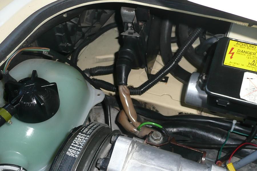

Couldn't see the video, but... if there is air in the coolant reservoir the light will flash and the needle peg irrespective of coolant temperature.
The tank in this photo should always be totally full:
If the tank is full -- a faulty sensor or broken wiring can also cause errant blinking and needle rise.

So I topped off the expansion tank with distilled water and the mystery temperature gauge problem is no more. I drove around for a few miles with no problems. I'll check the level next go around.
Although, I am a little curious why the level was low to begin with. I remember it being full a few days before the problem first happened. I had to replace the hose to the overflow tank and fill it up. Maybe something went wrong there.
Thanks for the help!

PostPosted: Thu Jan 19, 2017 6:32 pm    Post subject: Re: Mystery Temperature Gauge Problem Reply with quote
All right!
I just love happy endings.
