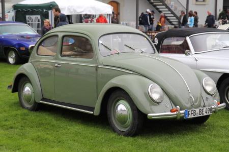

There was a thread, where sombody showed his pastel green car with one-tone rims. This beetle was from 1952 and he found a source showing a paint like L16 or so. This green was more bright, especially in the shade of the fender. There was also another member showing his brown car with original paint rims that were also brighter than the body. And this is perhaps a thing, where we can say: Perhaps body colour on rims -1950, up from 1951 brighter one-tone colour or optional two-tone colour?
Here is also a hint from the VW advertising:
This car is obviously a 1951 with one-tone coloured rims. But the colour shines bright in the shade of the fender!

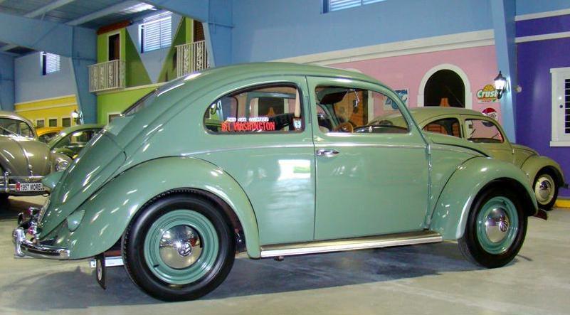

a VW split from 1950 in the VW museum in Wolfsburg:
One-tone coloured rims in body colour without pin stripes!

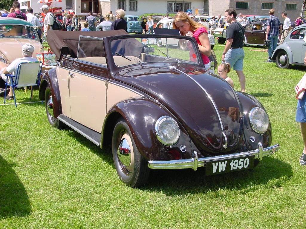

Interesting topic - my 51 Kabriolet was originally two tone L71 and L72 - what colour should the wheels be?
I assume the bumper groove and hup caps should be the darker colour L72. Is that correct?
Should I be adding a pin stripe?
Cheers,
Dave
Wheels should be two-tone, L72 dark brown rims, L71 beige center.
And yes on the bumber groove and hub cap VW logos.
L72 / L71 1950 split cabrio
Also see this picture, which btw. also shows us that the Pastel green was the last color to have two-tone wheels, picture is from april 1951 or later.

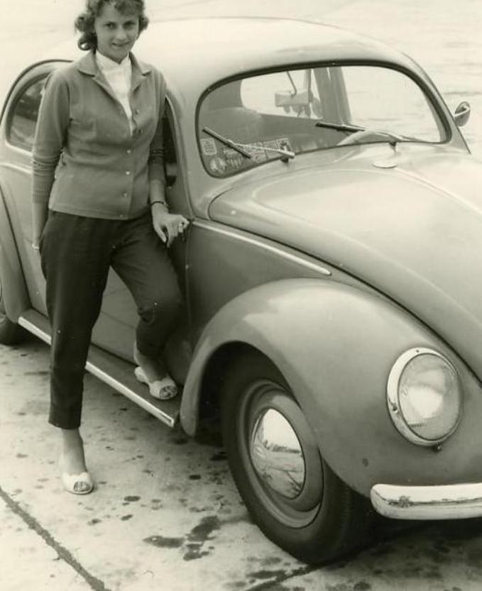

Picture 5 is from that book, but scanned. On the original, you can recognize the painted groove, the car is from 1949 and has body coloured rims and black semaphores!

Picture 5 with the car on the lift? I would say it is a pastel green car with lighter green wheels and unpainted bumper grooves..? Hard to tell... Take a look at page 106, definately not painted bumper grooves there...

Yes, the car on the lift... for me, the rims are looking not more light than the body colour... and the ones on pp 175 and 181 and 194 too. These are definately in bodycolour. But with the grooves of bumper, I agree it is really hart to tell.

Perhaps a lighter green... but why? Why all others rims should be in bodycolour, only green would be more lighter? Why purchasing an extra colour only for rims instead of using the colour you already have in your pistol?
And whay did VW restore a 1950 car, painting the wheels in body colour if it was not the right thing? (I mean the two pictures above from the museum)

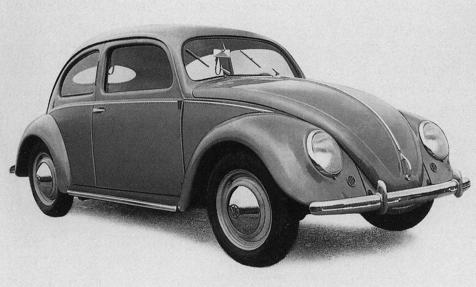

Kamax's October 50 had L11 wheels.
http://www.thesamba.com/vw/forum/viewtopic.php?t=517154&highlight=kamax
It all works on paper.
There's two things we learn from history:
1.) History repeats itself.
2.) We don't learn from history.
noheb
Joined: October 25, 2005
Posts: 168
Location: Denmark, Europe
noheb is offline
PostPosted: Fri Jun 20, 2014 12:44 pm    Post subject: Reply with quote
Kamax wrote he wasn't sure...
Kamax' October 1950 wheels before paint:

PostPosted: Fri Jun 20, 2014 2:48 pm    Post subject: Reply with quote
noheb wrote:
This was clearly lighter than L11.
