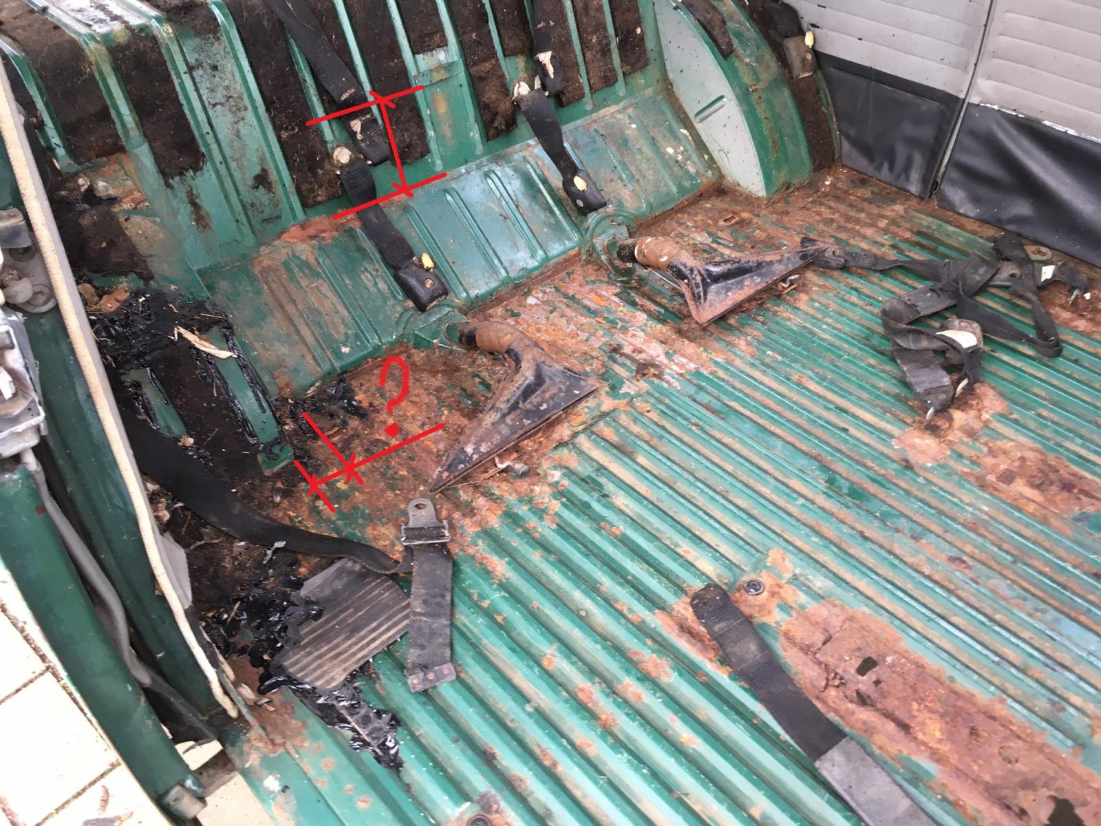

Hello all
i need help to get some measurements for the seat brackets on T2 floorpanel. im going to install seats in a kombi and have got new plates for this, but dont have the measures.
thanks for the help!
i tried to mark up on some pics i found online

The measurements for the middle seat goes as follows
(Taken from a LHD bus)
Drivers side wall to first mount
3" 3/4
First mount to second
1' 4" 1/16
Second to third mount
1' 1" 1/2
Third to fourth
1' 4"
3rd mount to riser between front seats
1' 7" 7/8
I'm not sure what you are asking for on the rear seat
