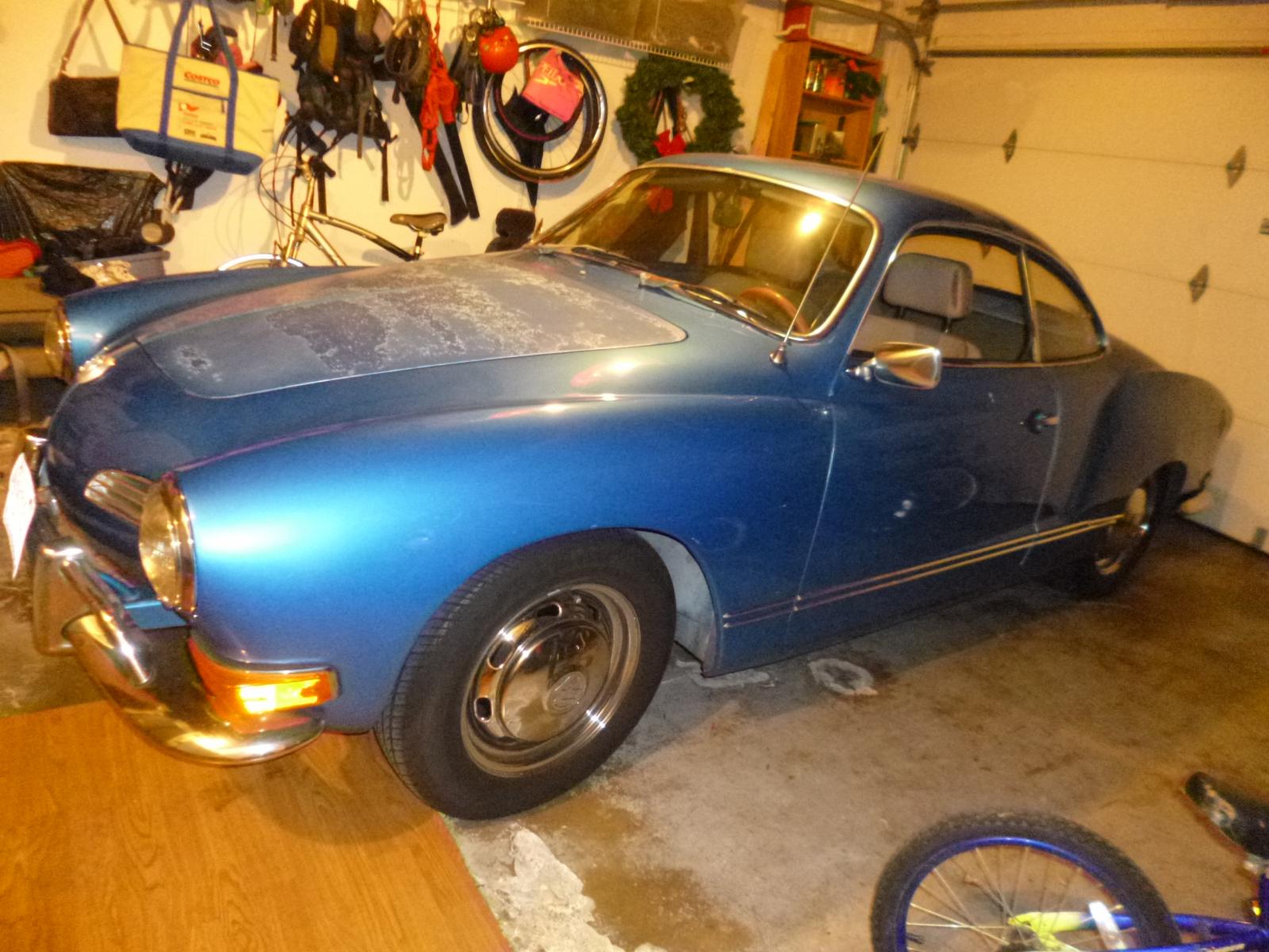

The hypothesis
An average joe is able to perform heater channel, lower fender, and rocker replacement.
How this hypothesis will be tested
I'm gonna try it!
How this is different from all the other threads on heater channel replacement
Hopefully this will be more detailed and complete than existing threads. I’m guilty of taking a lot from the Samba without giving back so this is my way of atoning for those sins! The goal is not just to finish the project, but to also document it in detail, in one place, and fill in some information gaps.
I will also try to do this repair in a cost-effective way. I’d like to avoid expensive repro parts and tools so even more detail will probably be necessary to explain what I’m doing.
Possibly, the biggest difference is this…
My qualifications
None. And that’s kinda the point. I’m an average joe. I have no significant restoration or welding experience, nor do I have deep pockets. So I will ask the really really dumb questions that our restoration super heroes here may take for granted but the vast majority of ghia owners may be wondering.
I have a gift for describing things clearly. My really really dumb questions will hopefully follow up with really really clear explanations of how it was resolved. And of course, I will post lots of pics since we’re dealing with areas many of us may not have ever seen.
I lied a little though… although I'm an infant in the Samba world, I’m probably much more mechanical than the average man on the street. I don’t have much formal training in this type of stuff but over my 44 years have figured out how to make and fix plenty of things.
I’ve also been stick welding (SMAW) for a couple years (mainly fixing bicycles for fun) and have a couple welding mentors. And yes, the plan is to stick weld the heater channels and surrounding sheet metal. Don’t flame me yet, I will explain my insanity in a later post.
It’s certainly possible this thread will end abruptly as I tuck my tail between my legs and take this to someone who actually has a clue, but I am willing to take the chance and the worst case is I’m a little less wealthy and a lot more knowledgeable. If you're a bettin' person, at this point, I wouldn't be able to tell you where to put your money Shocked
The plan
Summer-Fall: Drive it around like crazy, enjoying it before it goes up on blocks. Fine tune my stick welding skills. Purchase parts and tools.
Winter: Begin surgery. It will be done body-on.
Spring: Enjoy a solid ghia or... have someone fix all my mistakes.
Final thoughts
This will not be a “here’s what I did” kind of thread. It will be more “here’s what I’m thinking of doing, what do you think” so real-time input will be greatly appreciated.
And since I have a full-time job, 3 little kids, and many commitments less exciting than a ghia, I suspect my progress will be very slow, but hopefully my level of detail in documenting the work will make up for my lack of speed. In the end, hopefully others will be able to follow along and do (or not do) what I did.
It'll be a few months before the real work starts, but I'll share more background leading up to it. Thx for reading!

c21darrel wrote:
Are you going to weld in/on captive nuts for bolting to the shell? Tap the 1/8"?
I wasn't going to go here yet, but since you ask...
Attaching 2"x3" tube to pan
Another downside of the tube option is that there are of course no holes or threads for the pan bolts to go into, whereas I believe the repro channels come with a way to do this. Here's a nice reference of how the channel, pan, and bolts are supposed to fit together, from cseay1.
In answer to the above question, I was not planning to tap. But for those who want to, I've read here that 1/4" thickness would be the way to go. I've also read a few other ideas here, but the below is new to me and I think we have our first AWESOME tip...
ScottDoonan wrote:
this company and fasteners are a very good, safe, and economical option to blind hole threads/bolts. http://www.cardinalcomponents.com/images/C845%20Rivnut%20Tool%20Manual.pdf
Here's a quick snapshot of this thing. Looking at how this is supposed to work on the right side of this picture, this seems like a very elegant solution. Seems to work like a rivet gun and the idea is to have the thread end up inside the tube. I think this will be option 1. Thank you!
1971 Ghia coupe. Assume I know nothing and you'll be pretty darn close to the truth.
