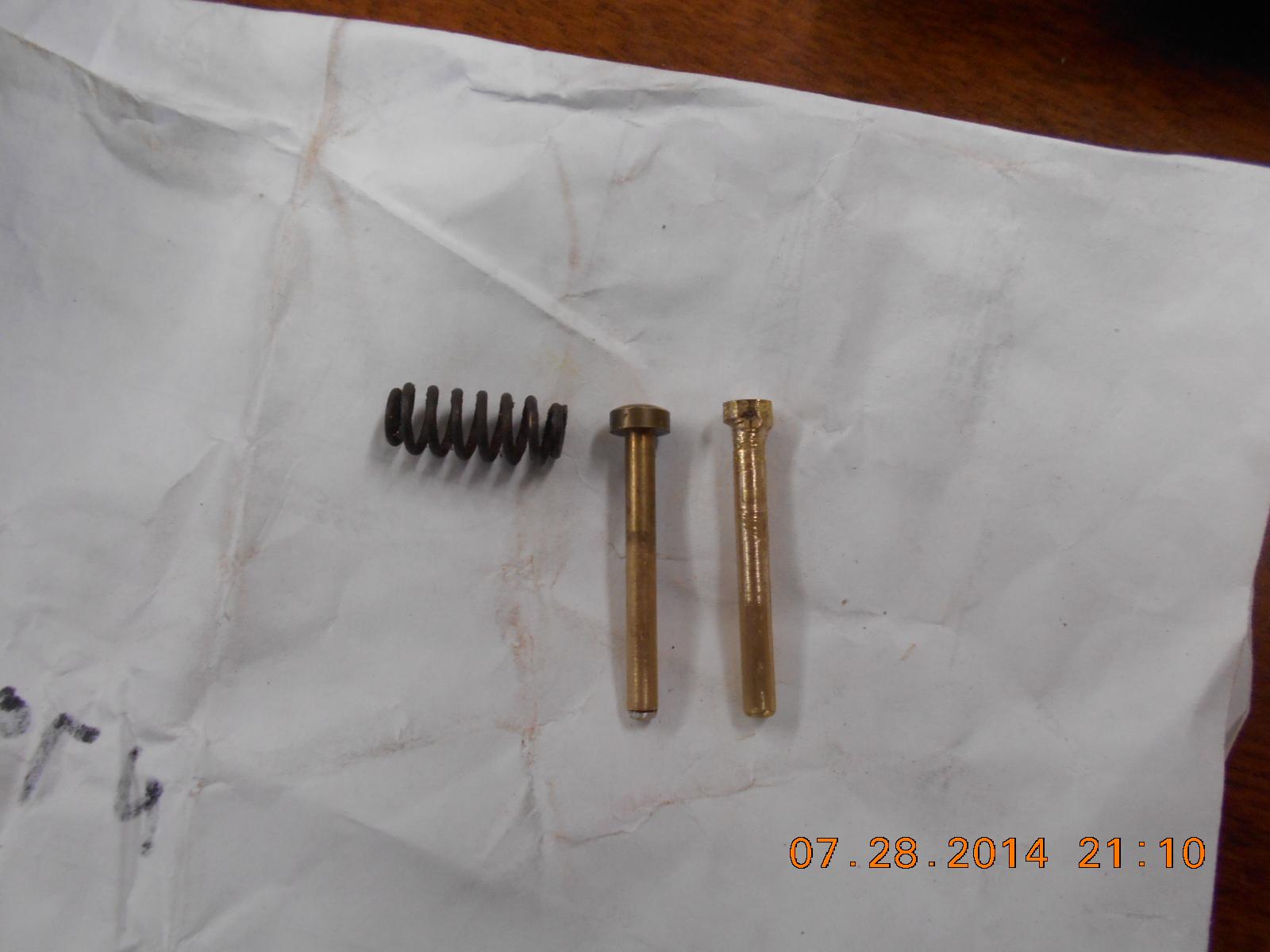

Im going to try to make something, 1/8 solid brass mig rod. Mushroom the head a bit, very close, may have to widen hole a few thousands but we shall see. Im gona pic up some rod later this week.
If it works Ill post a pic of the new next to old.

PostPosted: Mon Jul 28, 2014 2:17 pm    Post subject: Reply with quote
it fits, now to find an equal spring.
1/8 brass mig rod. fits fine and works great with stock spring
