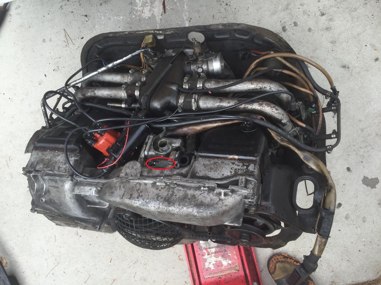

Some Pics
She's freeeeeee.....
Very Dirty, will be getting a much needed bath and fresh paint.

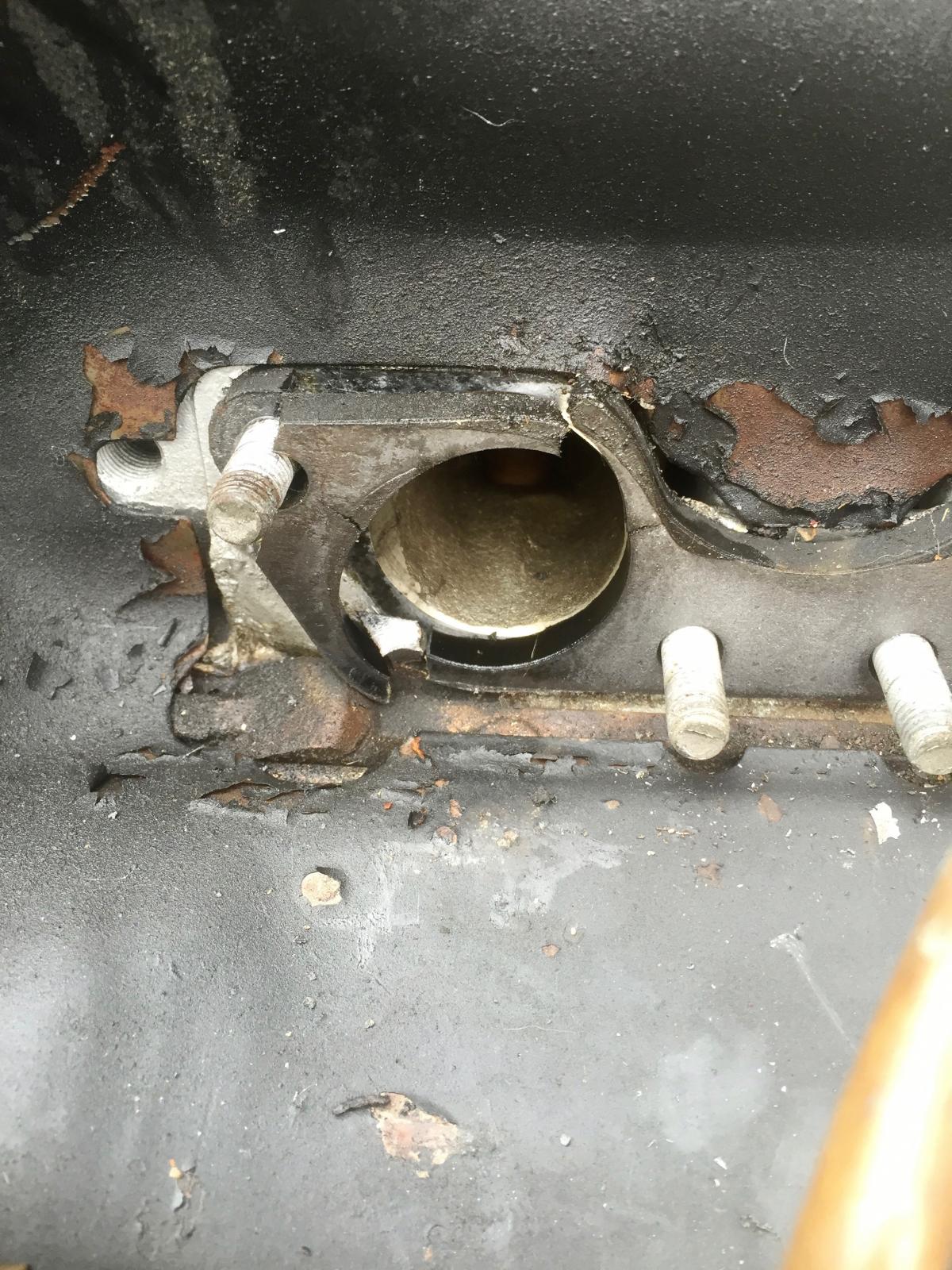

Bad intake gasket...I'm sure it was leaking

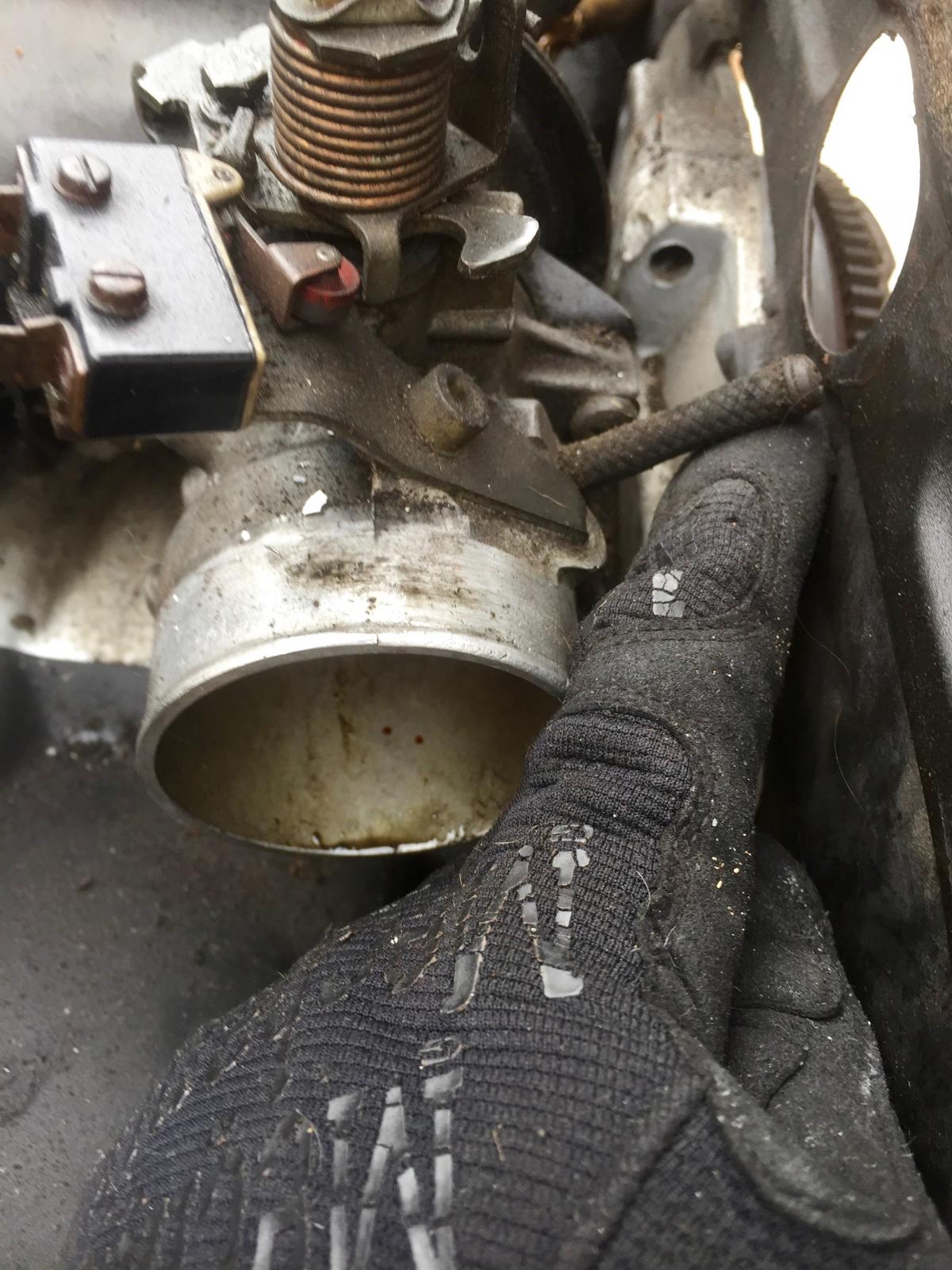

Two questions here: first, where would this vacuum line connect to? and second, what is the switch for on top of the throttle body? There were no wire connecting to it.

What are the numbers located on the engine. I do not remember seeing a breather like the one you have.
Vacuum lines
https://www.thesamba.com/vw/gallery/pix/930637.jpg
Micro switch
http://www.thesamba.com/vw/forum/viewtopic.php?t=380803&start=0
Broken fuel injector connectors
http://www.jbugs.com/product/037906240.html
https://www.airheadparts.com/vintage-vw-parts/vana...-037906240
Vanagon engine.

Tcash, engine number

That's the shroud number, what's on the top of the case down between the shroud and that breather tower?
The shroud fan cover could be off a different engine.
What is this number.

TCash - pulled this photo from classifieds as could not find one in the gallery otherwise. This one is a CV 80 - 83 Vanagon case. Considering he is in California in the LA Basin it will be interesting to see how the exhaust bolts up for smog purposes - whether they bolted oval port or square port heads and exhaust on it. Also if it is a California or Federal model.

They are schooling me and Yes they are talking about your engine. The breather is that black thing with the hat on it that SGKent just posted.
It is different on a bus engine.
It looks like Someone put a Vanagon engine in your bus.

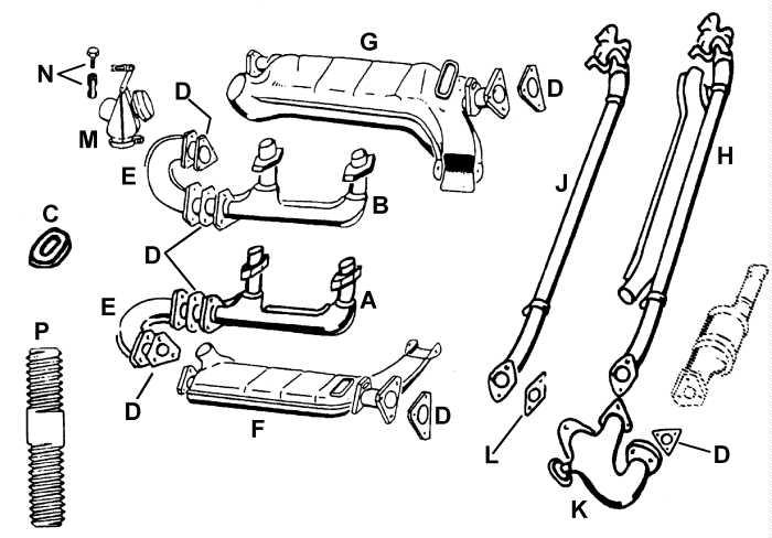

What exhaust do you have?
http://www.oldvolkshome.com/2exh7279.htm

vanagon case..... Very Happy
