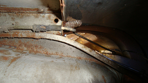

An experience I had recently got me thinking about the logistics of how the tank fills up and how the fuel travels when the tank is full.
Basically, while on a camping trip (read: miles from home) I had a gas pump fail to shut off resulting in fuel not only splashing out of the filler, but also dripping out of the other side of the bus.
Seems my vapor connection behind the spare tire well was cracked. (new one only lasted 2 summers)
Pic courtesy of Ratwell
Upon getting towed home (after 2 nights in a tent next to a smelly bus) I looked into how gas pumps actually shut off.
https://www.youtube.com/watch?v=TFKOD3KRkZs
Basically, the pump shuts off when the gas reaches the end of the nozzle.
As the nozzle is higher than the majority of the vapor lines, is it safe to say that when you full the tank, the bottom portion of the lines are full too? Just due to gravity?
