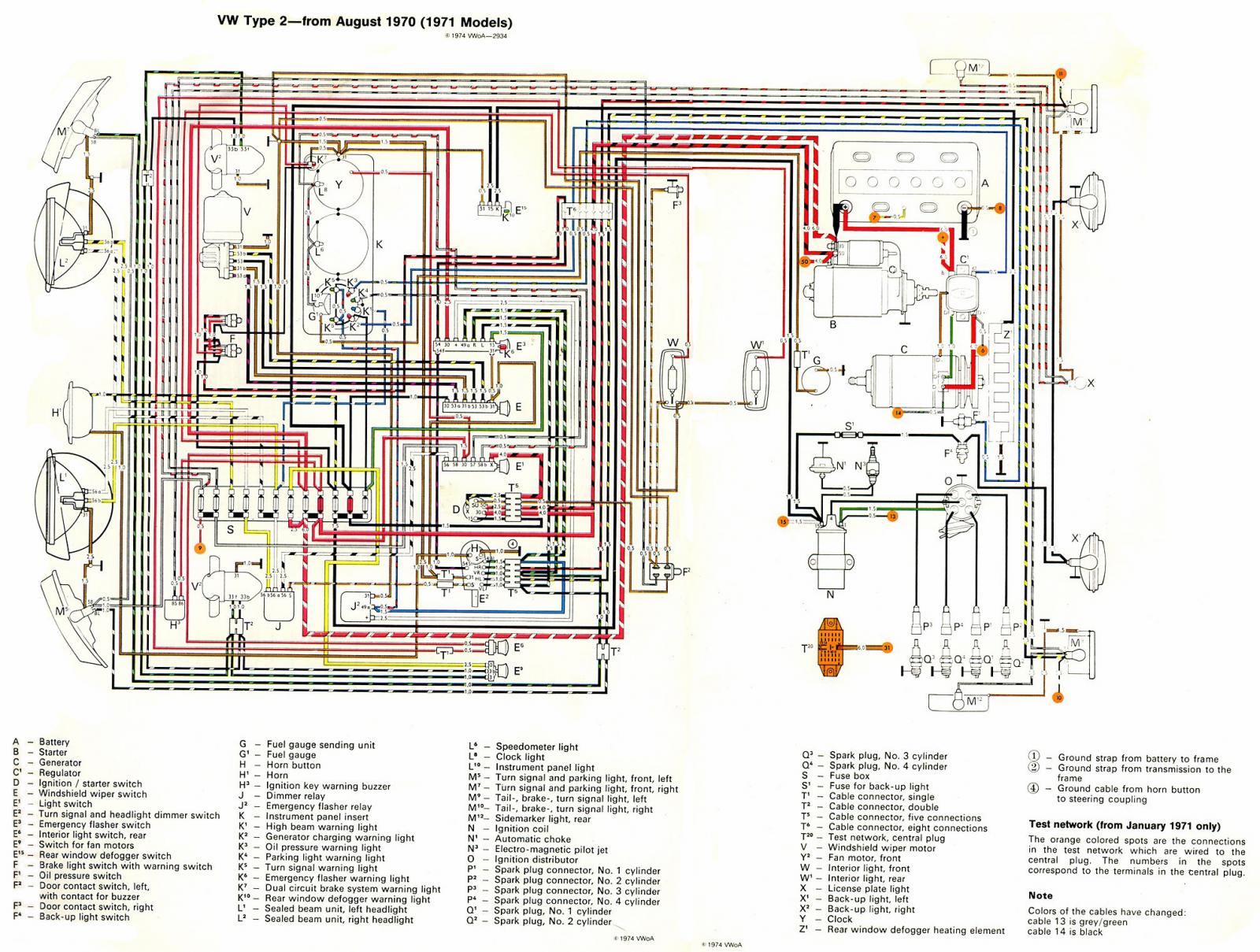

Can someone explain what the posts are for on the 1971 Gauge Cluster.
They are below the Bright Light Warning Light, and the Parking Light Warning Light.
I am thinking they are Ground posts, but can't see it on the wiring diagram.
If ground wires? where should they run to / from?

It is just a pair of ground connections. In the diagram at the "top" of the instrument cluster you can see how the grounds are supposed to run, they are the brown wires.

we have a 1977 so I don't know if this will help or hurt. Ignore the arrow as it addressed a question a long time ago for someone else. The brake light will be different on a 1971 than a 1977 too. We also have an EGR light that you don't. Your dash light wire will also be a different color - mine is yellow but I THINK (and could be wrong) yours is red and gray.
