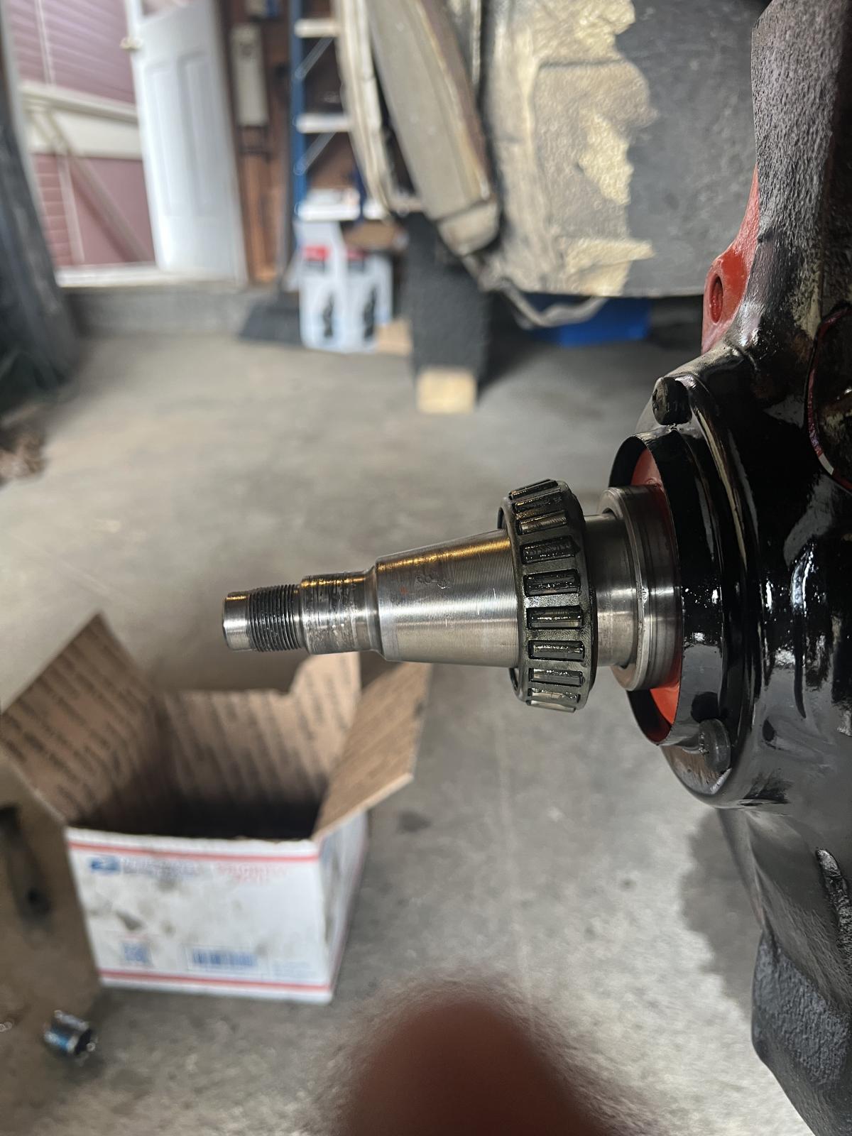

I’ve got a 1985 2WD Vanagon (manufactured 12/84). I’m rebuilding my front end and stuck on a rotor figment issue.
All new rotors and bearings. Rotors and bearings match the measurements of the ones I had before that were operating well but due for replacement. I’ve pressed the bearings and seals into both rotors without issue. When I place the rotor on the spindle though, I don’t have enough of the shaft coming out of the front (through the putter bearing) to put my nut on.
This makes me think it’s not seated on the spindle correctly. When I take either my new or old inner bearing and place it on my spindle, it stops at the end of the tapered portion of the spindle. Is that correct? Or should it go all the way to the end?
Rotors are ATE brand from the brake kit here: https://vancafe.com/1980-85-2wd-front-brake-kit/
When I take the rotor off the spindle, it leaves behind the seal and inner bearing stuck on the spindle. If I place the rotor back on the spindle (with the seal and inner bearing in hand), it seems to fit fine, leaving plenty of thread for my nut.
Any help would be much appreciated!

your inner bearing should go all the way on.

Welp. This one’s on me.
For future reference: It took several tries to seat the rotor on the spindle. I had to reinsert the inner bearing and seal each time. The spindle OD and inner bearing ID are super tight so it’s a tricky fit.

The inner bearing is an easy slip fit on the spindle. No hammers!

PostPosted: Wed Jun 29, 2022 9:43 pm    Post subject: Re: Front rotor replacement, not fitting on spindle Reply with quote
Take a bastard file and run it around the spindle to see if there are any high spots where the inner bearing race is supposed to fit.
Prob best to post some pics of why that bearing can't slip-fit onto the spindle.
If the old race once fit fine and doesn't now then there has to be a ding on the spindle or something.

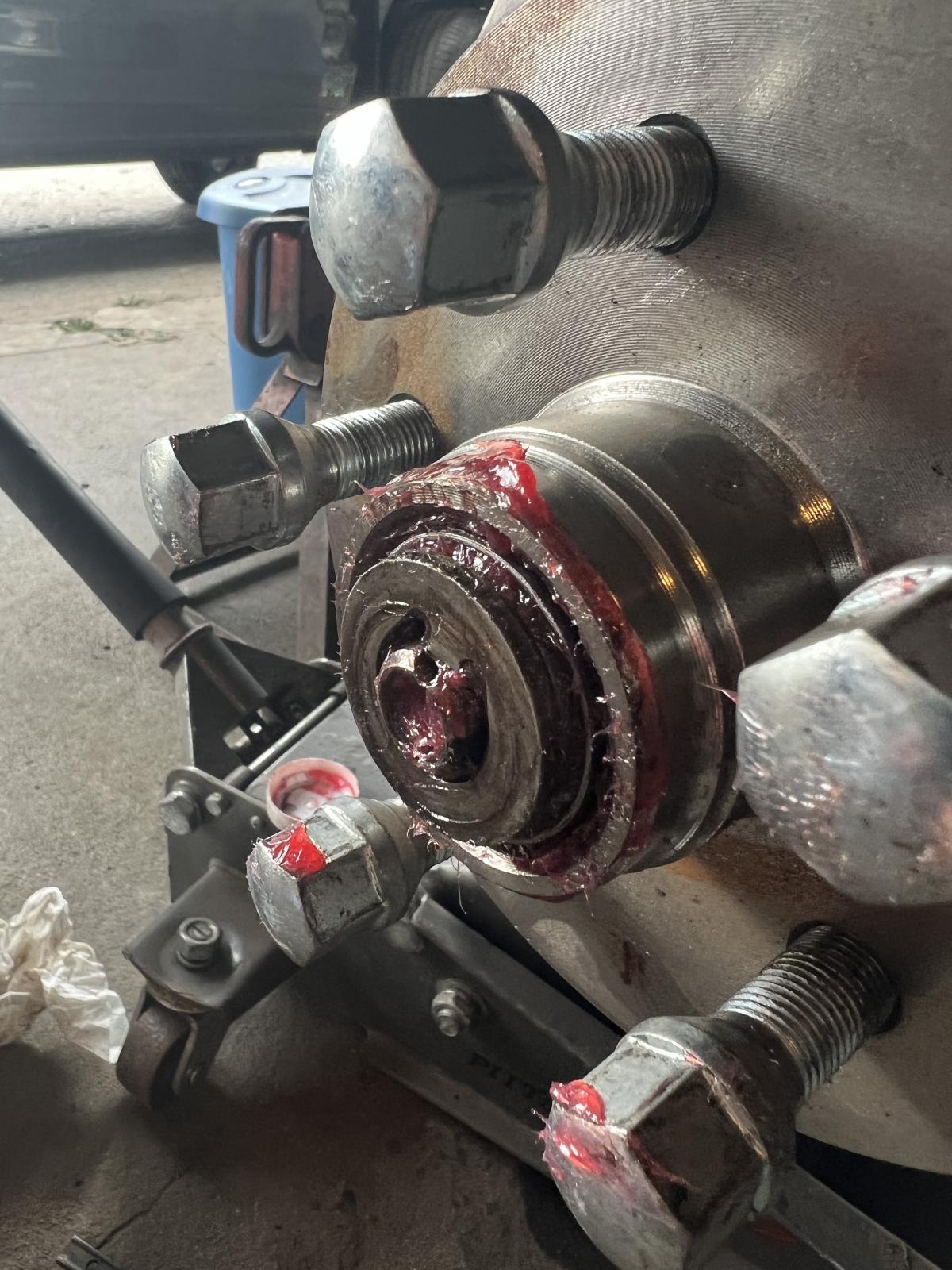

jeremypbeasley wrote:
I spot damages on the snout where the small outer bearing race rides, then about an inch towards the inner side which makes me wonder what happened to this spindle? Also look at the ring where the seal rides, it's got some impact traces on it as well around 2-3 o'clock area. How? These are an indication something happened ...

PostPosted: Thu Jun 30, 2022 2:58 am    Post subject: Re: Front rotor replacement, not fitting on spindle Reply with quote
just replaced mine also on my type 3, it is supposed to slide on completely without any problems or hammering, what make/type are the bearings? Did the other side go on without any problems?
