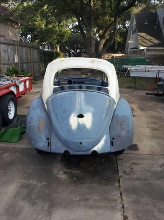

I picked up this 1959 De Luxe Sedan early this year and trailered her home. She has been covered in my backyard shed waiting for me to start on her. Since I bought her, I knew that the ragtop had been grafted and ordered her birth certificate to find out more detail on her. BC finally arrived today!
She was born 3/6/1959 as a VW De Luxe Sedan in L335 Capri (Blue) with Leatherette Blue Grey Upholstery + M350 US-equipment. She was shipped on 3/11/1959 to San Antonio, Texas.
The pan and body have matching numbers and the engine is the one she came out with according to the letter sent by the Stiftung AutoMuseum Volkswagen.
The previous owner had her for about 10 years and mentioned he had gotten her from someone in Lubbock TX. So it sounds like she has always been a Texan.
In the past couple of years I have been buying and selling bugs trying to find the one. I have always named them. When I came across this one, I asked my wife to name her since I thought "this is the one!” She named her "Petunia".

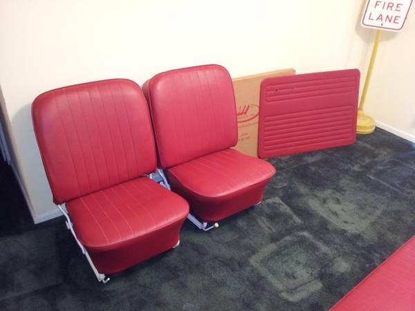

I am very pleased that the original color is L335 Capri. She will be re sprayed original color. The PO had just finished re-covering the seats. He picked red upholstery. I am going to think about which way I want to go with the interior.
My build is going to be somewhere in between OEM and custom. Period correct items are not so important to me. Having a grafted roof would throw all that “keeping it original” away anyway!
I am working on finishing some other projects before I can put my hands on Petunia. Body will come off and I will refurbish the pan and rebuild the engine. When this is done, body will get sprayed.

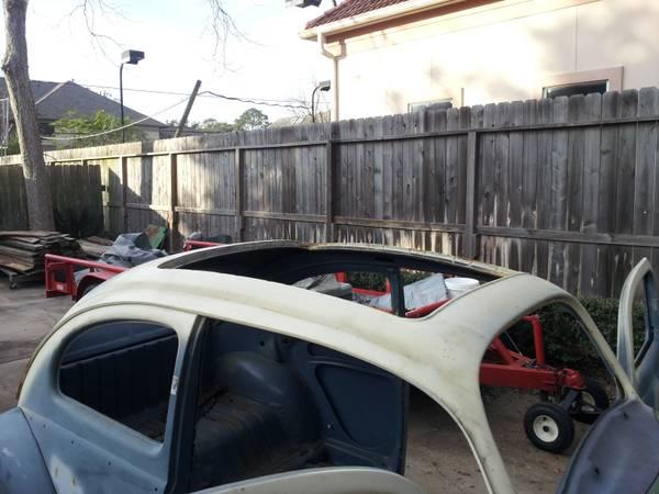

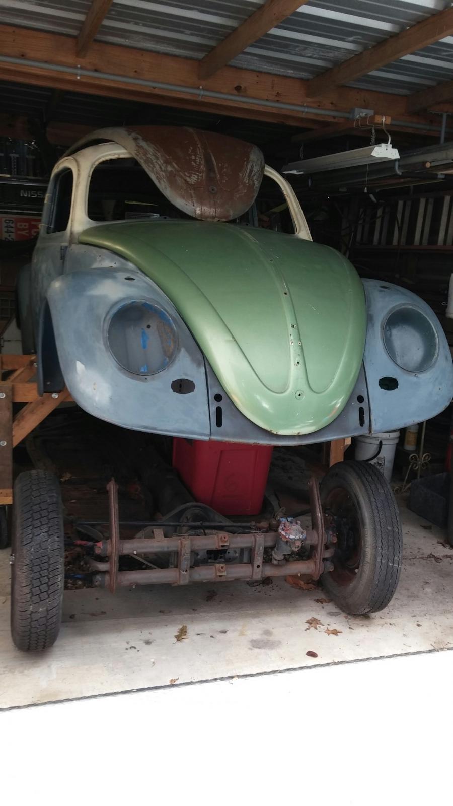

Labor Day weekend was busy and I managed to have some helping hands on lifting the shell off of the pan. Step #1...DONE!

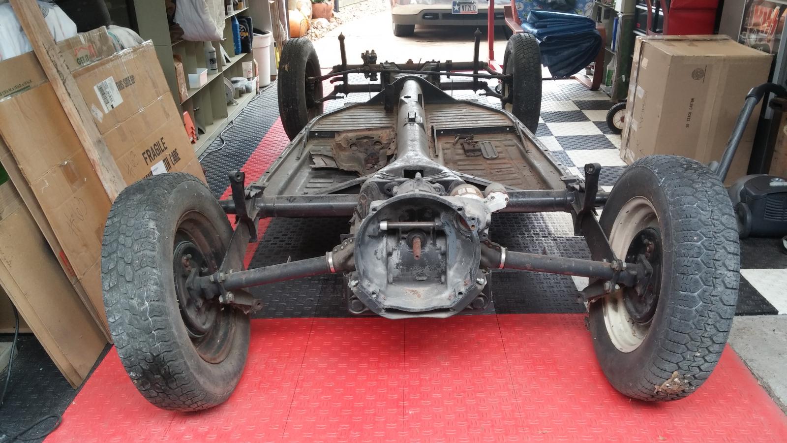

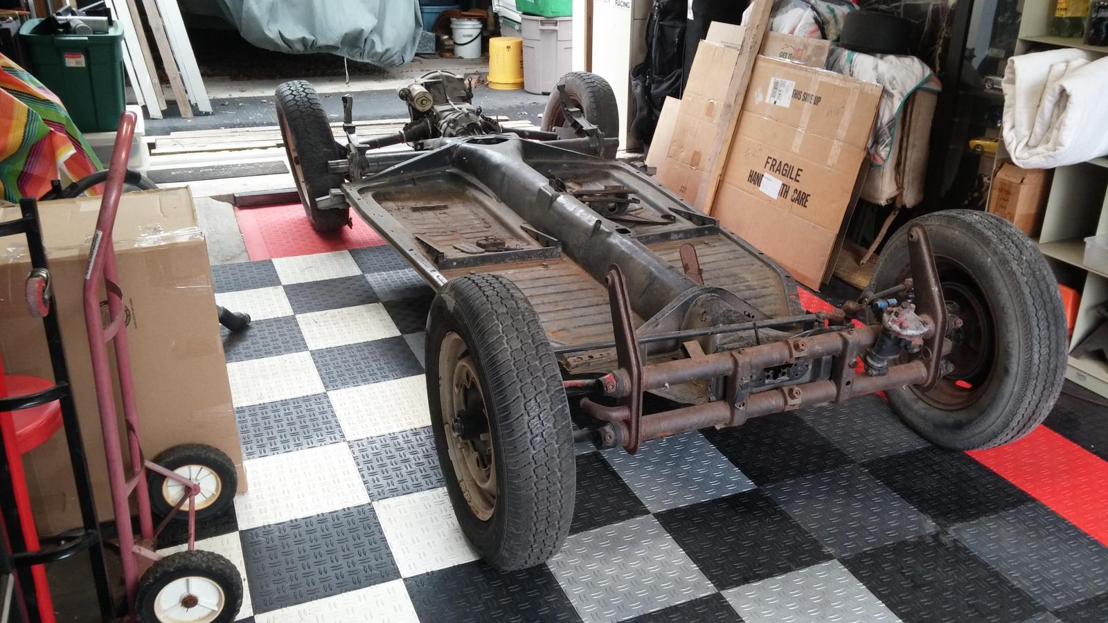

PostPosted: Sat Jan 02, 2016 11:05 pm    Post subject: Re: 1959 Beetle "Petunia" Reply with quote

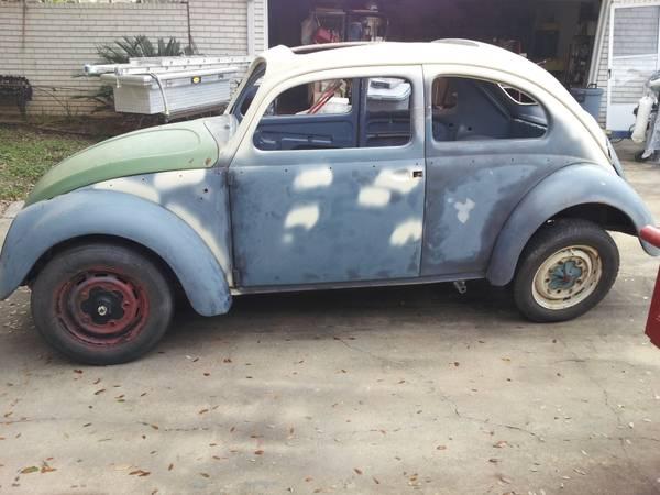

After almost 2 years since bringing her home I finally am getting started with my build. Made room in my garage and rolled the pan in. It will be a slow process but I am happy she is now on the front burner. First I have to assess what has to be done to the pan. Power washing is first in order.
[img]https://www.thesamba.com/vw/gallery/pix/1447090.jpg[/img
[/img]
The plan is to build a daily driver with the original 36 hp engine and paint the body in the original Capri blue. The build is not going to be back to original style since the rag top is grafted. She will be lowered front and back. And I will be performing most if not all the work. I will update as I go and make progress.

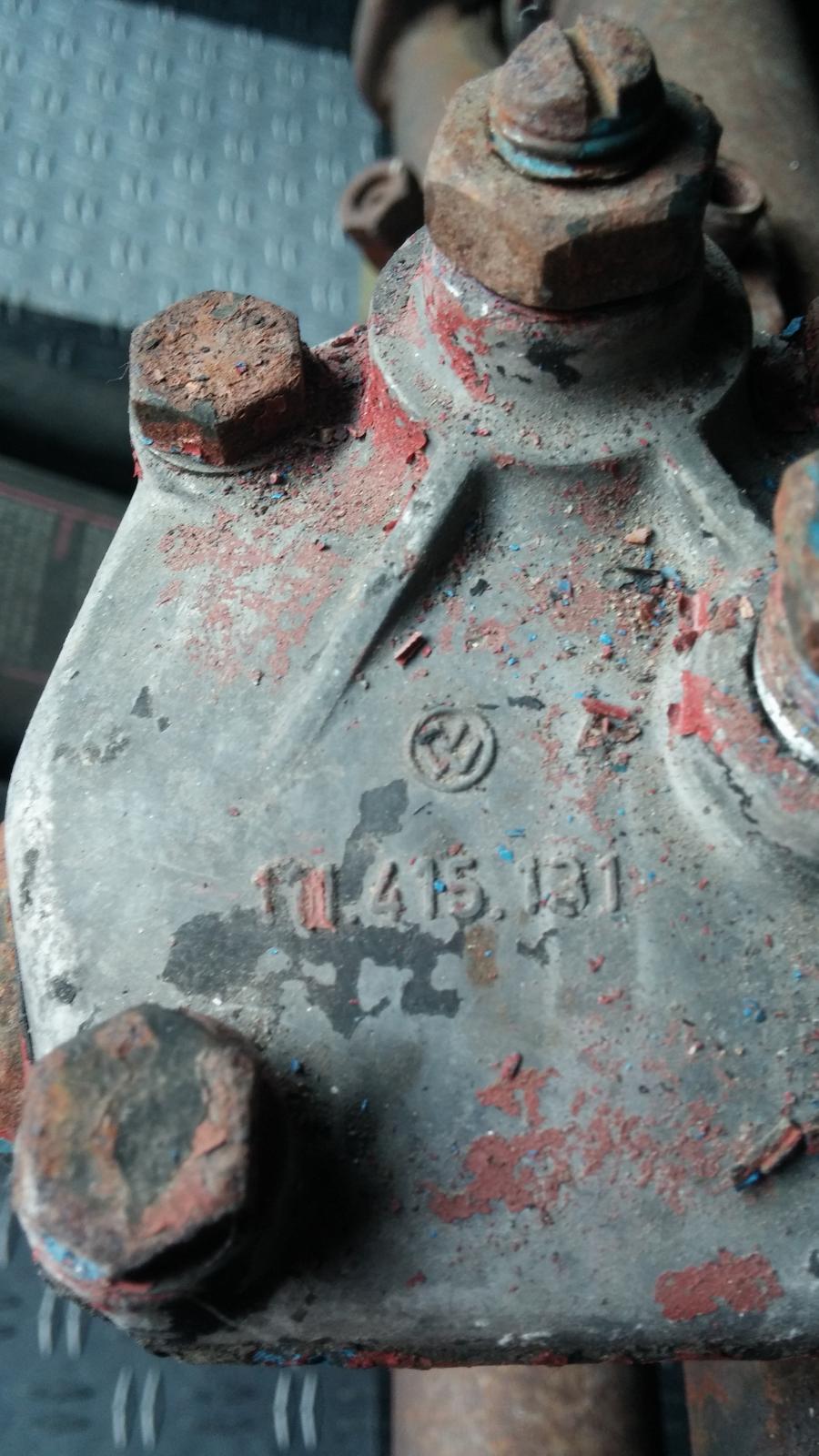

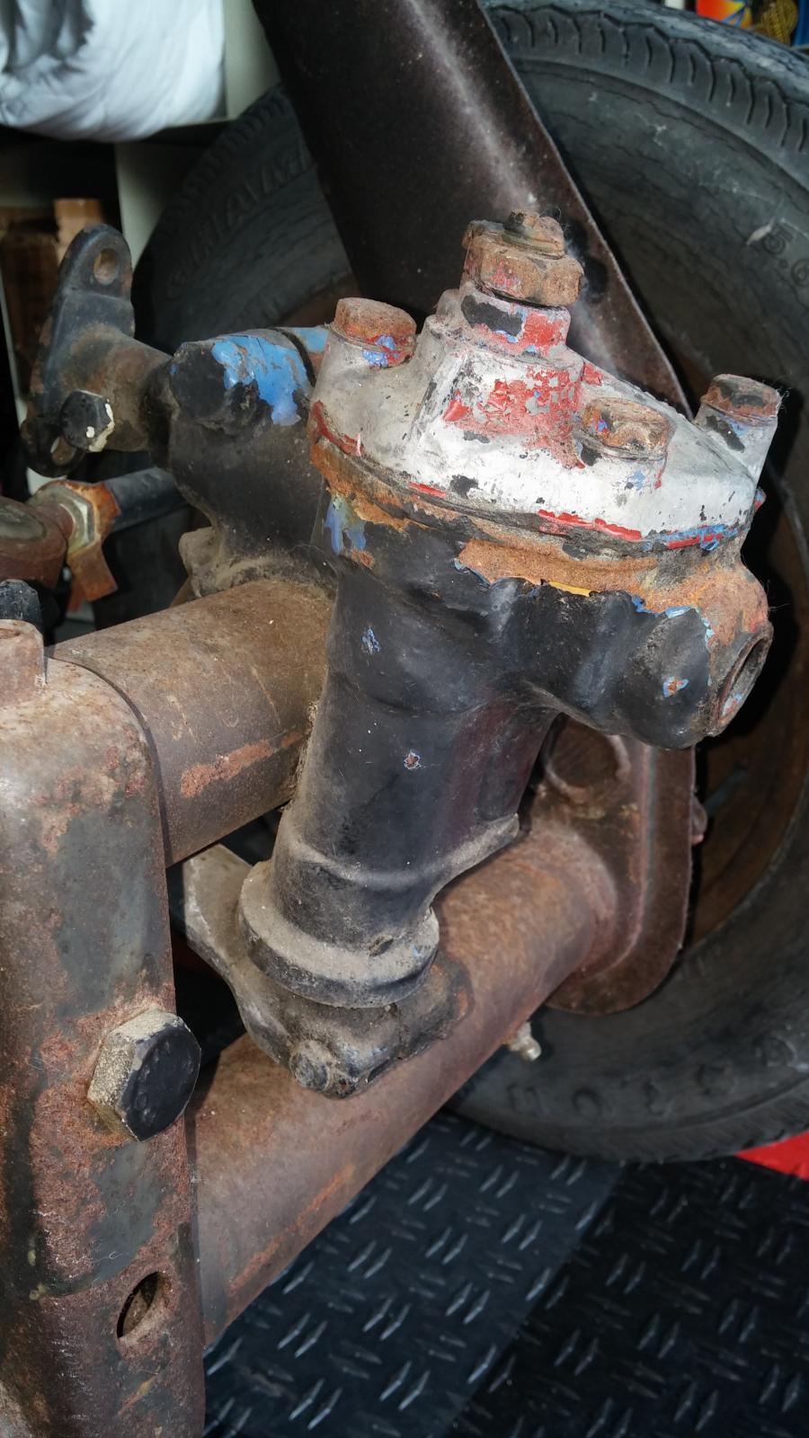

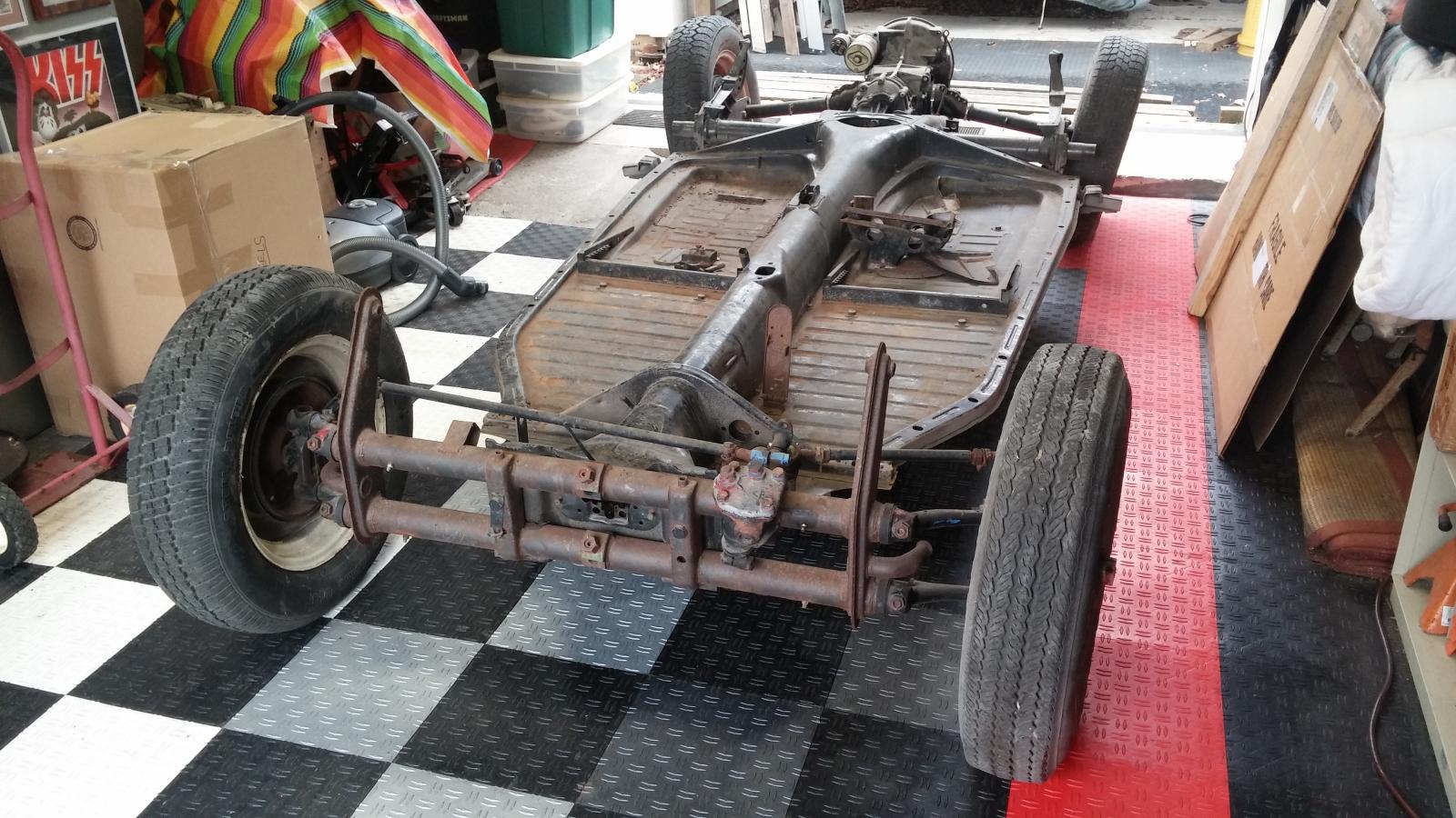

First thing I am coming across is a frozen steering gearbox. I has what I believe to be the original VW#111-415-131 box. I unbolted a plug on the top cover and it looks like it lost all it's lubricant which I think is some sort of 90wt oil and not grease as in the newer TRW boxes.
Any advice on rebuilding this box? Car has not been driven in probably 12 years.
