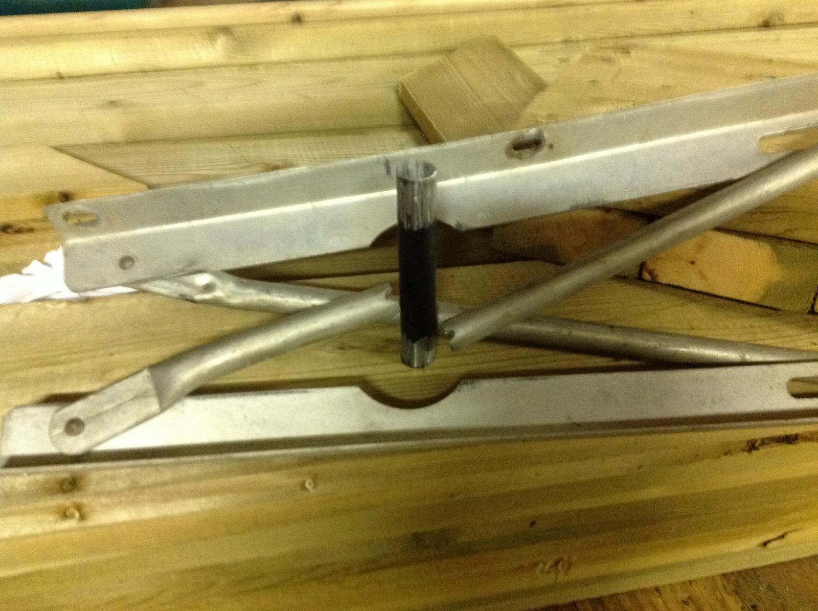

Pop top spacer location and how thick?

PostPosted: Tue Aug 19, 2014 4:34 pm    Post subject: Pop top spacer location and how thick? Reply with quote
http://www.thesamba.com/vw/forum/album_page.php?pi...id=1245766 Sorry if pics don't work haven trouble uploading from ipad.

PostPosted: Tue Aug 19, 2014 4:37 pm    Post subject: Reply with quote
Just wondering if theirs any pics of what it looks like . 1970

PostPosted: Tue Aug 19, 2014 4:45 pm    Post subject: Reply with quote
Well that tube used to be straight and it had a plastic washer between the tubes and a bolt or rivet through the pivot point.

PostPosted: Tue Aug 19, 2014 5:01 pm    Post subject: The fix deck railing Reply with quote
http://www.thesamba.com/vw/forum/album_page.php?pic_id=1245783

PostPosted: Tue Aug 19, 2014 5:04 pm    Post subject: Reply with quote
Pice of black tubular deck railing slips over perfect albeit a little thin weld er up and see I guess. Can't find any parts out here lol.
If you click on the forum code box at the top left of the pic when it's showing in your gallery you can copy that code and paste it here to show the pic. Just what are you doing there?

PostPosted: Wed Aug 20, 2014 12:37 pm    Post subject: Reply with quote
Reading what BusDaddy said, I'm thinking you might not want to close the top with that sleeve on there, might bend the bars.

PostPosted: Wed Aug 20, 2014 3:59 pm    Post subject: Reply with quote
Although they do fit the used part of "good used" they don't measure up in the good department so much, someones been trying to mash a sleeping bag or something up in the front of the pop top when they were closing it much like Samm1's, not quite so far gone but still less than perfect.
Are you welding in that sleeve to replace the damaged section of tube Samm?

PostPosted: Wed Aug 20, 2014 4:18 pm    Post subject: Reply with quote
I repaired my '72 top hinge with a sleeved over piece of tubing and it worked great. I did have all the bits and pieces. will post a photo tomorrow night.

PostPosted: Wed Aug 20, 2014 7:04 pm    Post subject: Reply with quote
Yes I cut a piece of deck rail tubing and sliped it over the broken tube then welded it in place. Did both sides and now the canvass is nice and tight now. Top opens and closes excellent. The only piece of hardware missing now is the little piece of steel mounted to the top of the bus above the rear view mirror,the pivot point . Two holes are there but it's missing. Not sure where to find one or even if you can still get them other than at a wreckers.
