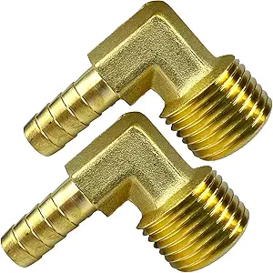

025121058M 2.1 "Peace Pipe" coolant hose - better solution

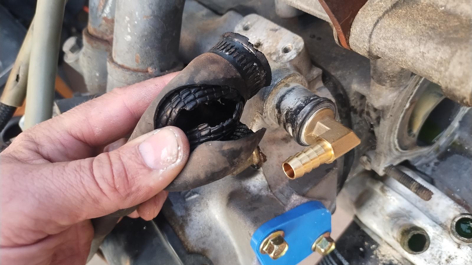

This coolant hose has cost me an engine and has caused trouble for others.
It is a specific/funky hose with two different size ends and a close bend that sits under the AC compressor. Basically if it fails there isn't a simple solution

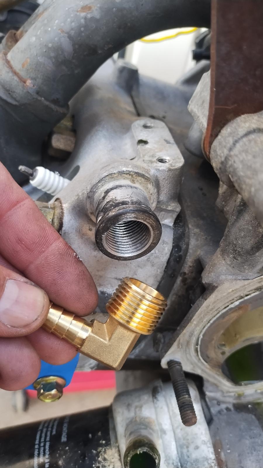

On this thread tencentlife wrote about a permanent solution here https://www.thesamba.com/vw/forum/viewtopic.php?p=10254133#10254133
"As to permanent fixes, those 1" hose nipples on the cyl heads can be tapped to 1/2" FPT, the nipple ID is ready for a 1/2" NPT pipe tap without drilling."
Thanks tencentlife/Chris!
Here's how I did it. Notice the shop vac blowing in the thermostat hole. It pushed out the aluminum shavings.

Very nice!
An elegant, easy, & reversible fix that I haven't seen documented here before that solves a vexing Vanagon design problem, lots of great pictures and text/info, and a descriptive title.
This has it all! Thanks for posting this!

wow! i hadn't seen that mod before. congrats to Chris for the idea and Andy for pulling it off so well. gonna do that on an engine i have in the stand. this is great!

Likewise, beautiful mod…well done!
Not having seen this before, I recently sprung for the GW option (although haven’t installed yet):
https://gowesty.com/products/aluminum-coolant-elbo...6748276901
Your rig is much more elegant and keeps the original 2 clamp configuration (vs. 4 for the GW).

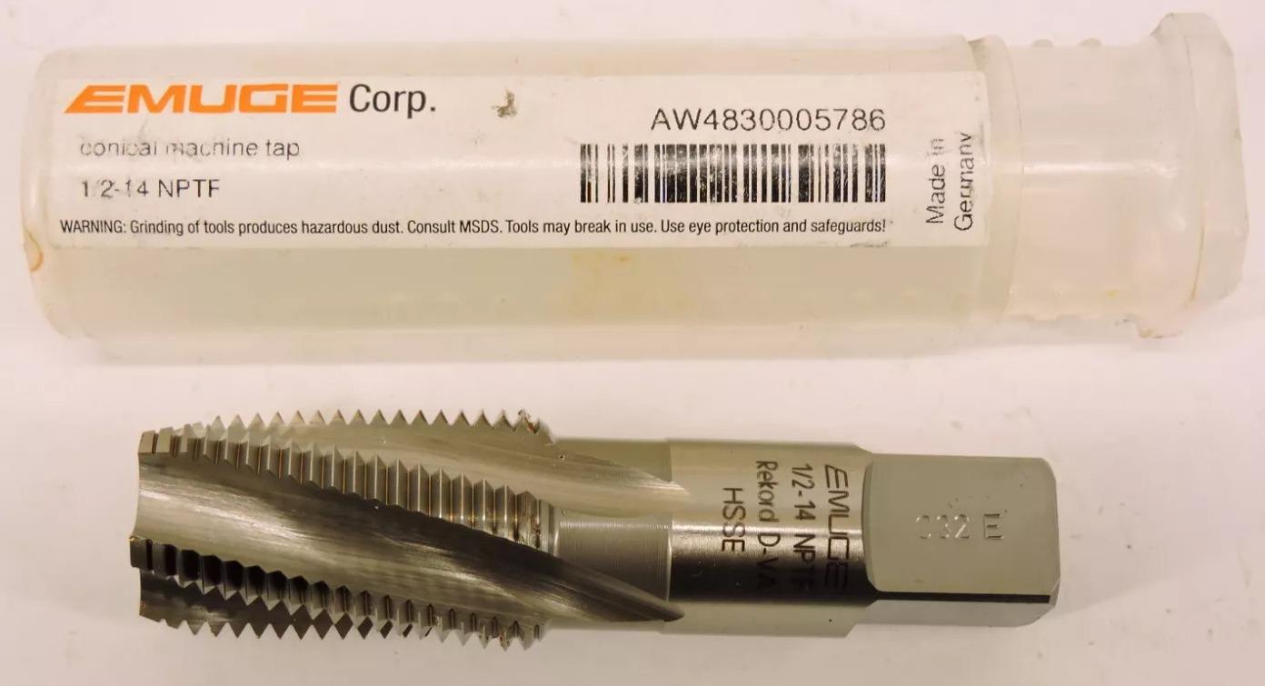

Tap - Since its aluminum and one is unlikly going to be doing many of these any cheap tap will work. Amazon is a good source.
I got this kit but unless you are a plumber a single tap buy might make sense
$20 same day delivery - https://www.amazon.com/dp/B0C7Z51KGS?ref=ppx_yo2ov_dt_b_fed_asin_title
single $7 https://www.amazon.com/Jalja-NPT-Pipe-Tap-Precisio...6&th=1
Kit 50% off $9 - https://www.amazon.com/Precision-Accurate-Threadin...90o41_ld-N

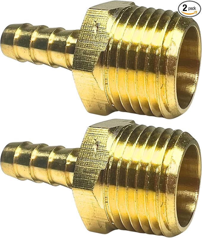

the fitting is 3/8. 3/8 was easy to find and fit the other end of the peace pipe hose so I figure a hose would be easy to find to go between this 3/8 and the coolant rail
2 for $9 - https://www.amazon.com/dp/B0C4B6HSPP?ref=ppx_yo2ov_dt_b_fed_asin_title&th=1
Amazon offers 5 for $12 but I couldn't see using the other 3.

…the fitting is 3/8…
…3/8 was easy to find and fit the other end of the peace pipe hose so I figure a hose would be easy to find to go between this 3/8 and the coolant rail…

I’m sure you’re correct (and I’m sorry to be “that guy”), but why then does “everyone else”
i.e. 10¢, markswagen, djkeev, etc… call for 5/16” barb & hose…???
#curious.just.asking

i looked at tap options, from $6.99 ones, to $15 Irwin ones to $240 Emuge ones that machinists love.
did a bunch of 1" and 1.25" NPT stuff on a friend's ground source heat pump and had several leaks from the Chinese fittings despite liberal use of a high quality pipe dope and more torque than should have been needed. had to re-apply dope and re-tighten a few to crazy stupid levels. so, not wanting to split the head outlet, i decided to go quality and found a NEW Emuge 1/2" NPT tap for $40. zooming in on the cutting threads on the Emuge, they are simply beautiful machining compared to the rough cutters on the cheapos. $25 more than the Irwin but, like Loreal, "I'm worth it". actually, just want to do this once on the heads i modify having just suffered insufferable NPT fittings.
the observant will notice this is an NPTF tap... designed to seal without sealant. since NPT threaded parts require sealing compounds, it is acceptable to use an NPTF tap for NPT applications.

the 5/16 is probably the "best" fit but I couldn't find a one-piece solution 90deg for that I liked. 3/8 seems to fit so went with that since I didn't want to piece together fittings.
If you're stuck on 5/16 ...
Here's a straight solution. there's likely enough room for the thin hose to bend around.
https://www.amazon.com/Brass-Fitting-Adapter-CX-WO...Y&th=1

Interesting -
1) coolant is 15pst vs. domestic 25-80psi. Lower pressure is less likely to leak
2) I've had good luck with cheap taps, YMMV
3) for a one-time use cost is a factor
4) most plumbing work uses the die (female cutting tool for male pipe) to fit pipes. What did you tap (male cutting tool to make female fittings) in that project?
