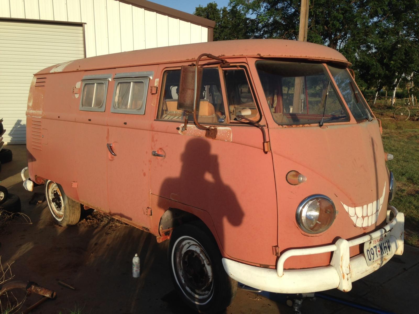

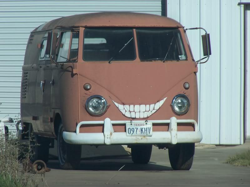

I've had a few requests to start a thread on my bus, so I figured I would post up. I finally purchased this thing about a month ago but I'll go ahead and fill in the history.
This goes back to when I was barely 16yrs old. I was leaving my buddy's house one day and while cruising down the road I glanced over to a side street and saw a beautiful BG/SWR '63 15 window Deluxe sitting in this dude's driveway. It was a "holy shit" moment to me because I had never really seen many Splits around my parts, let alone a nice OG paint Deluxe bus like this. Anyways I pulled over and talked to the owner a bit while admiring his bus. He had pulled it out of a barn a year prior and was finishing up things to get it rolling again. After a while, he mentioned he ran across a bullet nose panel outside of town and told me I should look into it. He told me the directions but they were pretty hazy at the time. I ended up tracking him down weeks later at his job and he took the time to draw me a map of the location. I felt like Indiana Jones or something, setting out to hunt down this obscure unicorn of a vehicle in my eyes. As a friend and I found ourselves rubbernecking, we finally ran across it. She was a photographer and happened to have her camera with her. These are the pictures we took the day I found it, I believe late September of 2006.
I headed back a few days later to inquire about it, I had some cash stashed away and figured I would try my luck. I was pretty young at the time and nervous about how it might go down. I pulled up and walked up to the house and knocked. This HUGE dude answered and after I told him I was curious about the bus he told me “He’s out back by the pond” (the owner). I started to trek back towards the pond behind the property, but as I started to get closer I noticed he was holding a rifle. I thought this is getting sketchy, luckily it turned out he was shooting gophers. I asked him about it and he told me “it belonged to his girlfriend…it’s in bad shape…I don’t think I will ever do anything to it…no drive to…but no it’s not for sale right now.” I just told him thanks for his time and headed out.
The years rolled by and I would always cruise past it every so often wondering if I could ever buy it. I probably drove past it a hundred times over the years, but I never stopped. And it never moved, not even an inch. Recently I was planning on going back and trying again, but I’ve been deep in a Model A Hot Rod build and was focusing on that. About a month ago I was browsing the local classifieds and noticed an ad for some old scooters. Not really sure why I looked at it, but after further inspection it was the bus owner. I remembered his name and knew the address. I figured NOW was the time to ask again before someone else ran across it. I felt like I should be the next care taker. I gave him a ring and setup a time like I wanted to look at his scooters. It was wild how this happened since I was planning on contacting him again. How much bigger of an open window could there have been? As we were walking towards his scooters I told him what was up and who I was. He didn’t remember me or anything but he wasn’t opposed to selling the bus this time. I checked it out and gave him an offer and he took it. I paid him on the spot, took the title and drove away with my mind blown.

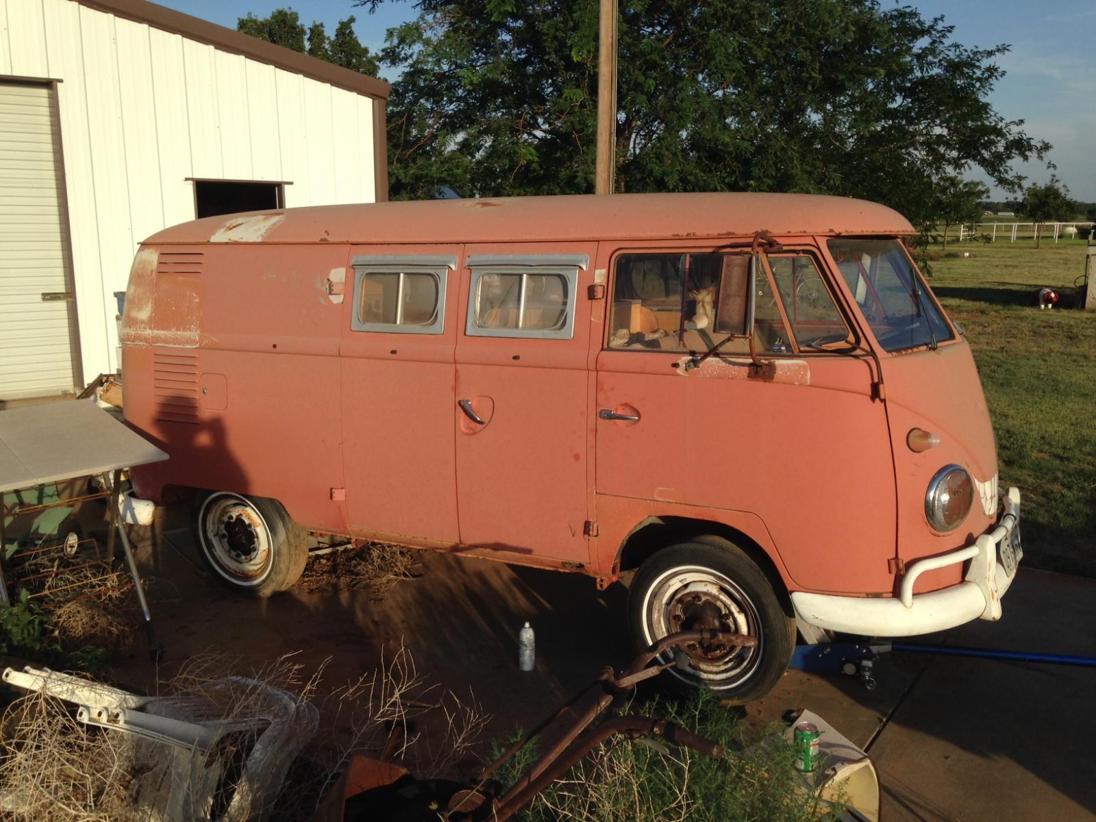

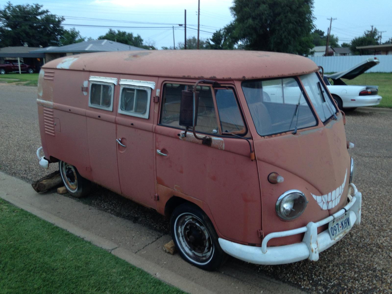

I came back a few days later to get it ready to transport. I knew the wheels were all frozen, he even mentioned this back in ’06. I brought about $30 worth of PB Blaster/Deep Creep and various tools. I started soaking and pounding the drums over and over until I finally had most of them free. I bought a nice drum puller after the drivers side front drum just wouldn’t budge. I ended up pulling the guts out of the front brakes. It was a blast really; I didn’t ever think I would be working on this bus while destroying his driveway with penetrating fluid and grease.

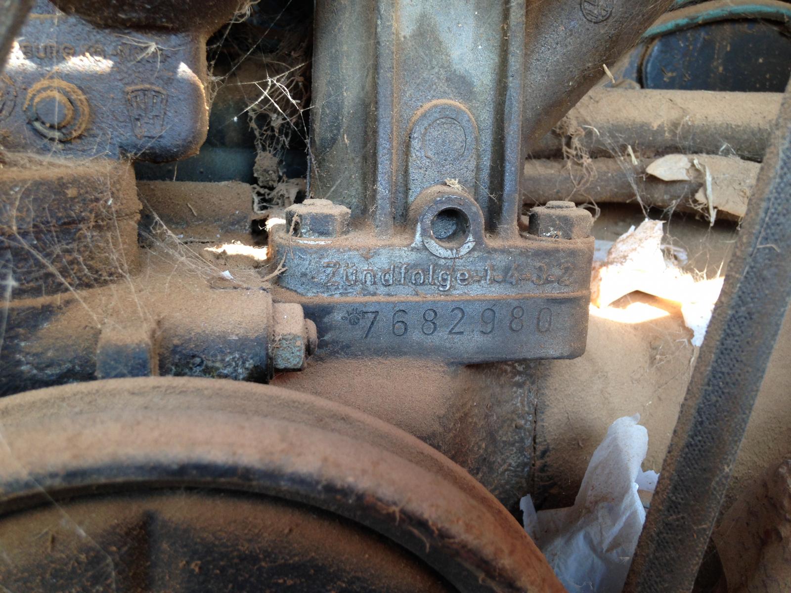

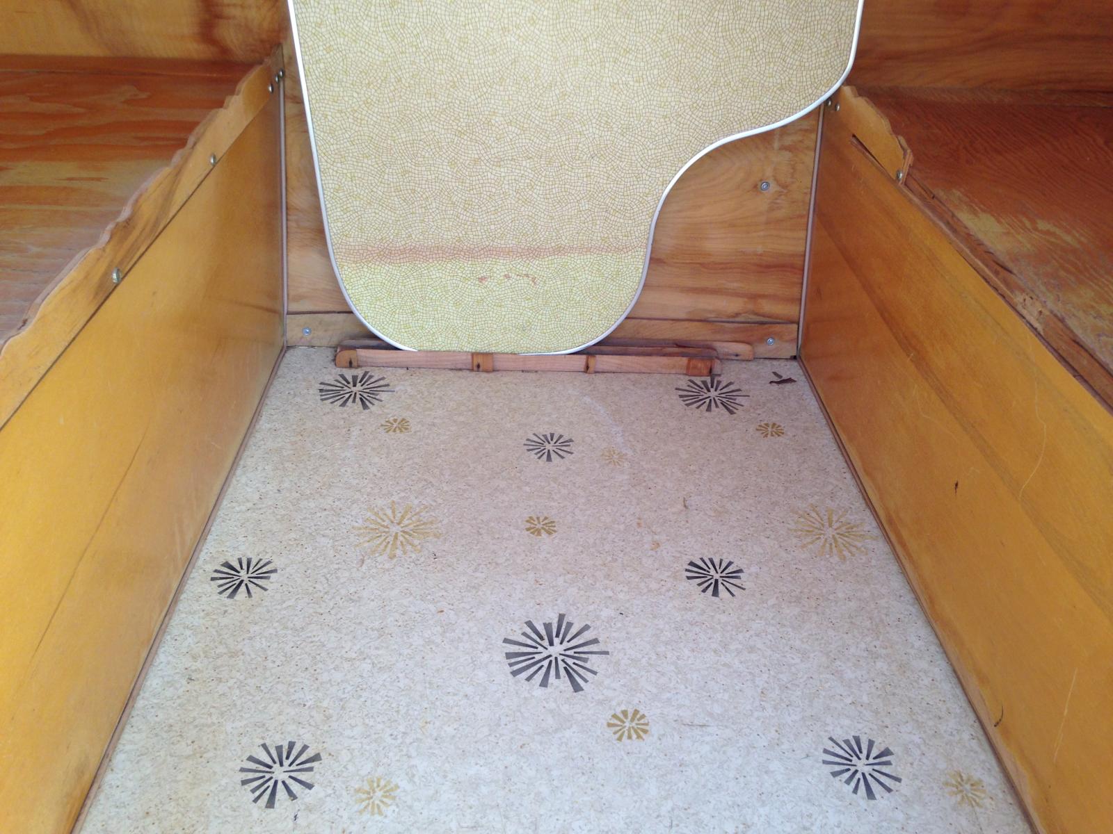

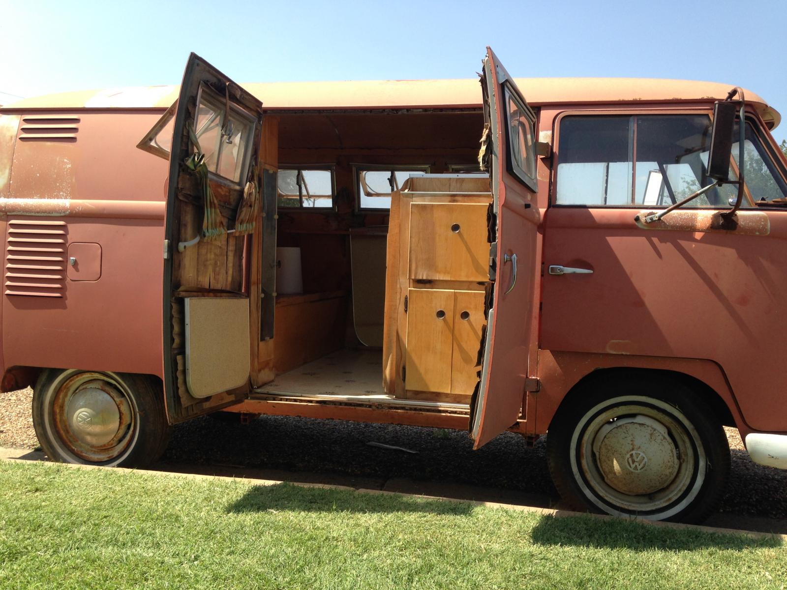

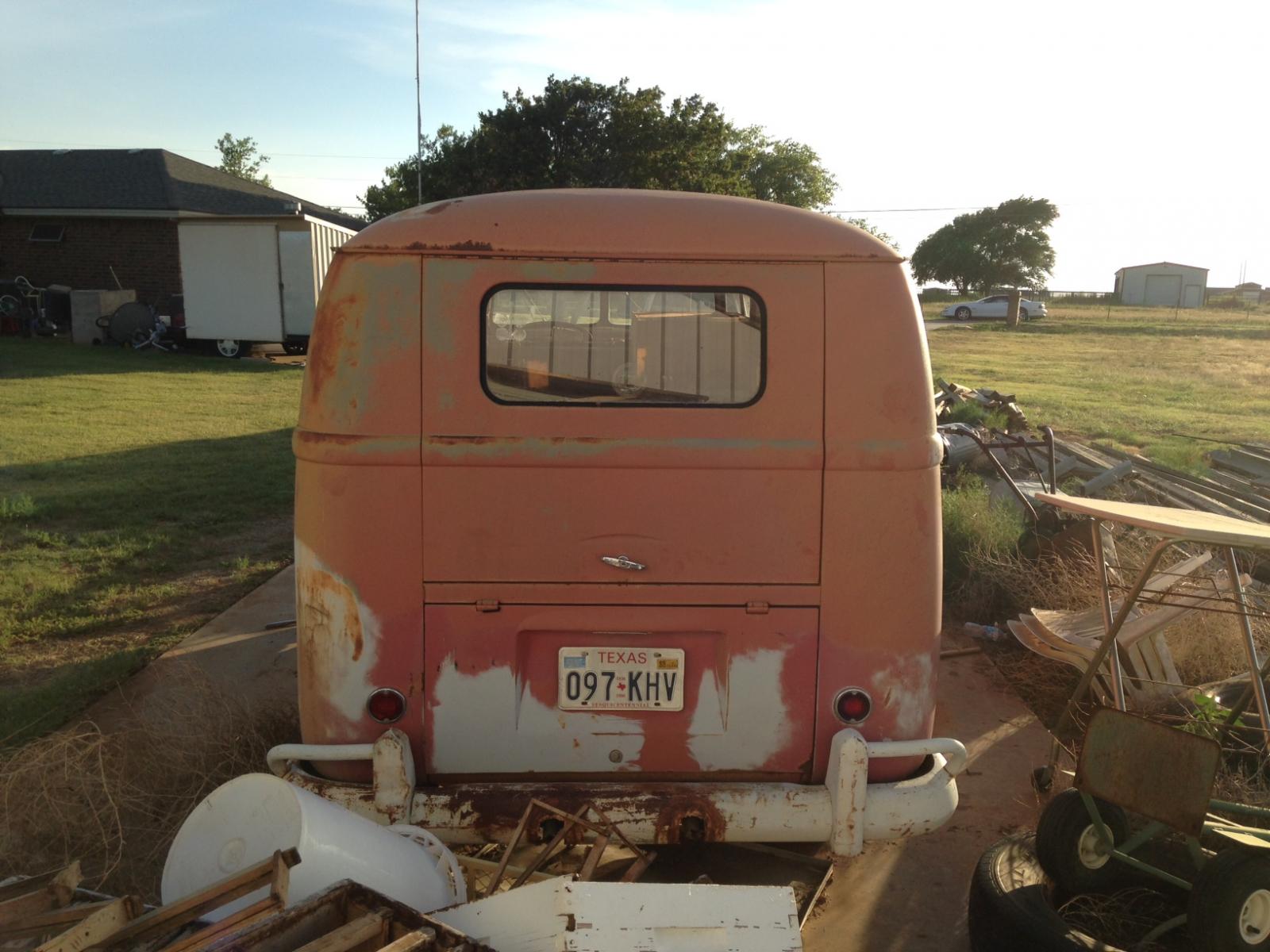

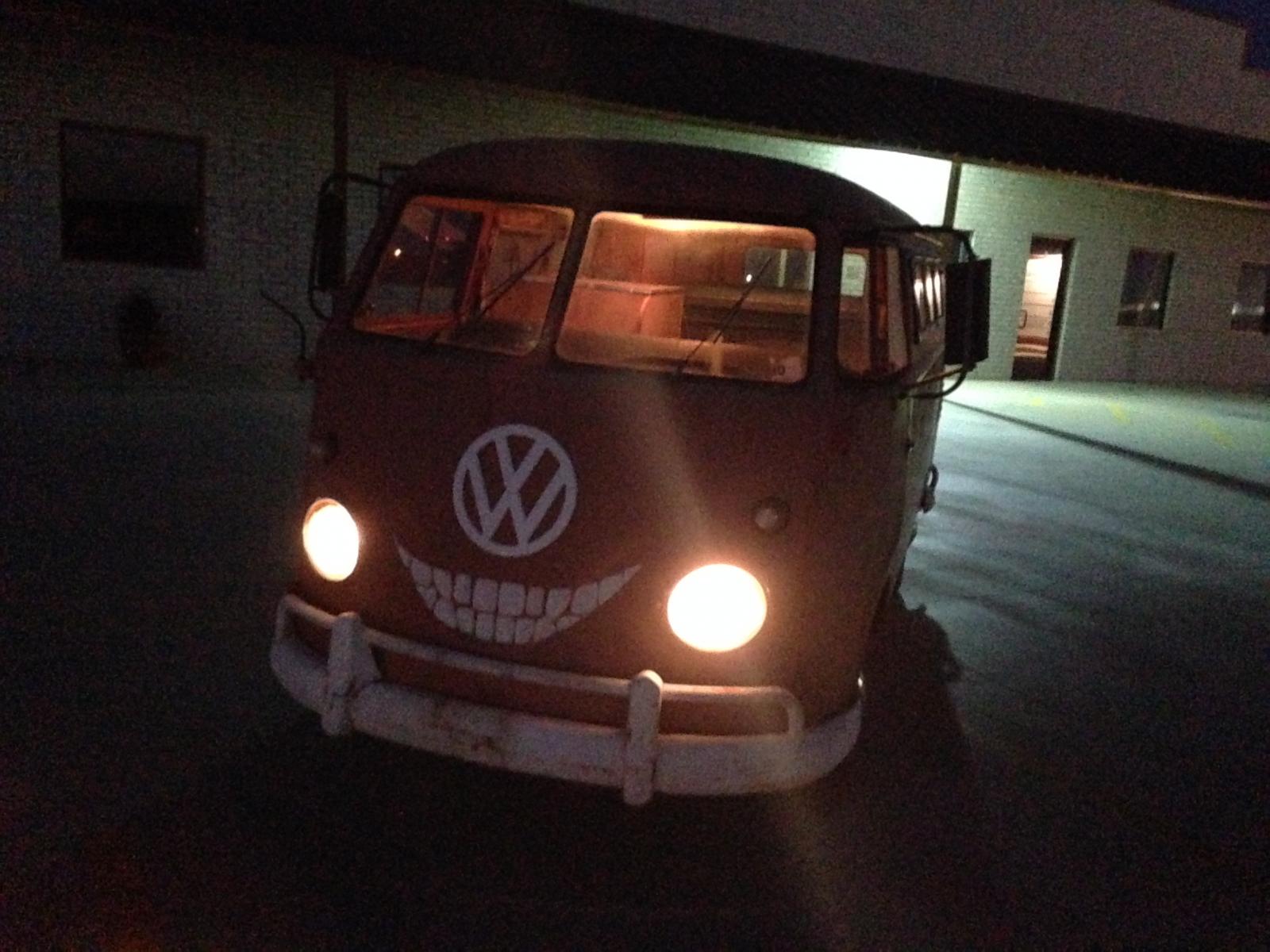

The Bus was originally bought new for a local pharmacy. They painted the teeth and it has some faint eyelashes painted above the headlights. Shortly after that his girlfriend’s parents purchased it and it was taken to Juarez Mexico to have the camper kit installed. It was driven all over and the original engine blew up around San Francisco. I guess they sourced a ’63 fresh air 40hp from a Beetle and used that to keep going. The apron and rear bumper was torched to clear the pea shooters and some wire supports the oil bath air cleaner since the triangle is missing.

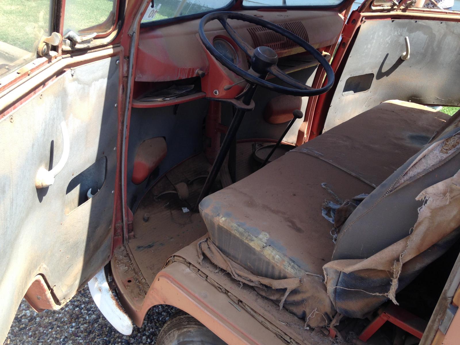

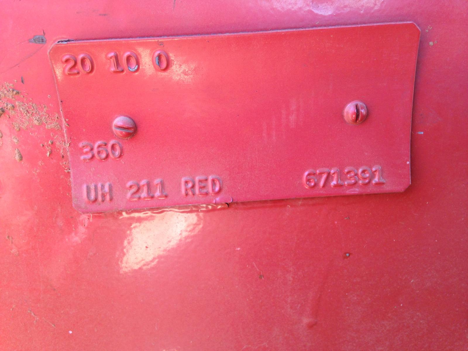

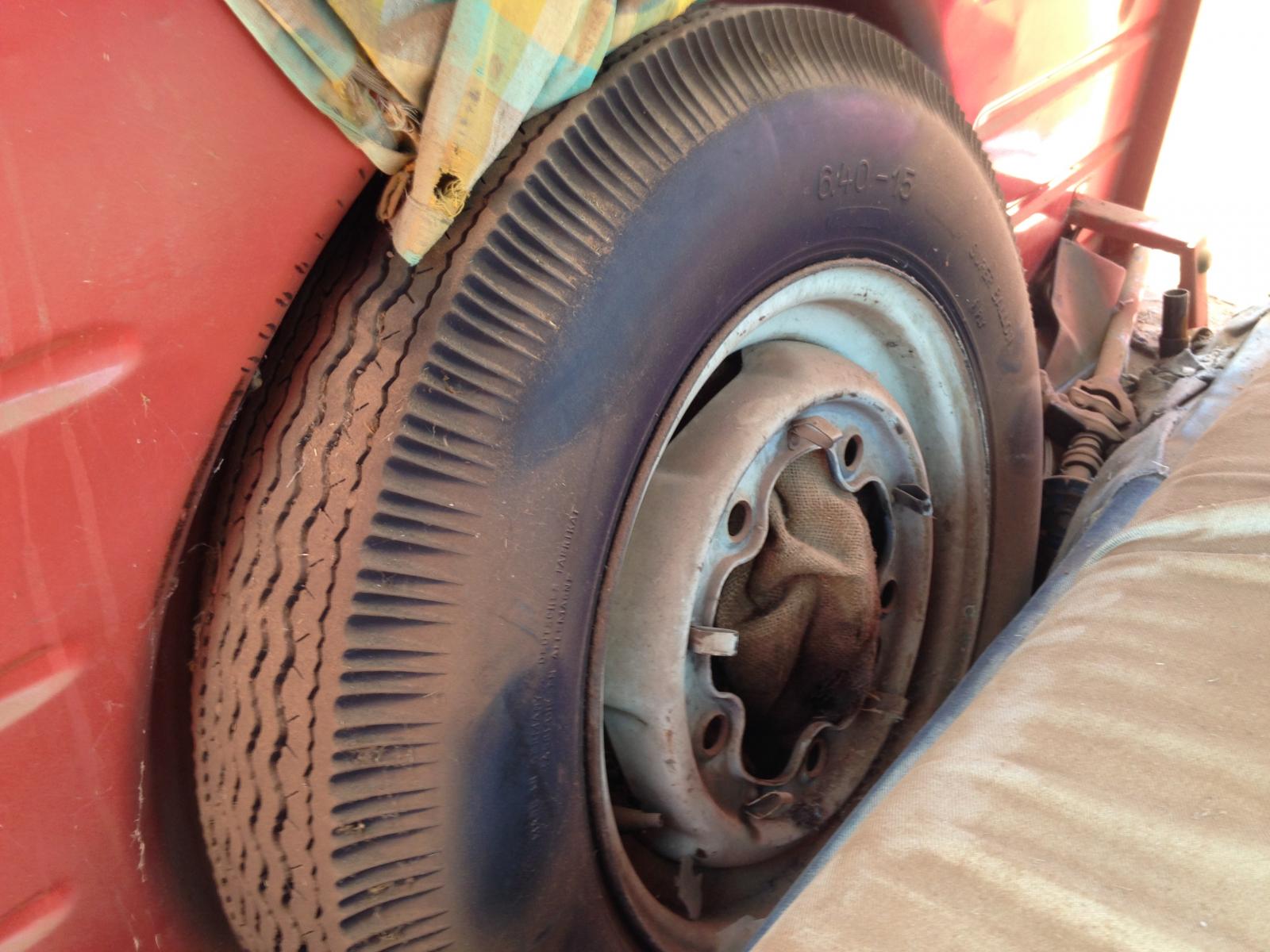

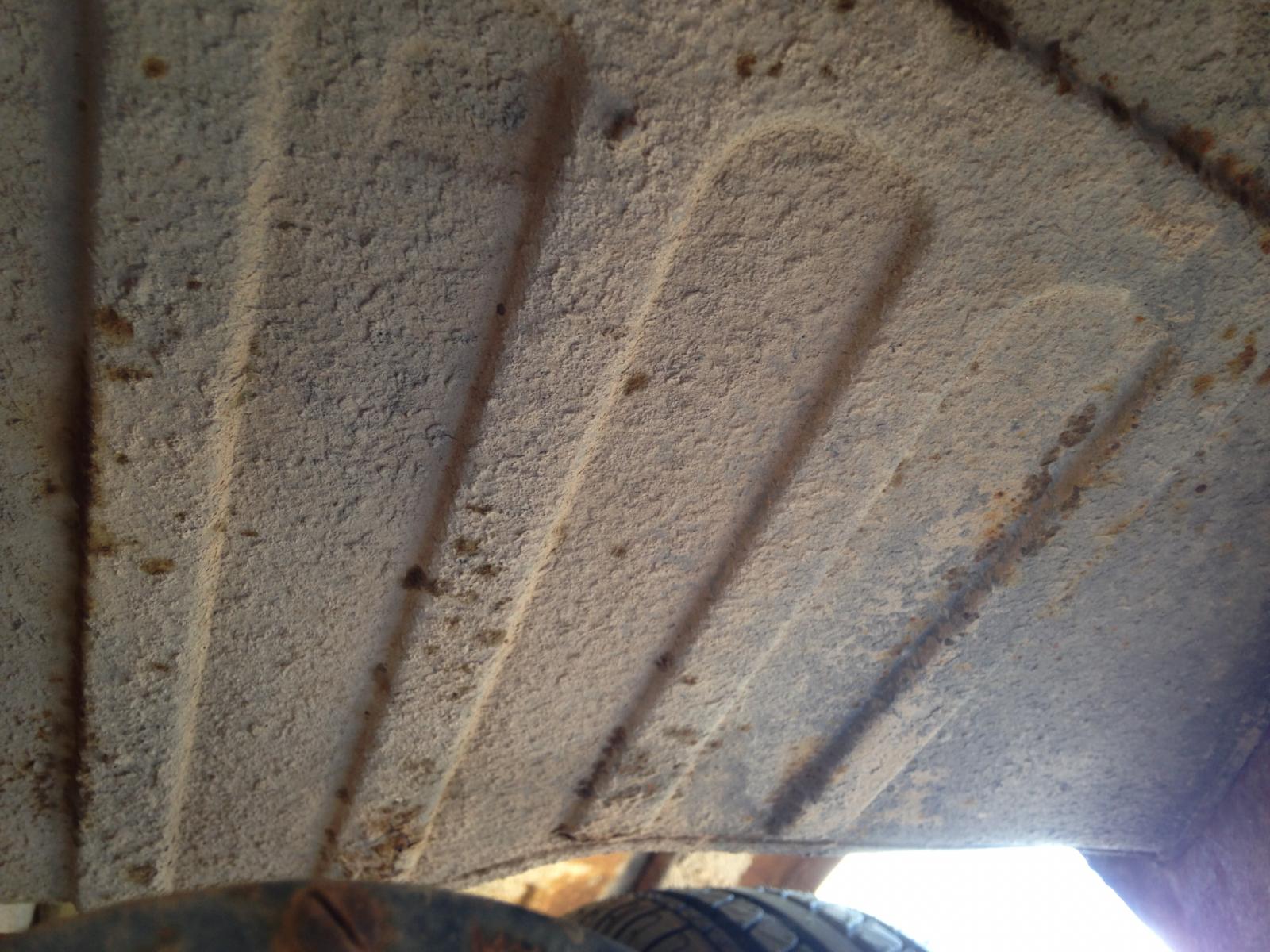

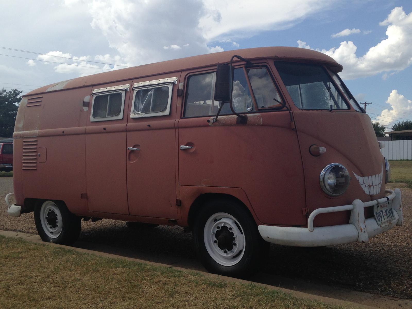

After I moved it I started to clean it up and check things out. Super rust free, it has a few spots on the rockers. 81k on the clock, original spare, tool kit, jack.

Nice that you were able to get it after all the years passed.
G-wood Todd
Joined: January 11, 2005
Posts: 1047
Location: Colorado
G-wood Todd is offline
PostPosted: Sun Aug 24, 2014 7:29 pm    Post subject: Reply with quote
It was destined to be your bus after all these years. It looks like it should be easy to get back on the road. It'll look sweet all buffed out. Have fun.

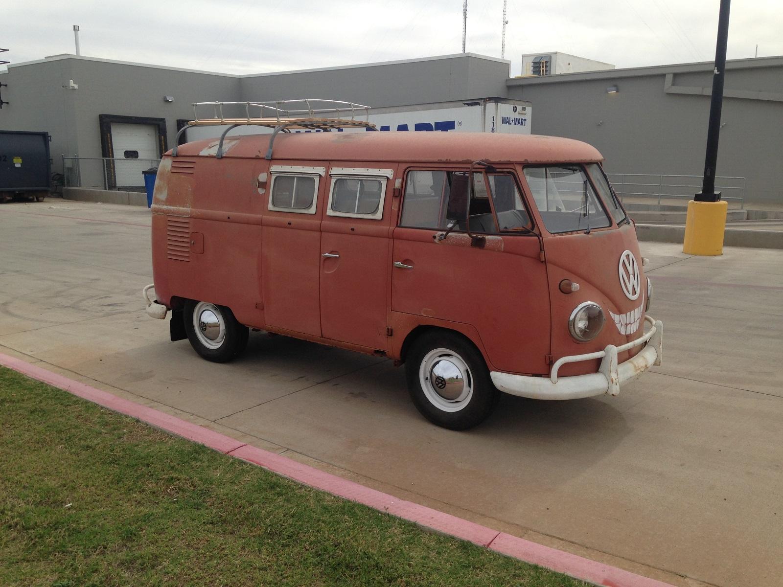

It still needs another good round of cleaning but I repainted the wheels and threw some new 205/75/15 tires on it. I've been prepping it to see if it will fire up. I changed the oil, plugs, wires, fuel pump, etc. I also ordered everything I need to rebuild the brakes. I've been heavily influenced by Brian's (Kombisutra) outlook on keeping the bus together. I plan on rebuilding the wheel cylinders and master with some honing and new kits. Check out his drive out and extraction threads, awesome stuff! This bus should be a pretty easy project to make road worthy again. I plan to hit the paint with some TR-3 to bring it back. It still has some nice shine on both sides if you look at it at the right angle. The paint was a lot nicer 8yrs ago as seen in the pics. It's a shame, the sun and weather thinned it out a lot more on the driver side. You can make out the faint logos of the pharmacy on the drivers side, probably doesn't show up in the pictures.

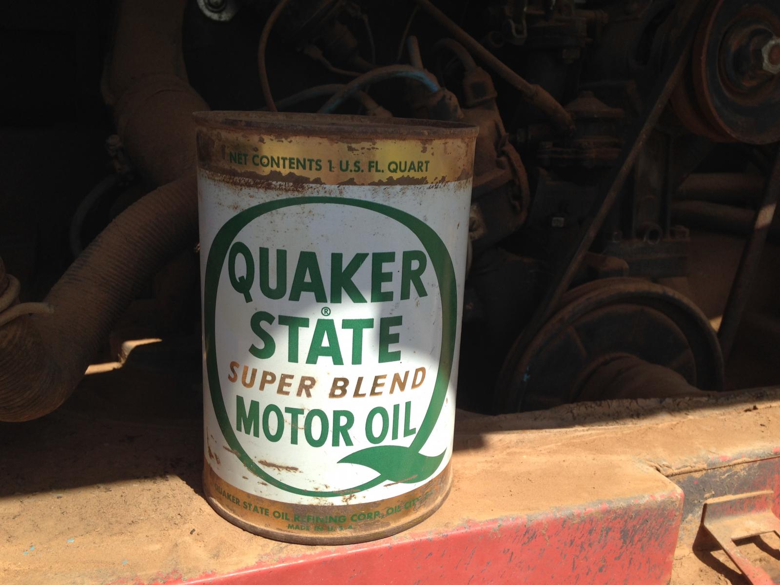

When I was messing around in the engine compartment a few days ago I noticed this old unopened oil can tucked away on the drivers side sitting in the battery tray that isn't under the battery.

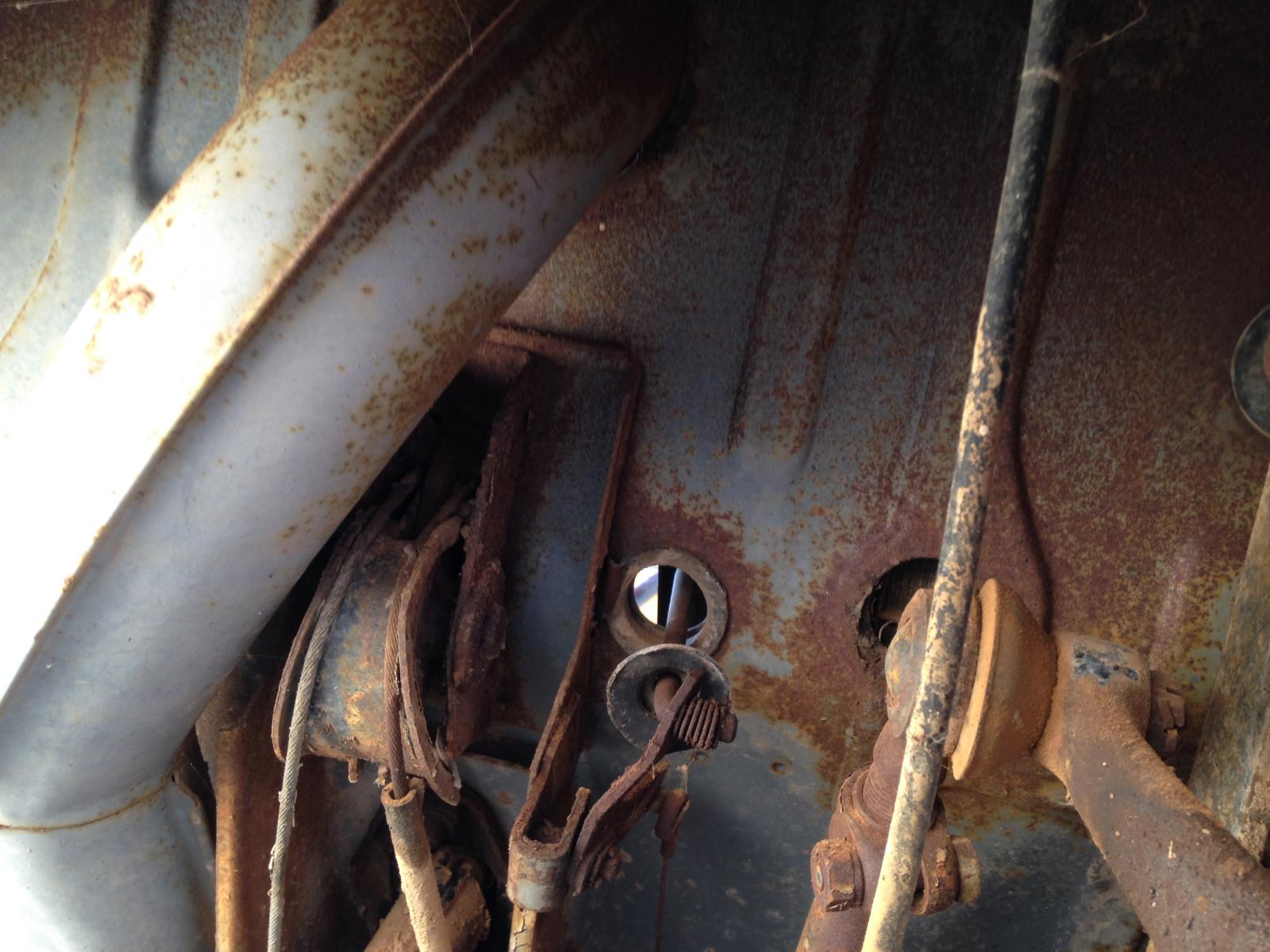

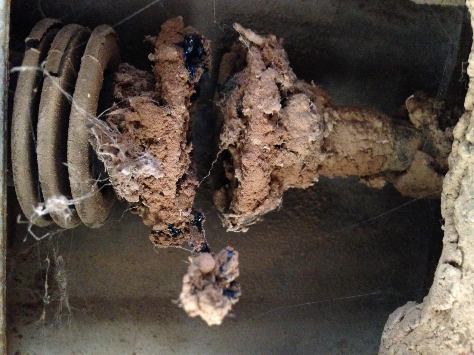

I also noticed the rear coupler split in half at some point in it's life.

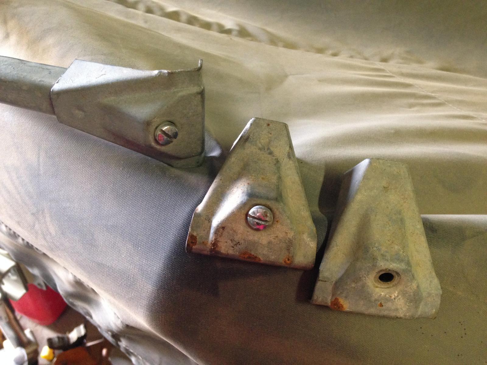

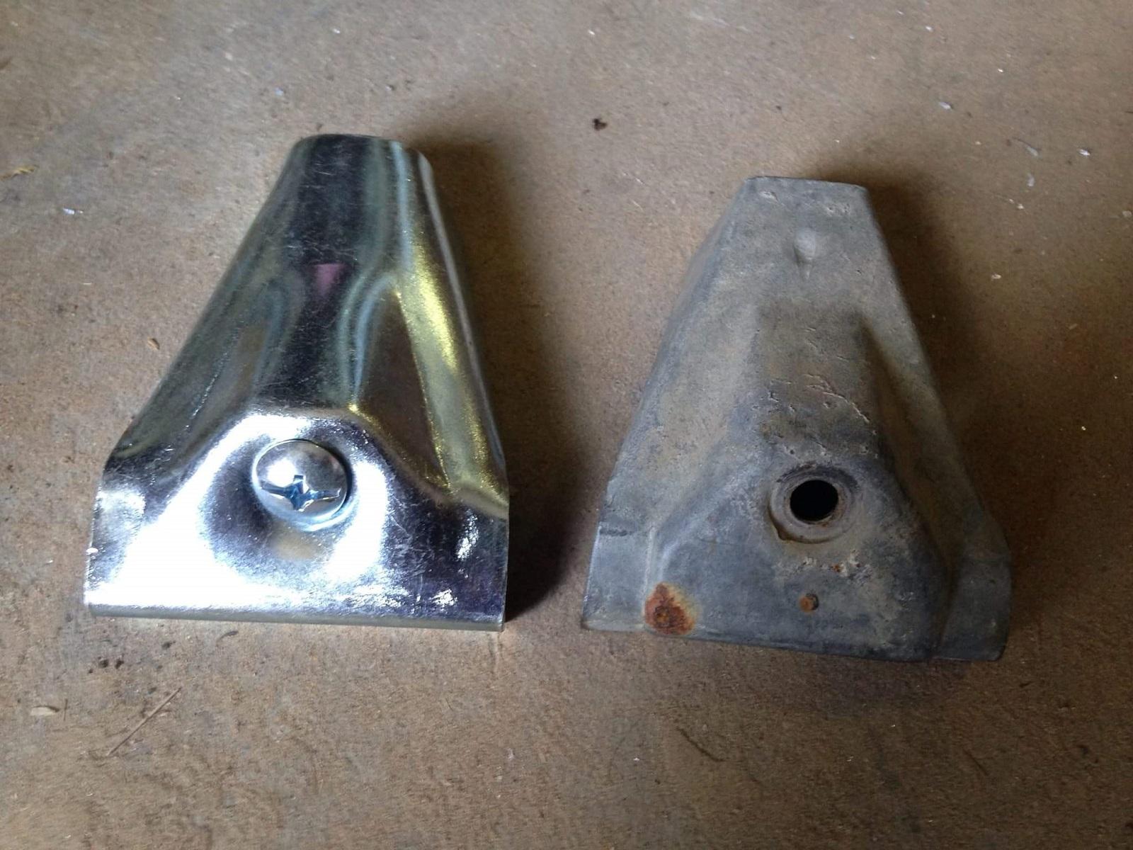

Looks like someone retrofitted a humpback seat, though it was close. This bus is 2555 VIN's and 7 days before humpback production according to Progressive refinements. The earlier backrest stop brackets are there.

Mega decent bus. The spare tire looks like an original style pizza-cutter with original air.

Thanks! I think it will be a lot of fun. I do plan to leave the smile on the nose.

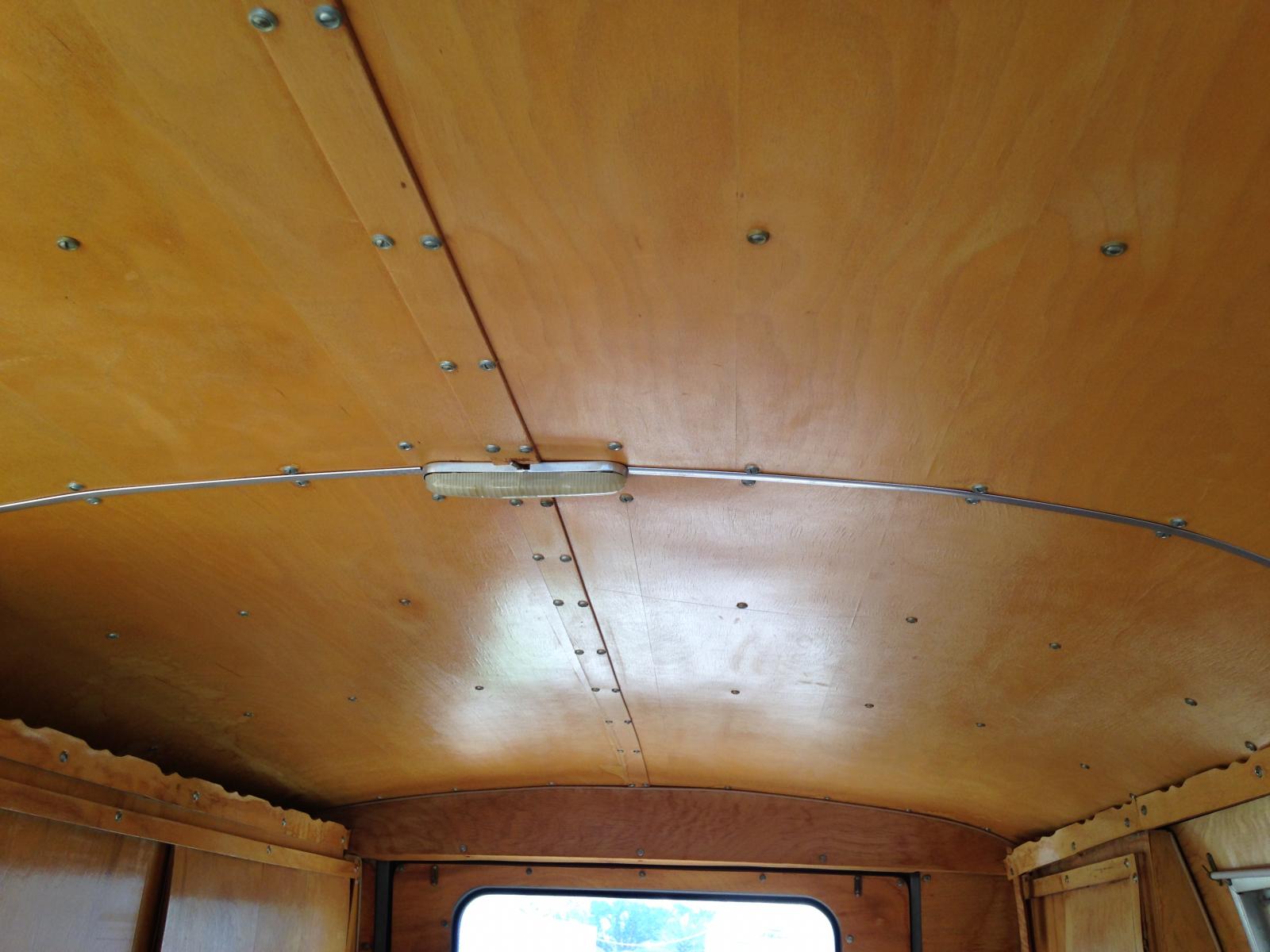

Make sure there is no household fiberglass or foam rubber insulation in the walls and ceiling. Big rust causers.
