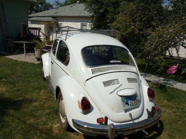

if you look at the bumper mounts on my bug, you can see the mounts welded to the bracket to install removable a roof high rack made out of square tubing. There are also some on the front bumper. I can take pics of the rack later if you want.

That's pretty much exactly what I was hoping to do, a square-tubing rack. When we get home from this camping trip, I think the welder may just be coming out....

I do not have the front rack but you get the idea and you don't have to tow a trailer Wink
This bug was owned by an oilfield engineer and he hauled equipment with it
so I guess this set up would work for a canoe Smile

We COULD do a trailer, but we'd definitely like the compact-ness of going without...
Right now, the bumper mounts are looking like the way to go!

60ragtop wrote:
It definitely helps to see this thing with a useful picture. Even better if you had one on the front. I'd probably go this route too- but my canoe is 17 feet long- and should not be supported so close to its ends. The gunwale load spread is only 5 feet. Hope it works out.
