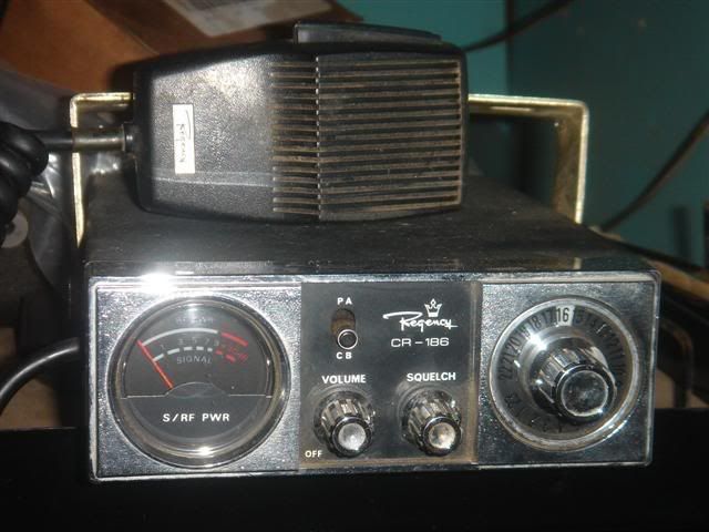

I have this for my bug. I still need to get one of those old school flexible antennas.
That's sweet!
How many folks get into your car, pick up that mic and say 10/4 good buddy?

lorse wrote:
That's sweet!
Thanks for the complement! If you notice, it has a PA switch. I also need an external speaker to get that working.
