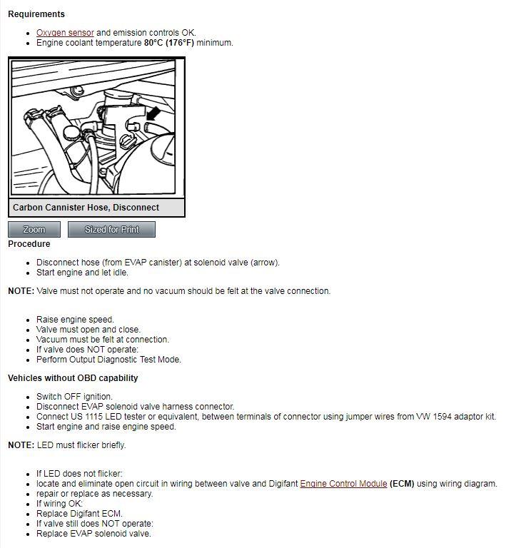

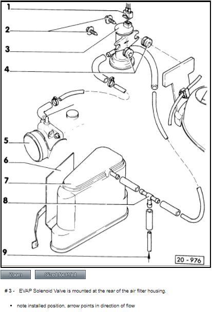

Yes, there is a purge valve (N80) on the '93.
Looking through receipts from the previous owner of my EV who lived in Oregon, she had chronic N80 issues which I suspect are related to the STUPID Oregon state law requiring a gas station employee [over] fill your fuel tank.
Here's some tech info to help locate and test it:
PURPOSE
The Evaporative Emissions Frequency valve allows the Engine Control Module (ECM) to control the flow of fuel vapors from the EVAP canister to the intake manifold.
LOCATION
Mounted at the rear of the air filter housing.
OPERATION
The flow of fuel vapor is determined by the ECM, depending on engine load, speed, and temperature. The valve is completely open at full throttle and completely closed during deceleration. The ECM controls the ground circuit. Voltage (12 VDC) is supplied by the Digifant power supply relay.
When no current is supplied to the valve, it remains in the open position. The valve is closed (100% duty cycle) when the engine is started cold.
A spring operated check valve closes when the engine is off to prevent vapors from entering the intake manifold.
MALFUNCTIONS
If the EVAP valve circuit is interrupted, the valve remains full-open. This could lead to rough idle and hesitation.
The valve is monitored by the ECM for short and open circuits.

I've looked all over the air filter housing but can't see anything connected to it. Could it be somewhere on the intake housing?
Googling n80 purge valve to see what I'm looking for.

PostPosted: Mon Jul 31, 2017 12:41 pm    Post subject: Re: Fueling problem on Eurovan 1992 camper. Reply with quote
Ahh I see it. Can I just blow thru back to the evap canister?

The Valve is probably normally closed (so that would be no). If you are blowing on the hose from the canister side, inlet to the N80 valve, then yes you can blow back to the canister.
I used vagcom to cycle my N80 purge valve and blew through it, when in the open state I could barely pass air through my old one so I replaced it.
