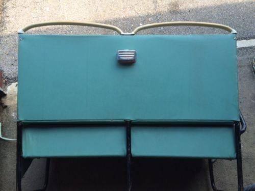

My 64 bus came with a short bay middle seat. And a como green cover. The seat covers were replacements, so I guess they are from TMI.
How I got the seat:
After I did some welding to the outer leg and armrest
