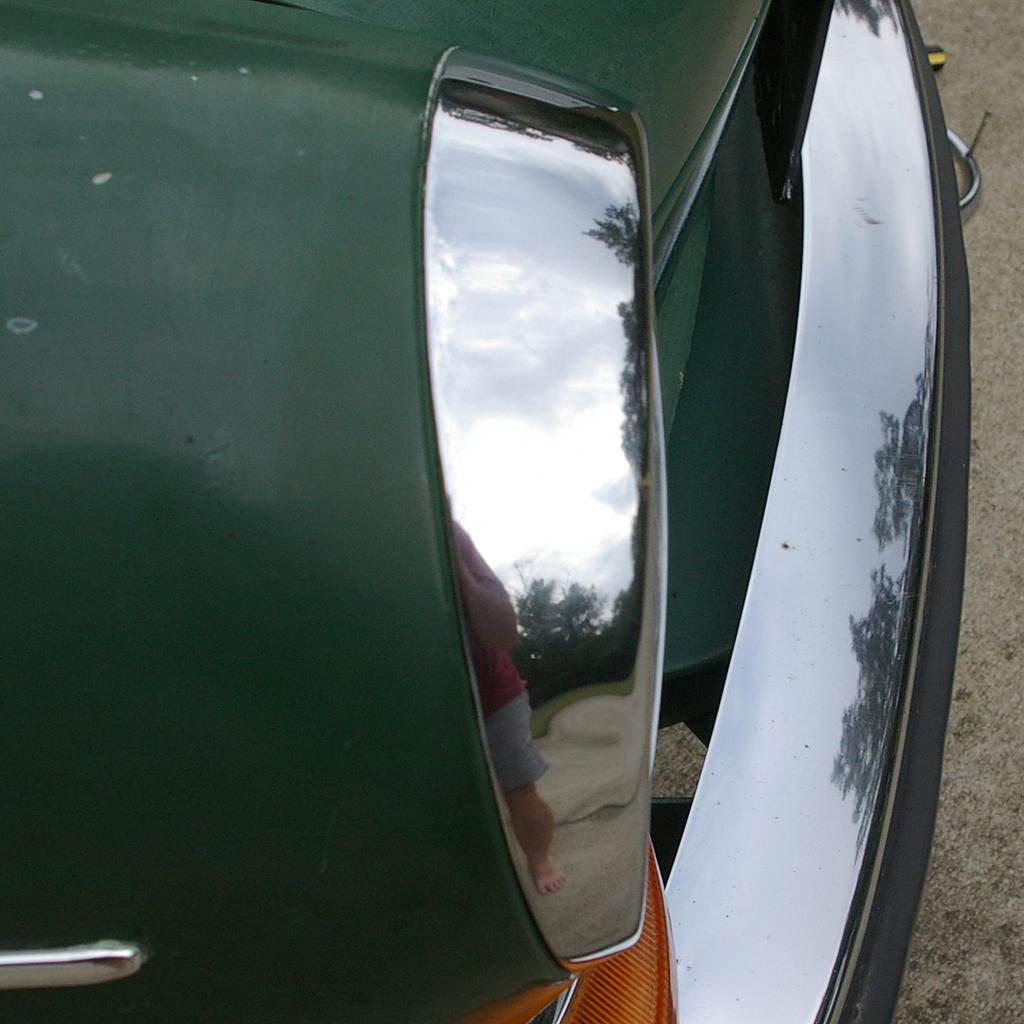

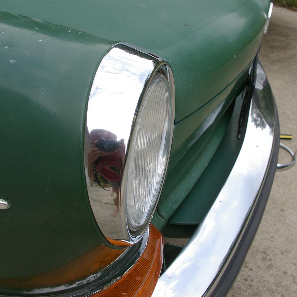

Installed a set of Hella H4 E-Code headlights...wow, what a difference! I got them from busdepot.com; they're German made, with glass lenses and a metal housing. I thought my originals weren't too bad, but the difference is night and day (pun intended).
The lenses are of course flatter than regular sealed-beam lamps, so it gives a different look. Some of you I'm sure have already made the conversion, but for those who haven't, I think this is the best $78 you can spend on your Type 3, if you do a lot of night driving (which I do).
A front view:
Closeup:
Side views:
I did have to adjust them up per the Bentley chart, as they were shining too low after installation. These are a direct replacement when used with the 55/60W bulbs, but you can use stronger bulbs with a relay. Here's the product link:
