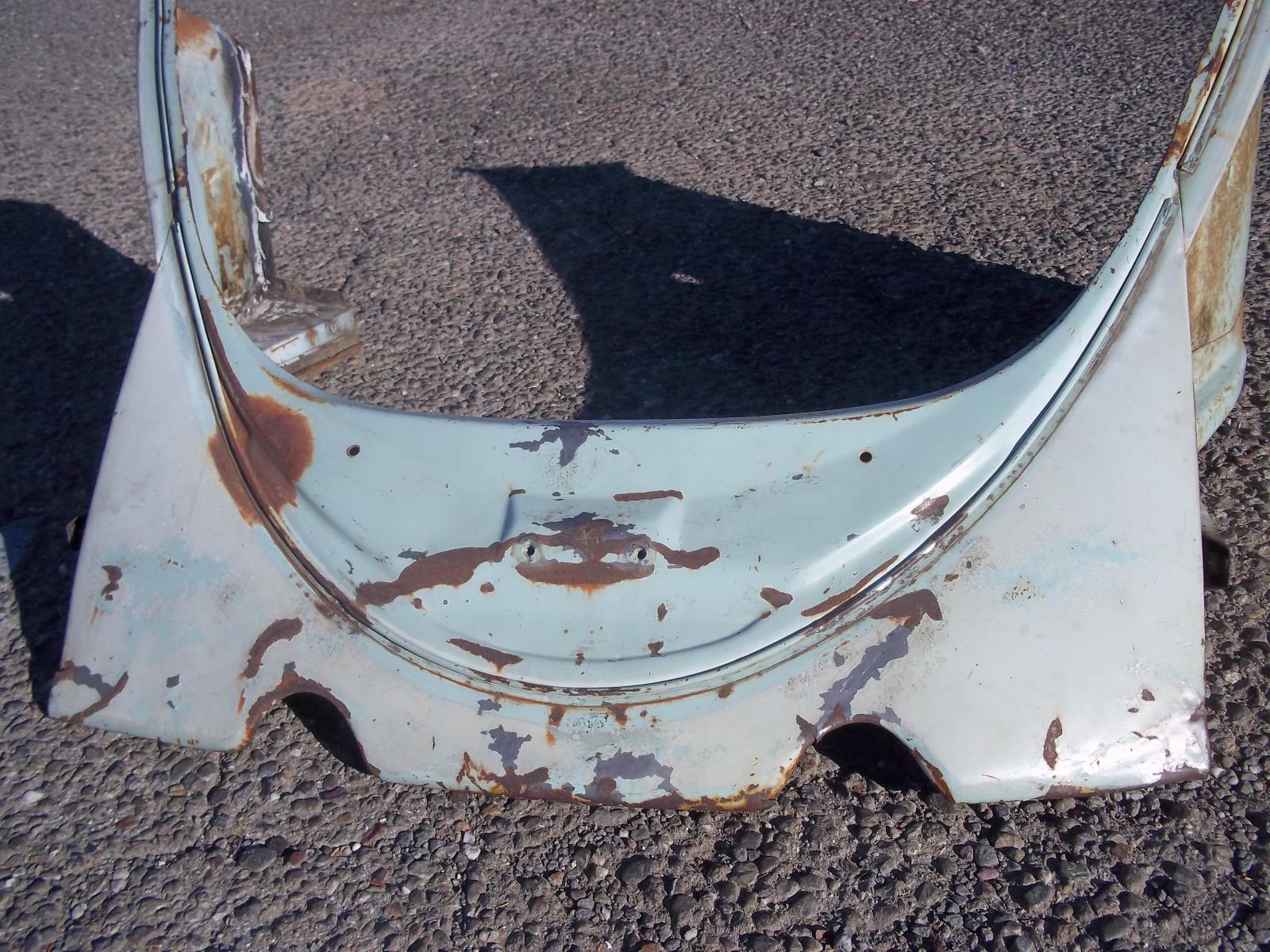

Need some tips on how to recreate the curve on the on the bottom of the apron of my 55. Need to repair where someone shoved a pea shooter motor in a early car. Metal there, is insanely hard and brittle, lots of cracks. Wont even weld very well.
folding the lip isnt an issue, but creating curve while bent, im not sure the best way to do that with limited tooling i have.

I did an apron for Cal-Look and eliminated the pea-shooter holes . . . about the same thing you will need to do.
1st, removed the inside panel
2nd, cut out the pea-shooter holes beyond the radius areas (in your case, beyond the bad metal)
3rd, made patch panels to fill the pea-shooter holes and butt-welded them and hammered them flat
4th, made a pattern from the bottom of a good apron and created a hammer-form from 1" MDF
5th, clamped sheet metal to hammer-form and made a new bottom panel
6th, welded new bottom panel to apron
7th, re-welded inside panel to apron
I did not use any special tools, and it turned out very nice.

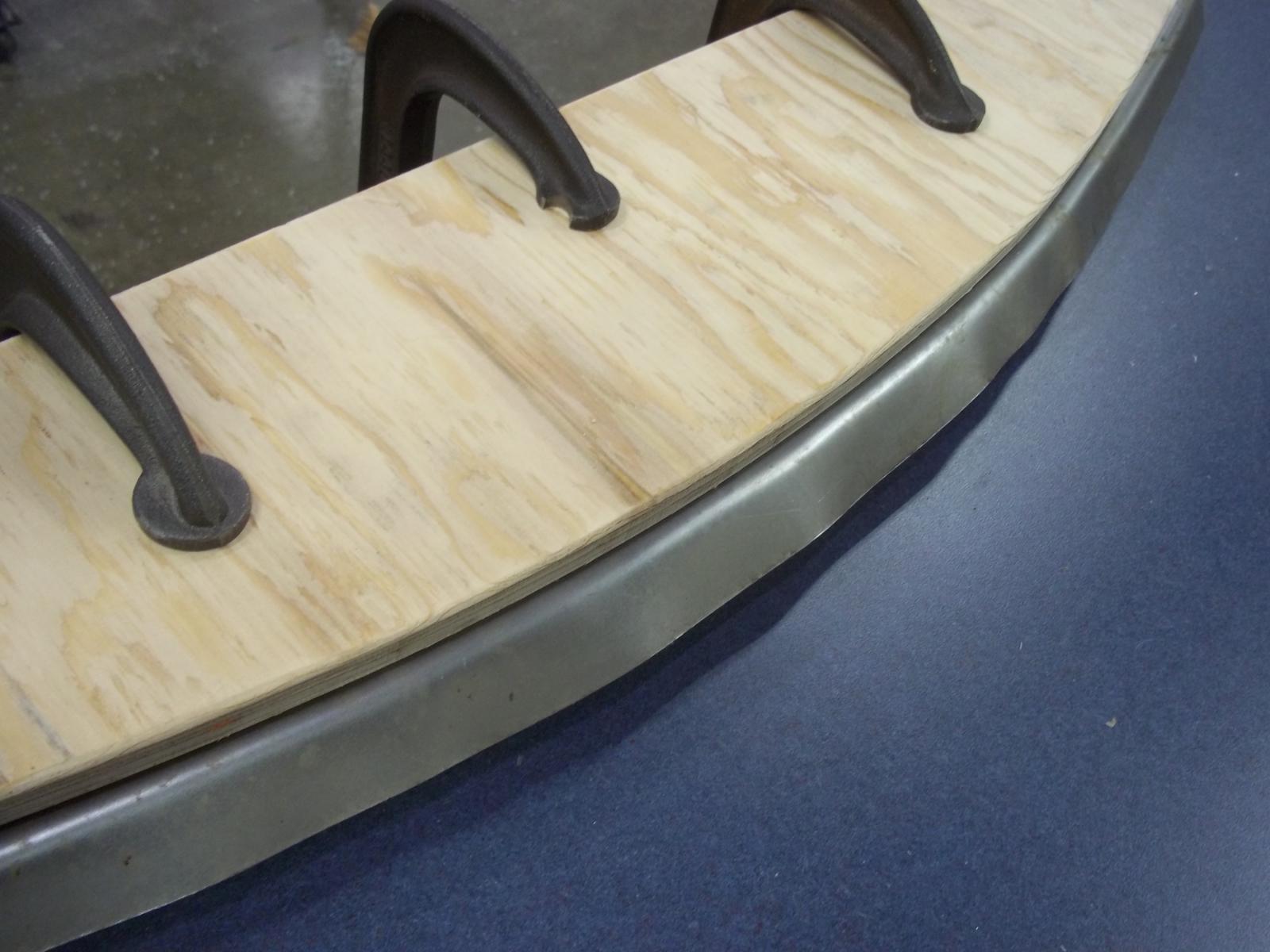

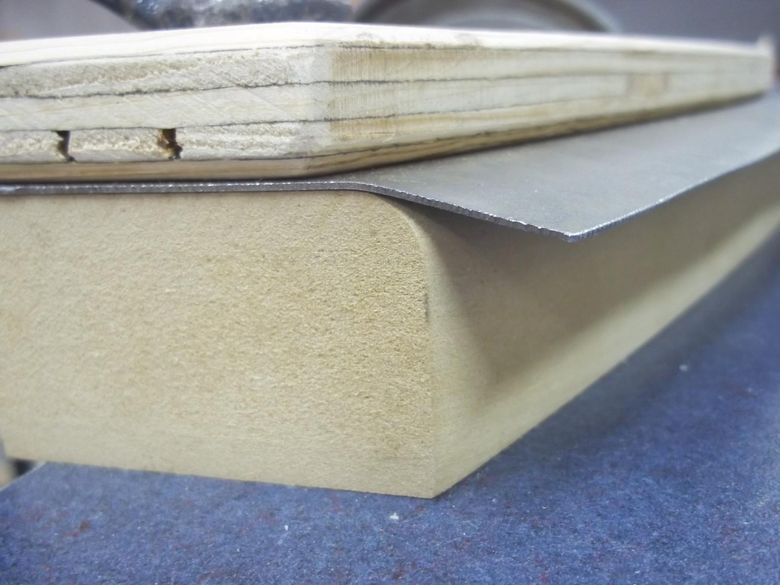

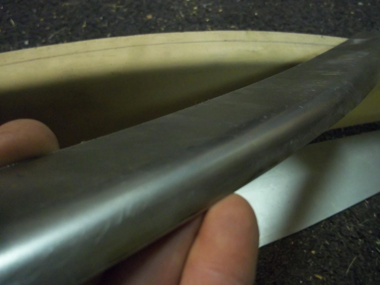

CREATING a HAMMER-FORM

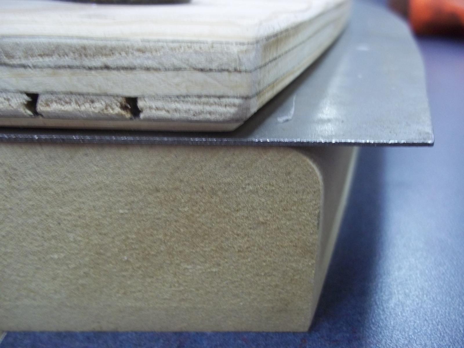

I started by making a pattern from a good apron using a large piece of corrugated cardboard. I held the cardboard horizontally against the bottom of the apron (in the same plane as the bottom of the car . . . easiest to do when the engine is out) and I marked the shape of the rear edge of the apron onto the cardboard with a felt-tip pen.
I cut out the cardboard pattern and transferred the shape to a piece of 1" thick MDF board that was just slightly wider than the apron. In order to make the hammer-form's shape symmetrical, flip the cardboard pattern over and line it up to the previously drawn mark, and mark another line. The two lines should be directly one on top of the other . . . if not, you need to average the two lines by cutting in between them.
After cutting the MDF, radius the corner to match the bottom of the apron panel . . . the radius gets larger towards the middle of the apron. You can use a sanding block with 100 grit sandpaper to do this.
I also cut a piece of plywood to use under my "C" clamps, then I clamped a piece of sheet steel between the two pieces of wood . . . Here's my "sandwich" . . .
Using the dead blow hammer, I gently tapped on the sheet metal from one end of the form to the other and back again. It looked like this after the first pass . . .
Several more passes and it looked like this. Lots of small taps work MUCH better than fewer big hits! The soft face of the dead blow-hammer prevented dents from forming in the curve.
Note that waves will form along the edge of the sheet metal. The waves need to be shrunk, so now concentrate the hammer blows to the high points. The dead blow hammer does not work very well at this, so now is the time to start using your body hammer . . . the one with a large face.
Working the highs with the body hammer will get you to this . . .
Remove the clamps and your careful work should be rewarded with something like this . . .
Carefully trim away everything that does not look like the bottom section of an apron panel . . .
By using this continuous section, the bottom of the apron will be nice and strong to resist cracking and other problems that can otherwise occur, plus the apron will have a beautiful curve again!
Hope this will be of some help to you!

Just a way to make sure that the right and left sides are the same. However you end up making your pattern, just make sure both sides match!
kielbasa wrote:
And radius of thr corner of wood is bigger than outer sides?
If you look at an apron, notice that the bottom edge has a smaller radius at the sides where it meets the fenders . . . compared to the center of the apron , , , the area between the "pea-shooter" cut-outs has a larger radius.

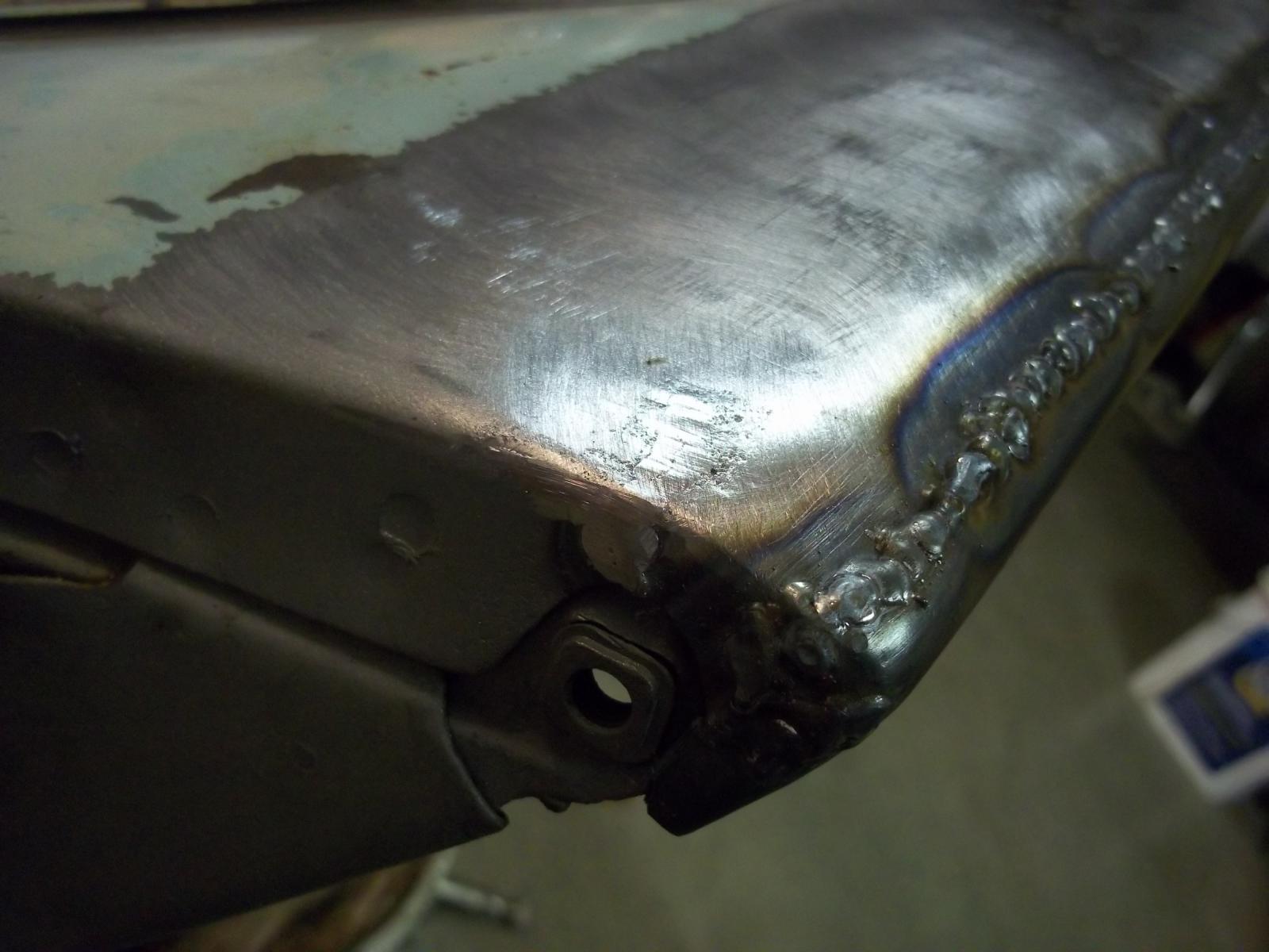

I formed my bottom repair section with a 90 degree bend, but the lip WILL be horizontal, that is in the same plane as the bottom of the car, when I finished.
In the photos above, it is still a rough trim . . . I trimmed more . . . trimmed right to the point where the radius stopped. The rest of the radius is on the apron.
Maybe another few photos will help.

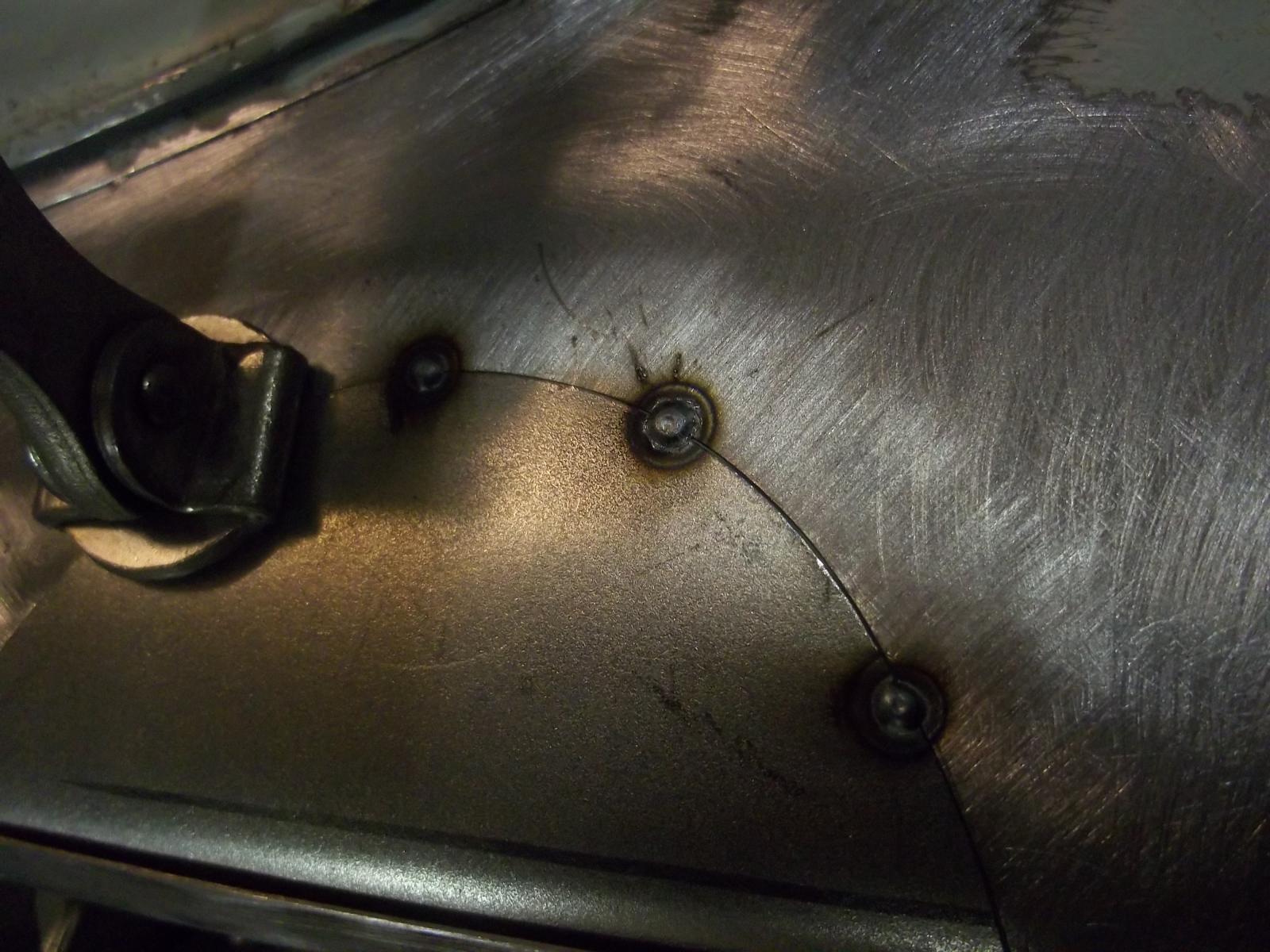

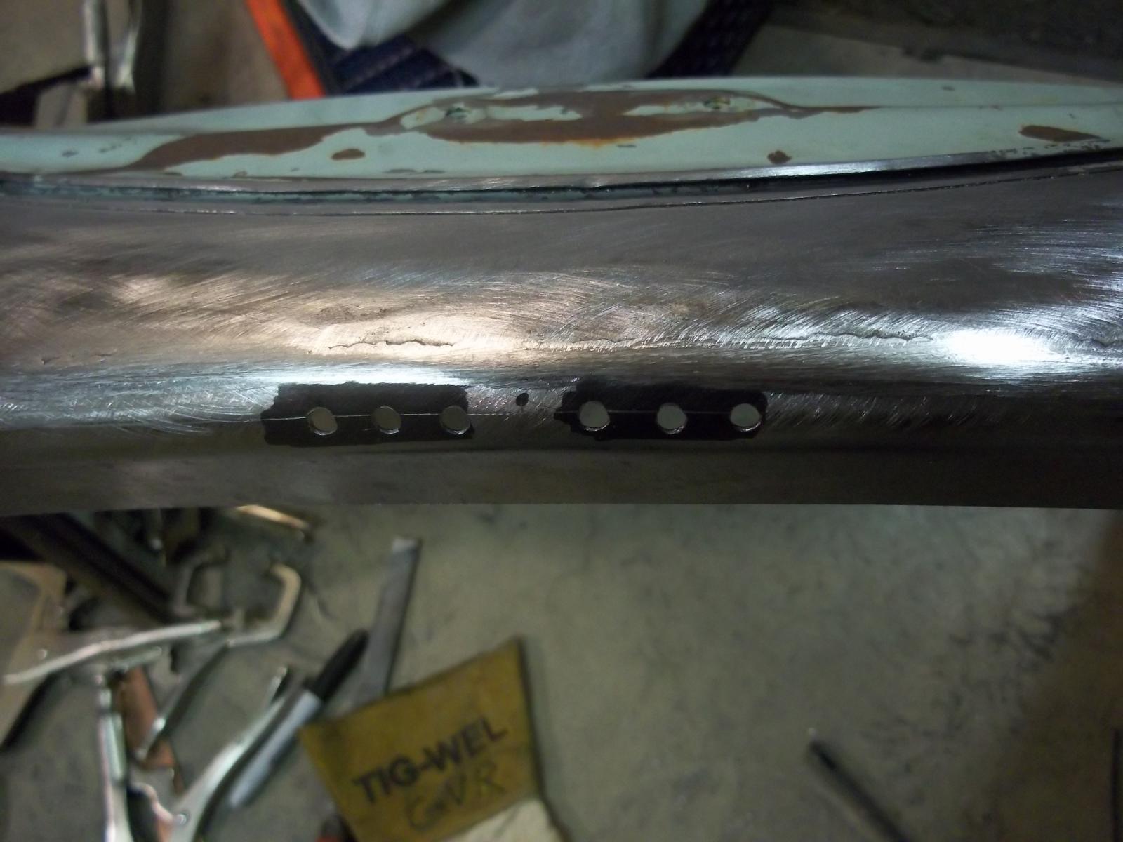

Notice that the junk has been cut out . . . on mine, that was the pea-shooter holes, but on yours it will be those nasty work-hardened, dented areas. Now is the time to work-out any dents, etc. with a hammer and dolly. The apron will be quite flimsy at this point . . . make sure everything is lined up and not twisted before proceeding . . . then the new panel is clamped to the apron along the bottom lip.
I Fitted the patches I made to fill the holes . . . notice I tried to keep the gap as small as I could. I butt-welded the patches, knocked down the welds, and again I worked the apron with the hammer and dolly. I marked a trim line on the apron, removed the new panel, and trimmed the apron.

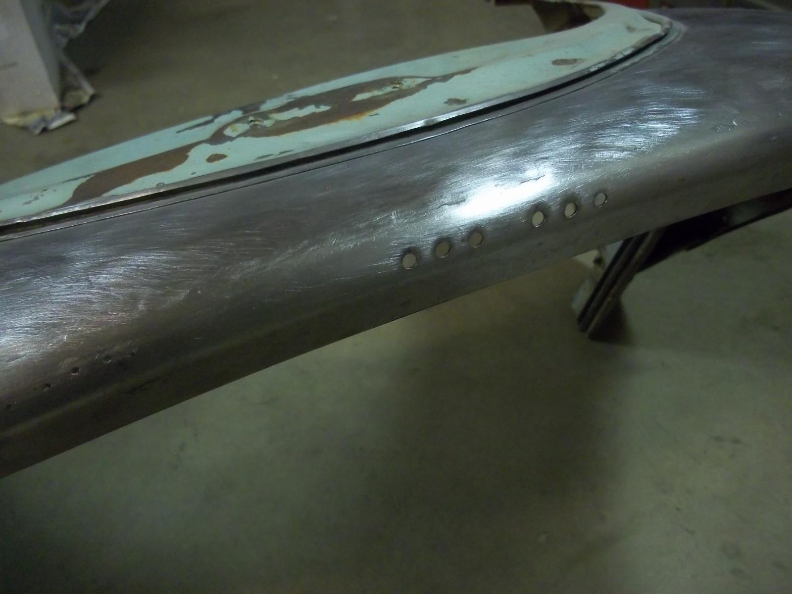

After welding the new bottom panel the entire length, I trimmed the extra length off of the new bottom lip leaving just enough to hammer over and replicate how the original apron was formed in the lower corners. Also, my apron had a couple cracks that I had to repair . . . I welded the cracks and ground the welds . . . You can see one of them here.
After grinding the welds, I marked the locations and drilled these drain holes to add some realism . . .
My apron probably should have been tossed into the scrap heap, but I am glad I did this . . . a very valuable learning experience for me!
Hope this helps! Did I answer yer question?

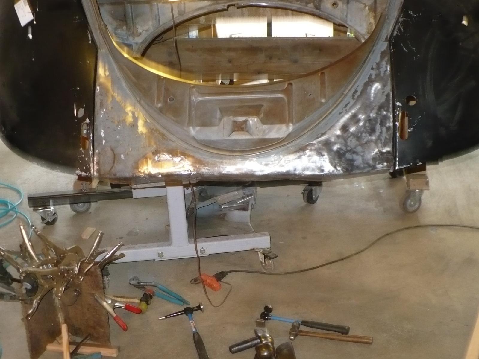

This is what I've been working on for some time now.
What I started with:
Where I've gotten to with the hammer/dolly, head scratching, what do I try next method:
Having a paper pattern for the curve would be a great starting point for a hammer form. I don't have a stock apron to trace from so I'm trying to get it close and then maybe try to make a hammer form that'll fit inside to work the final lines out with. Learning curve....literally
You need a new rear apron or you need to basically fabricate a large repair panel similar to the OP, who did a nice job BTW.
