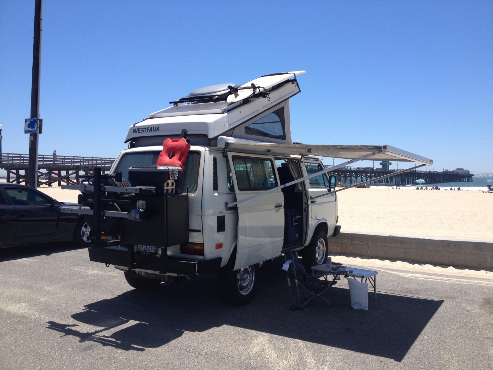

Mine is mobile - from the roof rack to anywhere else. With a 25-foot cable, I park in the shade and put the panel in the sunlight.

Both! 135 watt on the roof and 100 watt portable to be moved around the campsite if needed?

I have had solar on my poptop for many years. I recently replaced it with a larger panel and added another panel to the front luggage rack area. Even so I know we won't be able to count on that fixed solar to always meet all our 12v needs. So we will also be carrying a portable panel and a long cord. Even that won't always suffice.
Over the past few months I have tested 8 different panels with 5 different charge controllers to see what more I could learn. I wanted to do all my fooling around with solar at home rather than when we are on the road depending on it.
