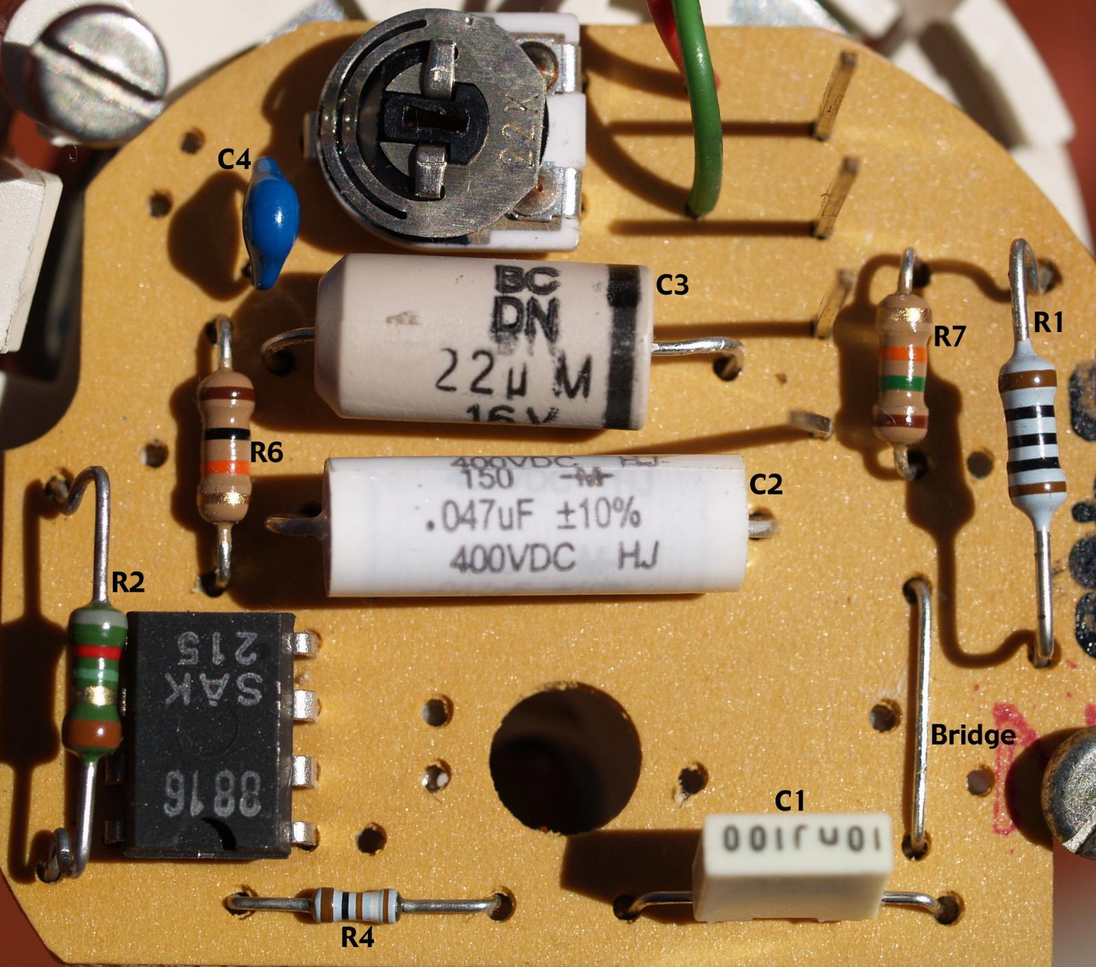

You need to modify the gasser tachometer circuit board to downsample the AC coming in from the alternator's "W" terminal. Discrete components from salvage are getting hard to find, so good luck with that, and most modern devices are all surface-mounted components. I just ordered all the parts from Digikey:
R1: Do nothing
R2: Do nothing
R3: Delete
R4: Do nothing
R5: Delete
R6: Replace
# CF14JT10K0CT-ND
RES 10K OHM 1/4W 5% CARBON FILM
R7: Replace
# CF14JT15K0CT-ND
RES 15K OHM 1/4W 5% CARBON FILM
R8: Remove
D1: Bridge
C1: Replace
# 399-11522-ND
CAP FILM .01UF 100V 5% RADIAL
C2: Replace
# 338-3299-ND
CAP FILM 0.047UF 400VDC AXIAL
C3: Replace the old capacitor with a new one of the same value, observe the banded side!
# 4199PHCT-ND
CAP ALUM 22UF 16V 20% AXIAL
C4: Add a capacitor where there was nothing
# 445-8294-ND
CAP CER 3.3UF 16V 10% RADIAL
Components cost less than $5. If you don't have the foil and therefore the tach plug, you can get receptacle A19972-ND and carve it down to fit, along with 3 of the A32533-ND sockets.

Using the listed components, make your board look like this:
The schematic modified for the diesel alternator:
The circuit board is the easiest part of the mod, it took me about 90 minutes to solder up the board. Before you put it together, make sure you have a small screwdriver to fit the calibration adjustment on the board. If possible, save yourself work now and calibrate the tach while it is out and back at the engine. Otherwise, the calibration access hole is hiding under a piece of white paper tape.

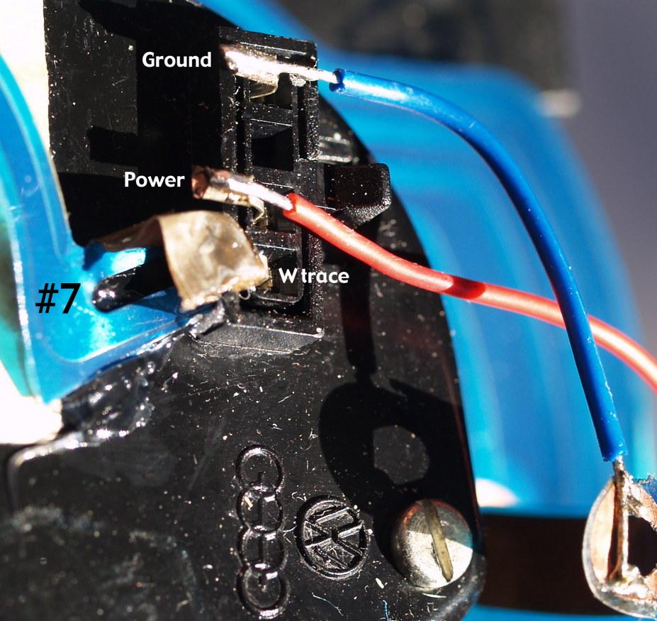

The tach plug is wired like this, I soldered the #7 trace directly onto the W signal pin:
Red #7 into the 14-pin had been driving the clock, so I recommissioned that circuit for the W signal:
You can snap apart the connector to solder directly onto the pin. Don’t just chop the red wire off and leave it dangling naked! Using this method, the entire cluster can be removed by disconnecting one 14-pin plug. BE CAREFUL with the connector, as the foils come loose and fold back easily. RTV Silicone seems to stick pretty well to both the copper foil and the mylar. Also, bear the the left side as you insert the plug, it takes pressure off the copper foils.

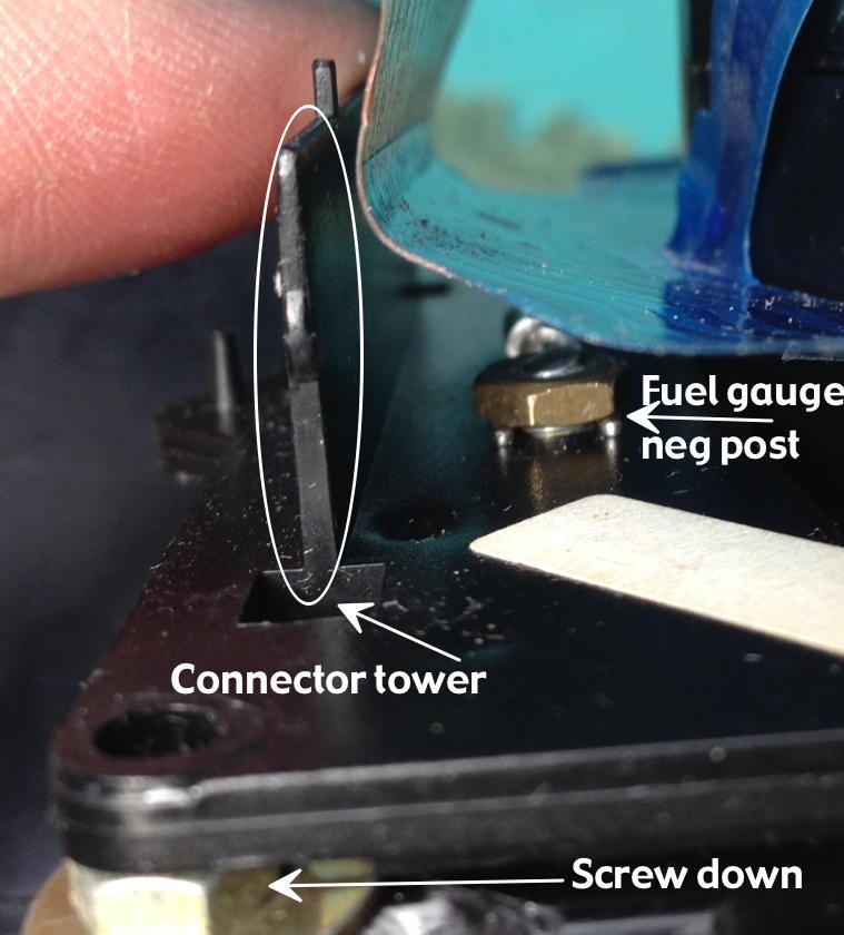

The '88 tach has the regulator positioned differently, so I rewired it like this:
A few small screws, nuts washers and wire eyes is needed for this, all from Ace Hardware or your scrap bin.
The '88s regulator was screwed down to a steel plate that was grounded, possibly for blocking EMF to the tach board, not sure. I grounded it anyway, running the same ground wire to the temperature gauge small center pin:
The above picture shows in the background the temperature gauge negative post that goes off to the sensor. The blue wire to the ground comes from the photo immediately above.

I'm glad this worked for you. I was looking at the schematics/description and it seems there are discrepancies.
Your description says to replace C3 with the same value capacitor (22uF) but the gasser schematic shows that capacitor as 47uf. There is no 22uF capacitor listed on the diesel schematic. The diesel schematic shows the value for the C3 capacitor as 47uF as well, not 22uF. In looking at the vwdiesel.net source threads, the value for C3 is consistently 47uF. Your pic clearly shows that you did use a 22uf capacitor there and apparently it works that way.
The value for R2 should be 72 in the diesel tach but is 82 in the gasser. You say to leave the 82 ohm. Maybe that's close enough, but I'd probably still replace it.
The diesel schematic also has a couple components labelled incorrectly. C5 is really C2 and C6 is C4...
The gas tach does not run off the gas alternator. It runs off the ignition signal. The diesel runs off the alt because a diesel does not have an ignition signal.

Oh you’re right, very good spotting! I put C2 and C3 in the wrong places, yet somehow it works. Probably because 22uF and 44uF are not very different values.
I didn’t look at the schematic. Anyone is invited to update any information here, as I am not too good with electronics. My worry was that if the other page went offline permanently the knowledge would be lost.
