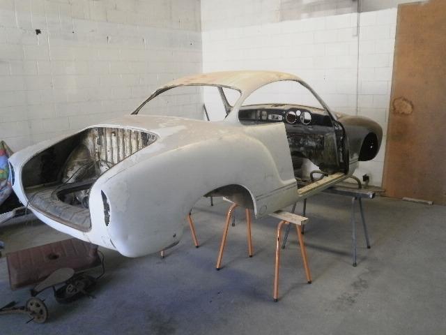

After a busy couple of weeks between work and packing to move house, I finally have got Phoebes shell loaded onto a trailer and off to the shop.
Here she is successfully at Barry's shop. We are having a public holiday here for the G20, and all of Brisbane was leaving town for the long weekend. A trip that normally takes one hour took two and a half.

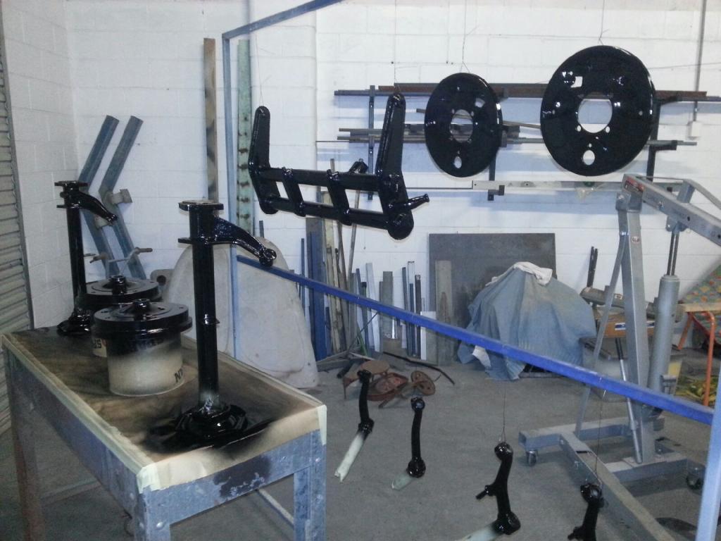

Fuel tank and a kids bike that's going to join the line at the sand-blasters....
Bits and pieces for the floorpan, backing plates and beam.
Floorpan has been blasted and will be dropped off early next week, shell will get picked up at the same time for blasting, when all will be revealed!

First paint applied to the car. OK it's not that exciting but it's the first shiny bit! Rear drums only as will be running with CSP discs up front.
The body is now on a frame. After carefully looking it all over the prognosis pre blast is little rust aside from the sills, but the accident damage at the front a little worse than initially thought. Overall still good to go. See if I feel the same post blasting.

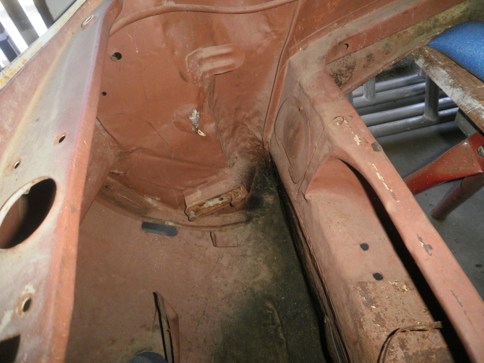

Got the floorpan back from the blasters. Nothing too unexpected, the worst is shown in the photo, the 'low' point of the floor behind the front seats. Worst on drivers side, probably end up buying the rear pan halves and just replacing the dimpled sections.
Haven't got the body back yet, wait for that to return before putting together a replacement panel shopping list.

PostPosted: Mon Nov 24, 2014 11:45 am    Post subject: Reply with quote
Masterseries is self leveling and will fill probably all of the pitting. Unless you really want to weld... Smile

PostPosted: Mon Nov 24, 2014 3:35 pm    Post subject: Reply with quote
I might be able to get away with that on the passenger (left) side, but the pitting in the photo is worse than it probably looks in the photos. A lot of those dark bits at the corners of the dimples are actually pin-holes. It was a little worse than I was expecting, but that's normally what happens after blasting!
It's only in the low bits behind the front seats, the front halves are excellent. Must have had some water come in and just sit in the low points and fester away.
