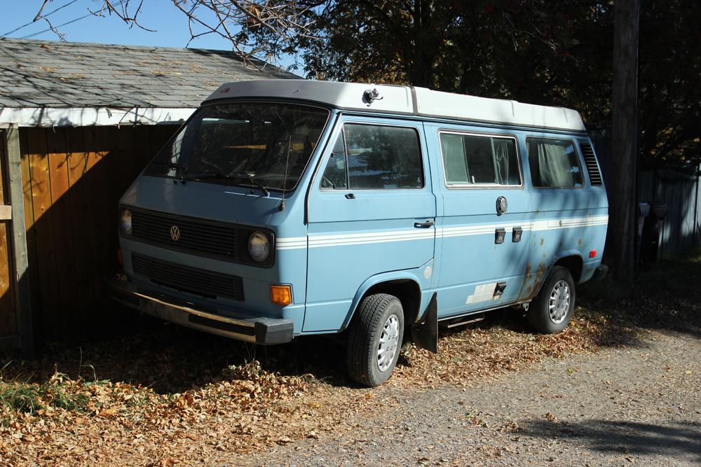

UPDATED: I'll be updating frequently. Scroll down to see how the work is progressing.
I've been browsing this site for a few months and I've found it a great source of information and inspiration. It got me thinking I need a Westy. I've always wanted a VW camper - our family had one when I was a kid.
Recently, after a particularly cold and rainy camping trip (me, my wife and 9 year old daughter in a tent with a Jetta as our camping car) I decided it was time for our own Westy.
I don't do things the easy way. I looked for a van that needed some help and I found one with an blown head gasket and some rust that was going cheap.
I'll be posting photos as I go through the process of getting it running again and dealing with the rust. I look forward to your comments, maybe some advice and sharing the adventure!
