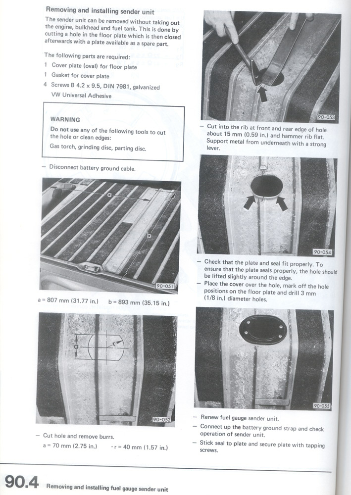

skills@eurocarsplus
Samba Peckerhead
Joined: January 01, 2007
Posts: 17833
Location: sticksville, ct.
PostPosted: Fri Oct 31, 2014 1:17 pm    Post subject: Reply with quote
It took me 6, yes 6 of those senders to get 1 that worked.
Plan on cutting a access hole now. They are really that bad.

Hi. You might consider changing out your sender and fuel gauge to something modern, and a lot less expensive. I adapted this:
http://www.amazon.com/Moeller-Marine-Electric-Univ...uel+sender
...to my bus's fuel sender cover without much difficulty. I then took a Faria gauge that matched the resistance range of the sender and adapted it to my gauge cluster, using the original fuel level range plaquard from my original fuel gauge. It still has the original look. A dremel tool is essential, and you need to pay attention to proper grounding. Took me a day or two, but works well and is reliable.

PostPosted: Sat Nov 01, 2014 8:47 am    Post subject: Reply with quote
that's the piece of shit! make sure it works, or be ready to either cut the hole, or pull your tank again
mine did not move off of the "R" until I had about 3 gallons of gas in the tank. that was with the correct length sender too.
on one hand, it's nice to know that I have a few gallons left. on the other hand, it is still a piece of crap
