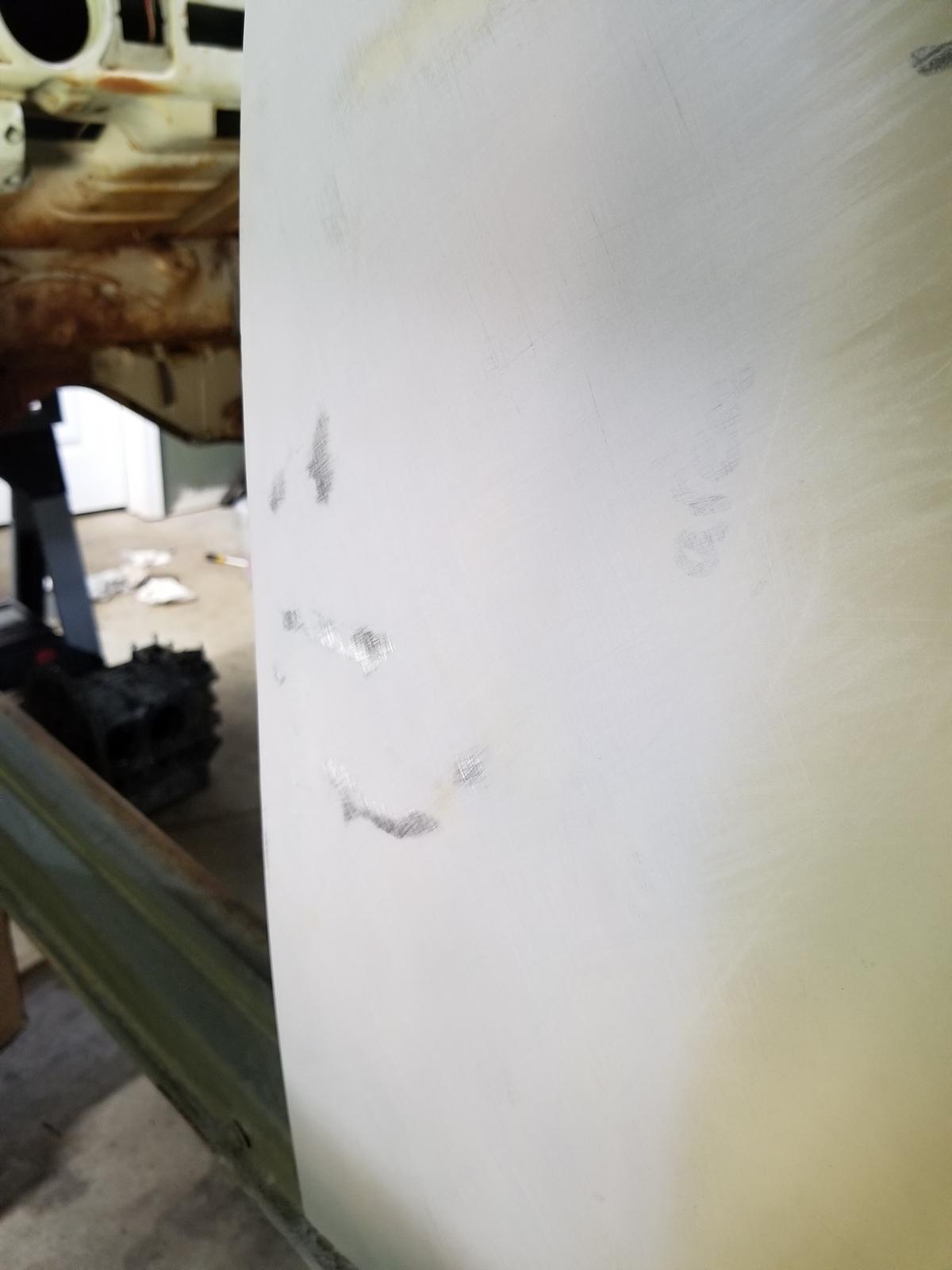

Well it turns out that im half decent at body work! considering the only body working tools i own are a hammer and dolly set, and thats it Laughing
I have 1 issue! There is this stupid high spot. I circled it and wrote around it in one of the pictures. I tried shrinking the metal using a heat gun and water in a spray gun and it helped but not enough.
This are started up as a giant pinched dent. Its getting alot better tho.
what should I do??
Also, what technique should i use for smoothing the metal after ive remove every last high spot? It seems like a portable English wheel wheel would work well if that was a thing. Is it?
Thanks
also, i have access to the inner panel,

hi. sorry about the delay in response.
i dont have a shrinking disc yet but ive been using an electric heat gun to warm the metal and then spraying the metal with room temp water.
do yall think a shrinking disk would work better?
heres where im at now. i still have a few high spots. but not as bad as before.

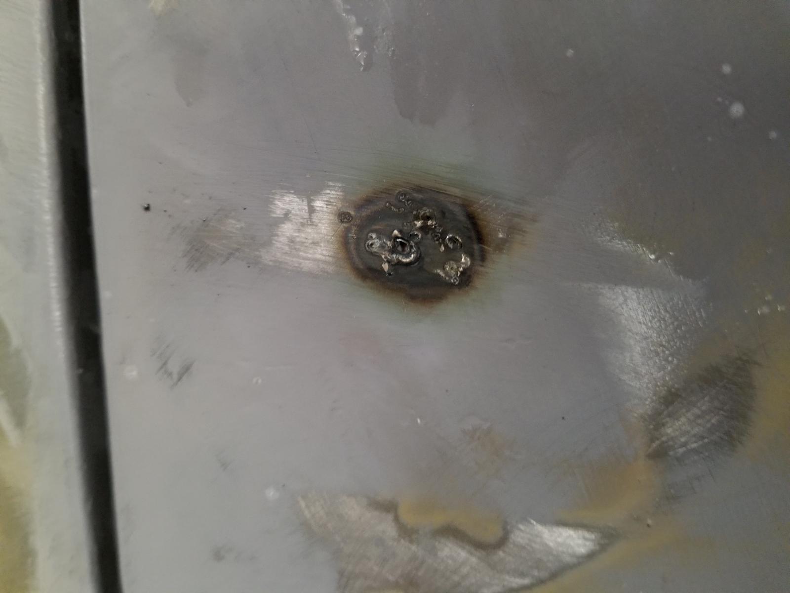

thanks a ton for all the advice given. very helpful. i tried the tig method andit worked however i didnt flatten the tungsten so i did make one pinhole in the metal. nothing i can fix tho. imma order a torch instead tho because the tig tends to leave a poor surface finish with my set up. but the metal absolutely was shrinking which is a plus.

The area inside the black is a very shallow but large low spot. Will using a large shrinking disc on the entire area help?
And heres the finish left by the tig. I used some 80 grit and most of it disappeared tho.

At this point you need to start filing or sanding with a hard block to reveal highs and lows. The hand works well but the file doesn't lie. I've had good luck lifting large low spots with a slapping file on dolly. The idea is create more surface area on the finished side thereby stretching the panel up. File it off and repeat until all the low spot disappears.
You need to understand that shape comes from shrinking or stretching of the metal. You can push it around or you can manipulate the thickness of the material to achieve the shape. Manipulating the thickness is how you get to a nice final finish.
Looks good so far. Flat and near flat panels are the hardest to straighten, especially without oil-canning.
