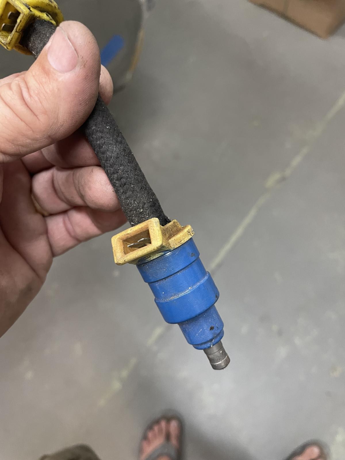

That is a score, odd colored injectors thugh, check the part numbers. If they are the type 3/4 D-jet ones I suspect they are I could be interested in them.

PostPosted: Tue Apr 30, 2024 5:00 pm    Post subject: Re: 1972 Bus Type4 EA 1.7 to Ljet? Reply with quote
I assume that you mean the yellow and black “spares”. I didn’t think they were the same as the greens and blues. I’ll check the numbers tomorrow and let you know.
The yellow and black ones are D-jet. They will not work with L-jet....yet they have value because they are excellent and work on type 3 engines, 411/412 and Porsche 914.....and are out of production.

PostPosted: Tue Apr 30, 2024 5:25 pm    Post subject: Re: 1972 Bus Type4 EA 1.7 to Ljet? Reply with quote
Please do, they all look similar shape wise, but the little tiny numbers on the sides of the plastic part tell the whole story, ever so slight differences in flow rate and ohms. The black ones may be of interest too.

PostPosted: Wed May 01, 2024 12:40 pm    Post subject: Re: 1972 Bus Type4 EA 1.7 to Ljet? Reply with quote

PostPosted: Wed May 01, 2024 12:43 pm    Post subject: Re: 1972 Bus Type4 EA 1.7 to Ljet? Reply with quote
Two of the injectors have no numbers. The black one is 311 906 031A. The yellow is 0 280 150 007.

PostPosted: Wed May 01, 2024 6:27 pm    Post subject: Re: 1972 Bus Type4 EA 1.7 to Ljet? Reply with quote
The 311 part # is a VW part # and is type 3. Also fits Type 4...411/412/914...many mercedes, Saab, Renault etc. The 0280 part # is the exact same injector. Its just the Bosch number.
The "RAM" injector is an aftermarket injector rebuild company. Sme in jector. None of them will work with L-jet. Resistance is different. However, sell them to D-jet guys they are no longer made. Ray
