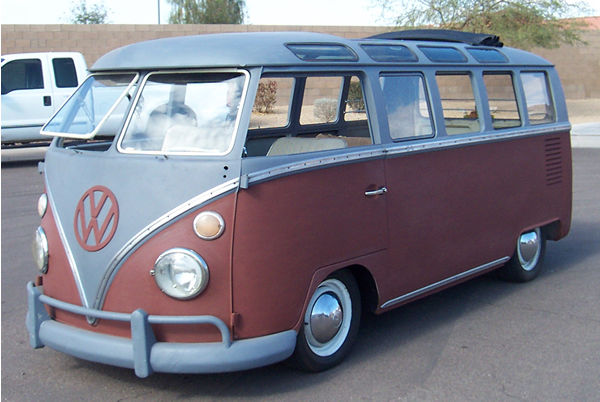

Before
After a narrowed beam, drop spindles and a busboy kit in the back.
Its alive.... I need a front turn signal housing and lens, anybody got a spare?

Thanks guys... I found a spacer for the front wheels so I can lower the bus
another 1.5" in front and a click in the back. Twisted Evil Twisted Evil

My tires are rubbing on the inner wheel wells where the metal dips down 2" from under the seats when it hits a big bump, with the spacers it will move my wheels about an 1" out, giving me 1.5" to lower the front even more.

Thats a ok job on making room on the sides but it would have been better to narrowed the beam than to mess w/ the body. Its still look like it would rub when you turn...
This is the future... just have to find a way to mount the seats and make the steering box work.
