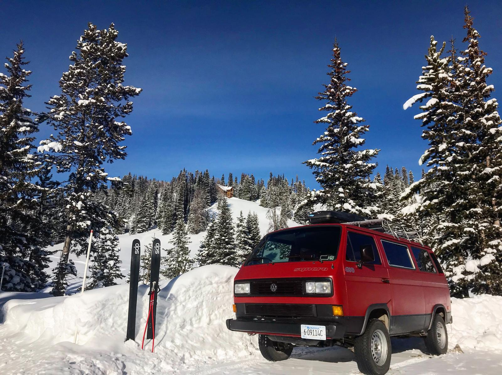

Yeah I'm not sure if the big brake kits will fit 15's...I'm eventually going to put 31x10.5x15 tires on mine (not for the meek $$ & syncro only). I don't think they will ever stop making that size...
Here's what 31's look like...
