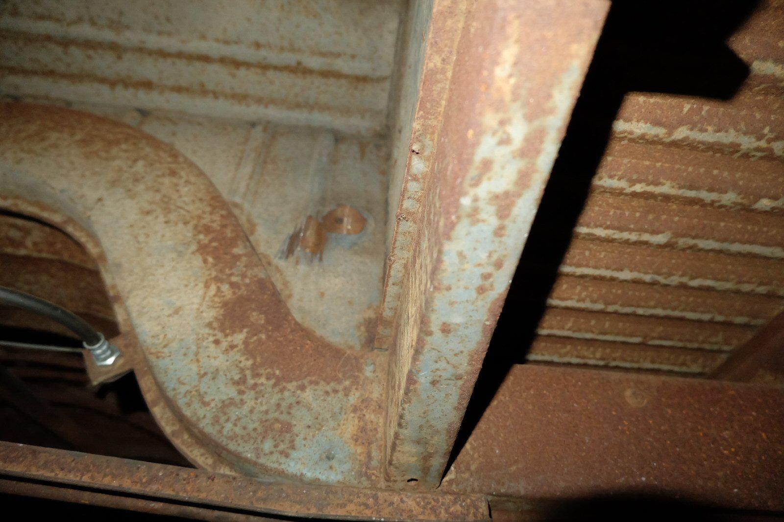

PostPosted: Wed Jul 19, 2023 4:08 pm    Post subject: Re: Drain holes - outriggers, crossmembers Reply with quote
I got a pic of the outrigger. original metal.
