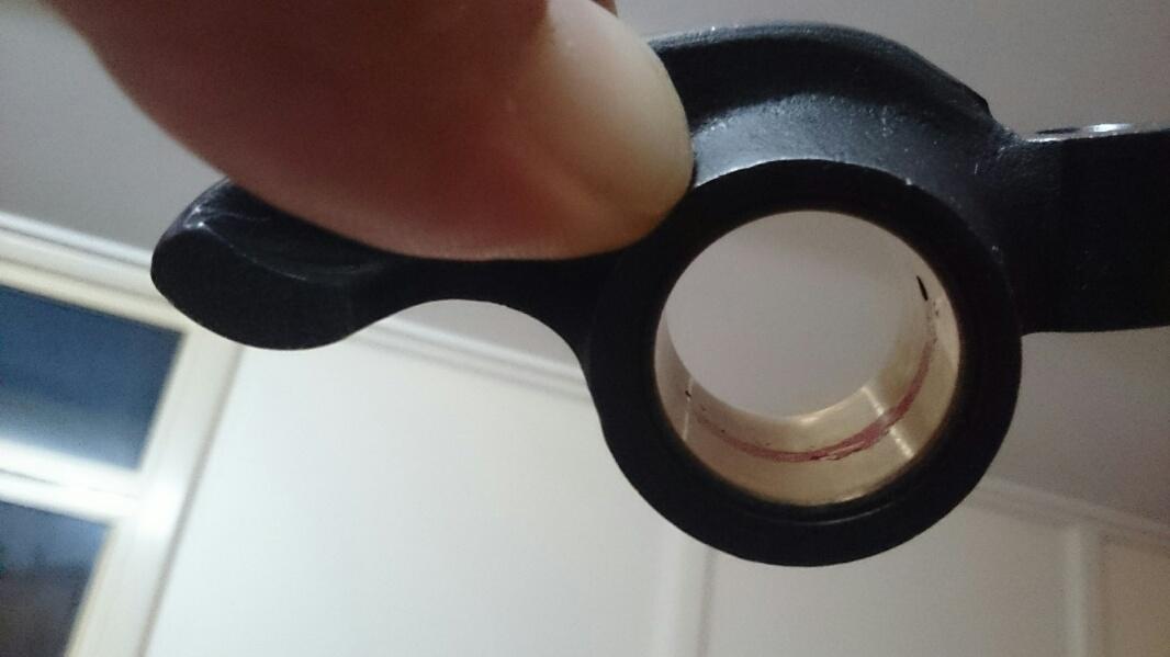

Yes, I have to agree with Mark. There's a lot that can be done to improve rocker oiling. I'd just taken my CB 1.3 rockers apart to work on them when I read this thread. I figured I'd throw in some pics....
This is where I plan on adding a groove. I'll add just one groove - from the oiling hole down to where all the force is. (It's hard to get a pen in there, even harder to get a photo!)
I'll post some more after I make the grooves.

Too much work to address a problem that doesn't exist? Many years ago people started adding grooves to the rocker shaft and I believe there are some being sold like this - but how many of you with real world experience have seen galling of the rockers on the shaft? There a couple of ideas for squirters such as drilling the pushrods if you are concerned there is a lack of oil at the valve side, but again it's not an area that shows lack of lubrication.

the nut has spoken!!! so how do these scat rockers have blue spots on the rockers that the oil holes dont line up with the grooved shaft?????yes there are oil grooves, but if the oil hole isant where the groove is it does no good. if you have groved shafts you just need to add a grove from the oil holes over to the shaft grove location on the rocker. when I grove my rockers like pictured hear I do it with a snake patern(S) or bannana (C)grove so it helps spread it across the load aera, not just inline groove. but any thing is better than nothing...unless your a squril. I for one have seen many with gaulded shafts.but none that I have reworked. have you ever seen a shaft mr squril?Im starten to wonder.
